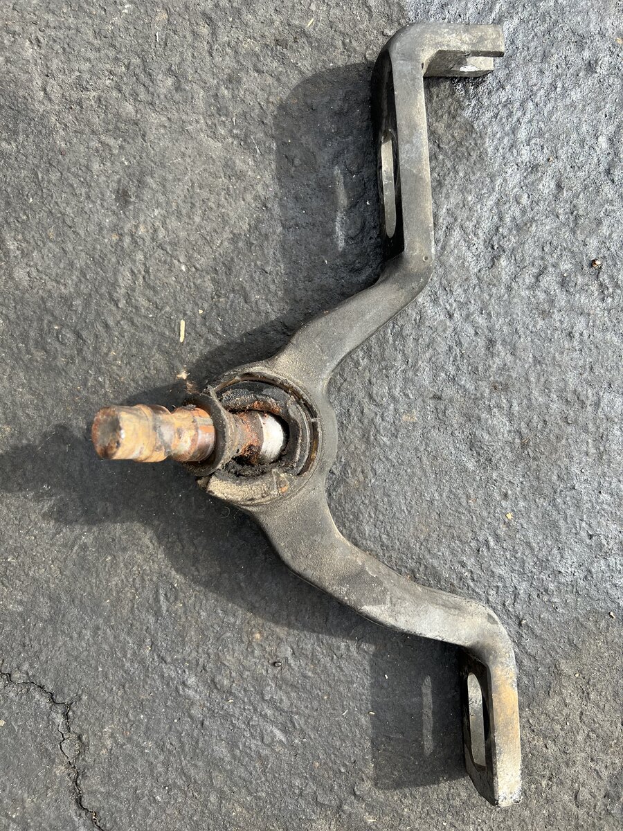

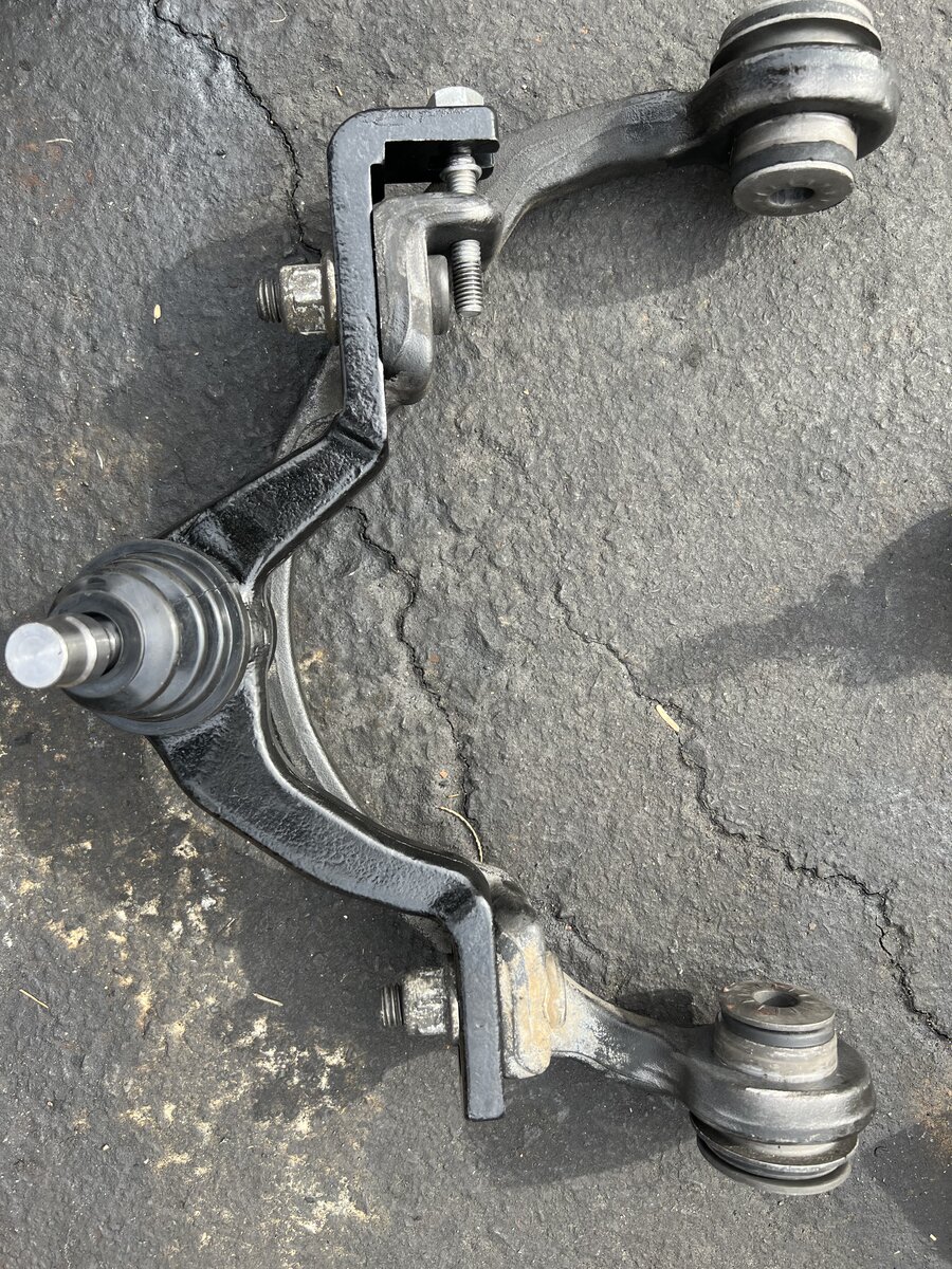

Got some more done today. No pics right now. I changed the passenger side ball joint and control arm bushings. Re sealed and installed the oil cooler assembly. New outer tie rods. Reinstalled the power steering hoses to the rack. Installed spark plugs, My buddy loomed all the plug wires together really nice. Those are on the plugs now, but waiting for the coils to go back on. Was going to put the motor back on the frame and found out that the left motor mount was actually a right side in a left box. So that stopped my progress. So I'm waiting till Monday on the left mount. I was going to reuse the original mounts but closer inspection revealed age cracking, so I decided to swap them out. But more goofy part problems are holding me up till Monday. Heck, we even had 4 used spark plugs in brand new Motorcraft boxes today too. What's a guy to do? Wait it out I guess. Hopefully the correct mount shows up Monday and maybe I can start this up again before Thanksgiving. That would be cool!
