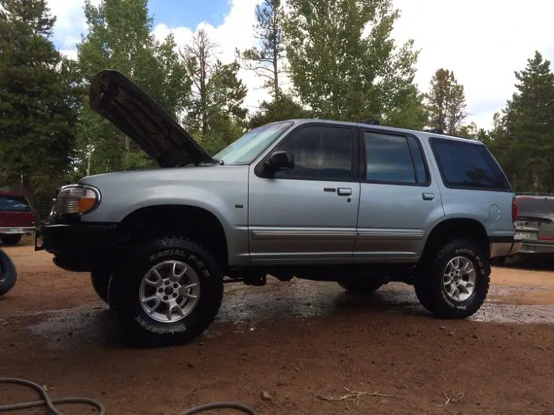

It took me like 10 years of searching but on my old 96 I had bought wrecked, eventually I found a 96 at a wrecker w same exact paint code so I bought the entire front clip. The nice part was the fenders and hood donor was a rwd, and my 4406 was 4wd not awd, so I lost the awd badges.
almost a perfect match
I had green mountaineer fenders for years and then eventually primer before I found good factory body parts
I miss that old 96

Here's one that just popped up in my parts....it's really a grey / silver though it appears ..... but even considering sun glare still a lighter grey than yours...if I find one here in So Cal we'll persuade some people heading up their/ Vegas to fritter money to bring it with them and meet you ... :)
Well S*%t... without the Vegas Sunburn that looks about right.

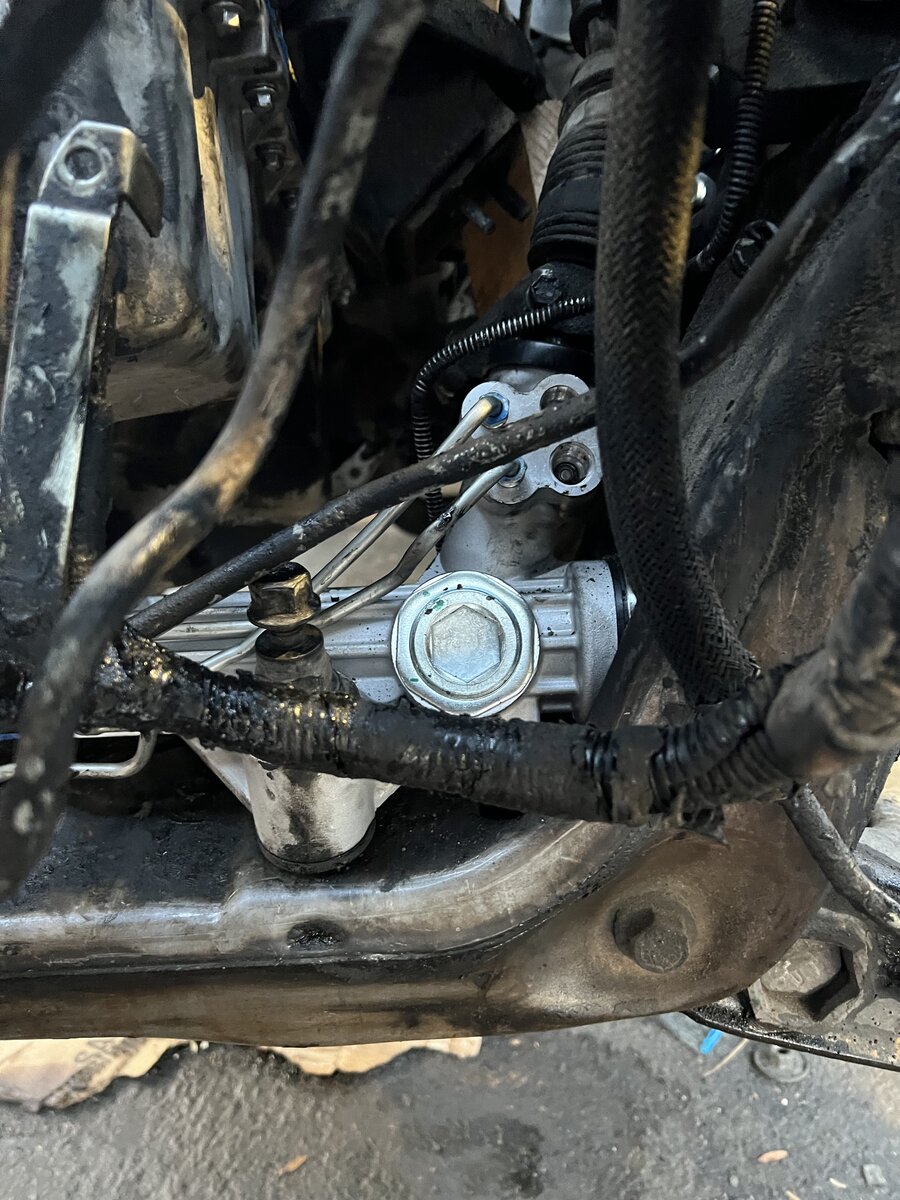

So to add to my insanity, i just decided that since I have the motor up in the air to just replace the rack and pinion while it is easy... Did somone say Showroom new??:rolleyes:

forgive me for blowing up here, but something is ringing in my head about saving a valve from your old rack unit to install into the new one.
Doesn't hurt to check I guess.
Yeah thanks, I've seen those on Fords before.

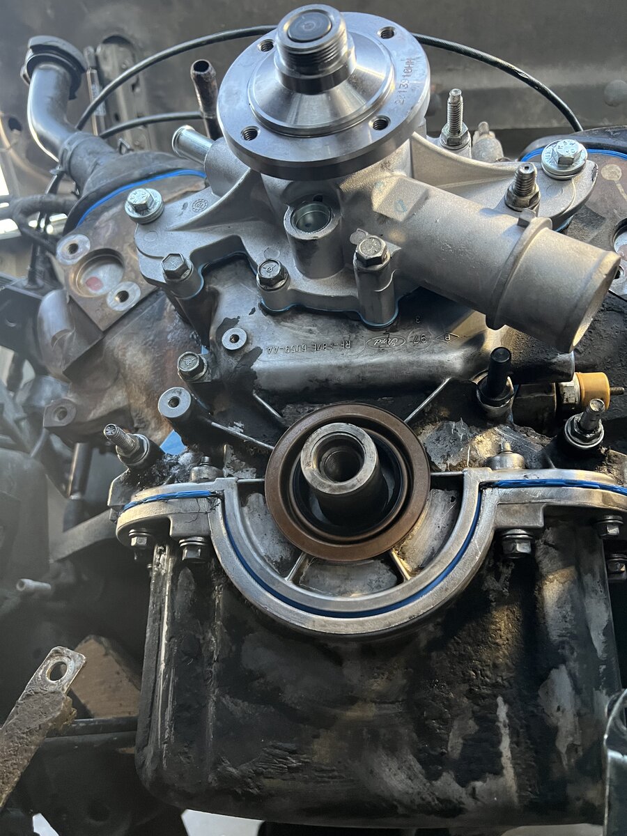

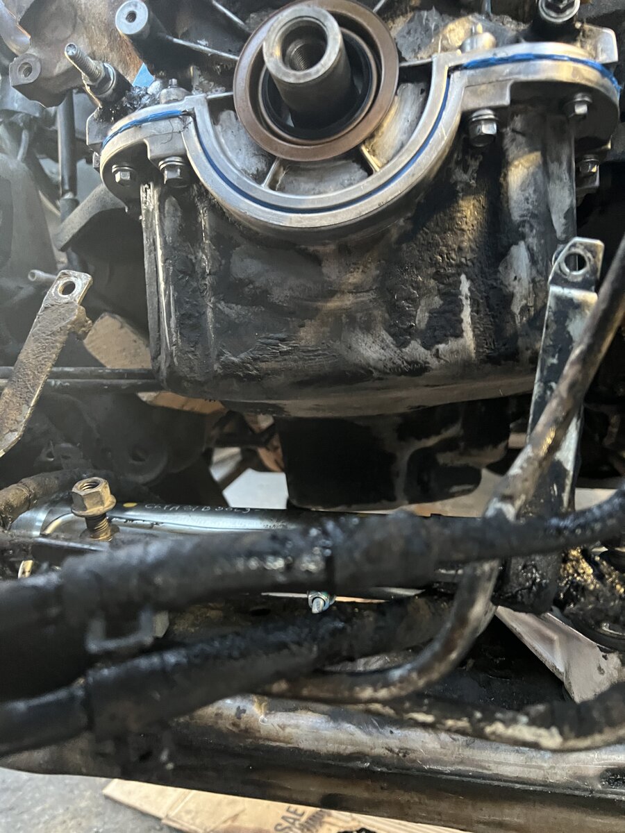

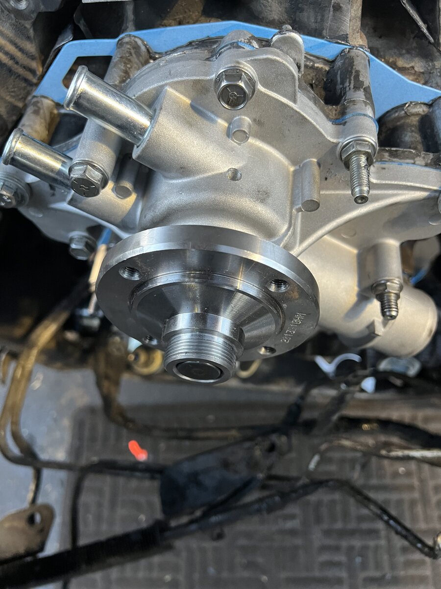

Got the Oil pump, oil pan and gasket, Timing set, timing cover, water pump, rack and pinion and left upper control arm installed today.

Now I'm trying to figure out the order of operations for all the little stuff. Thinking of all the things that are easier while the engine is up. Upper control arms? Spark plugs and wires. I bought motor mounts but the ones on there don't look bad. But I'll probably take them off for a close up look. Once the motor is back on the frame I can do the belt drive stuff, the AC and the plenum. Then its a runner again.
