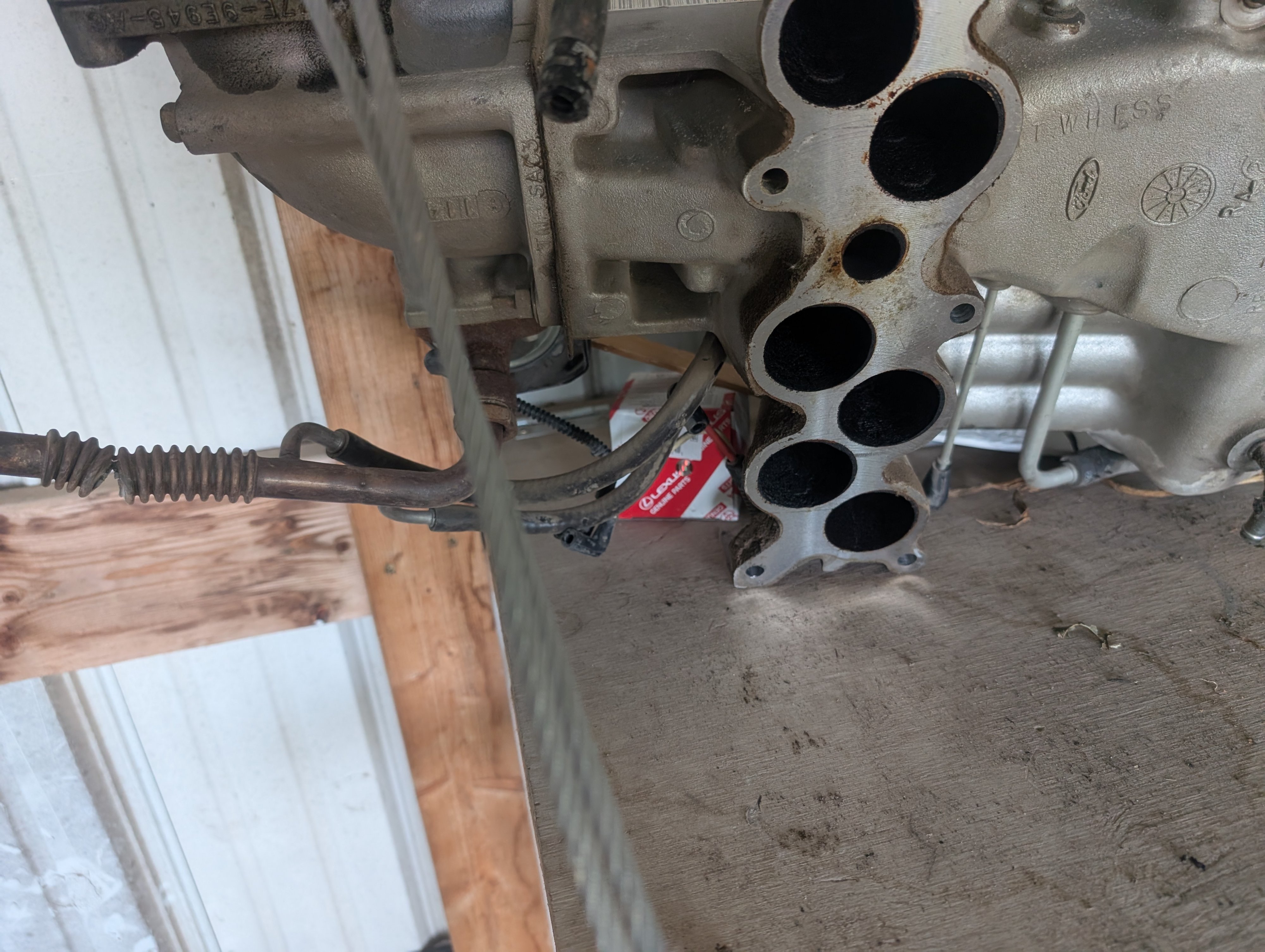

Best part about the seat belt is it can stay with the engine.. no need to unbolt a chain and keep adding chain each time you need to lift.
Each engine gets a wheel to sit on and a strap for moving Blamo. Only special engines get a $99 harbor freight engine stand. My wife picked up a 1000’ roll of purple seat belt material at a yard sale,
So that helps

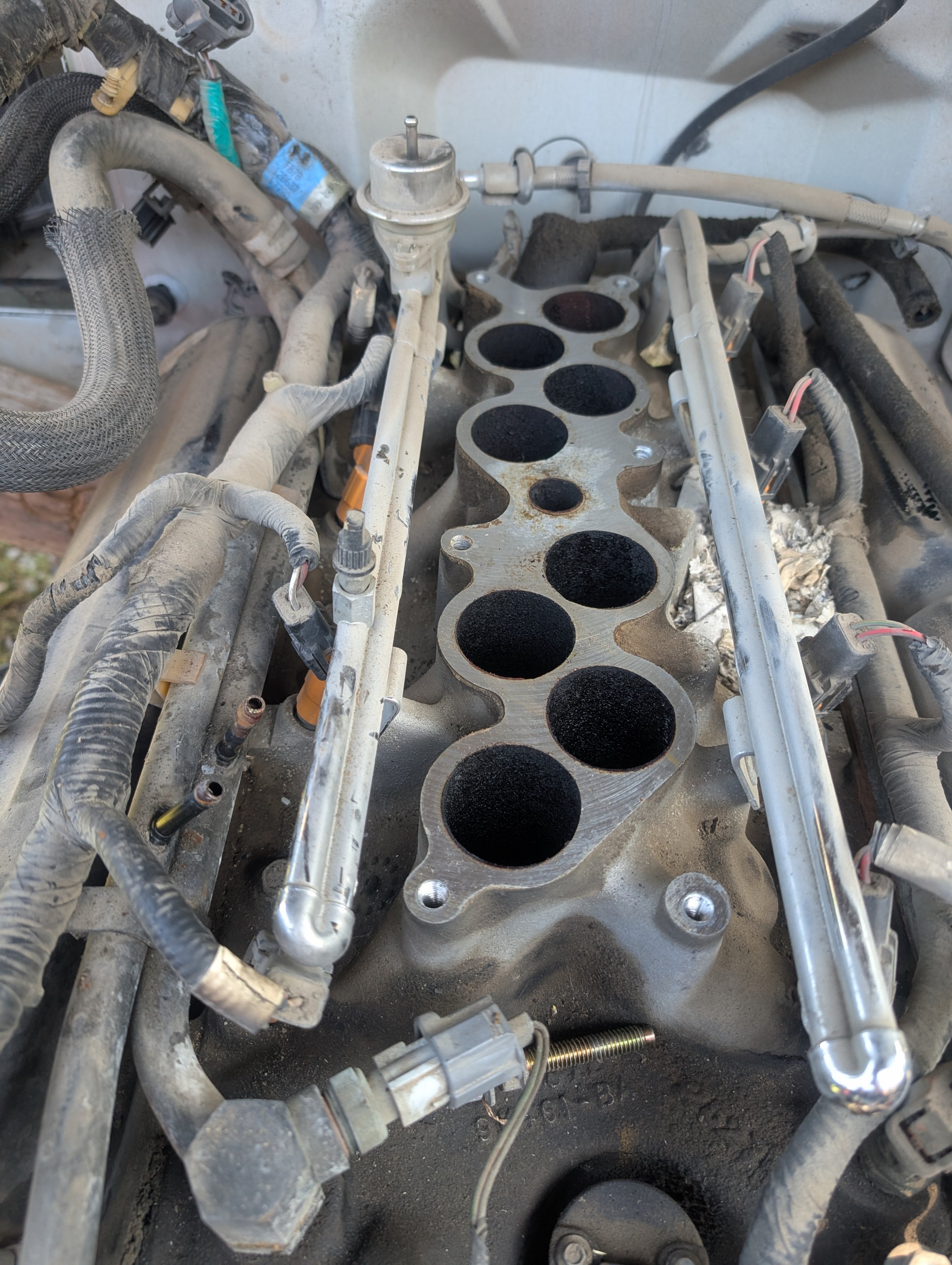

I'm slowly working my way down to this 5.0
Had a productive night last night! Got the evaporator box out and preemptively cut the passenger exhaust flange bolts because I figured they'd round off like they always do in the cast manifolds. But on the driver's side, where the frame blocks the bolts, I tried backing out the bolts and they turned just fine... that's a first! Maybe there's less galvanic corrosion between the welded-steel manifold and the steel bolt than there is between the cast iron manifold and steel bolt? Steel and iron are pretty close in galvanic potential, but that's my only guess as to why it was so much easier than every time I've done that in the past.
There's no market for these welded manifolds, right? This particular set is odd because they look like the early manifolds, but they fit P heads and have an EGR bung. They could probably be used in a Ranger V8 swap if someone wanted a fox 5.0 in a 4x4, but the cast manifolds would surely be better.
I also broke all the header flange-to-head bolts free and didn't snap any. Woohoo! Seems like this engine is excited to vacate the rusty Mountaineer and climb into the Sport and meet it's new manual partner.
