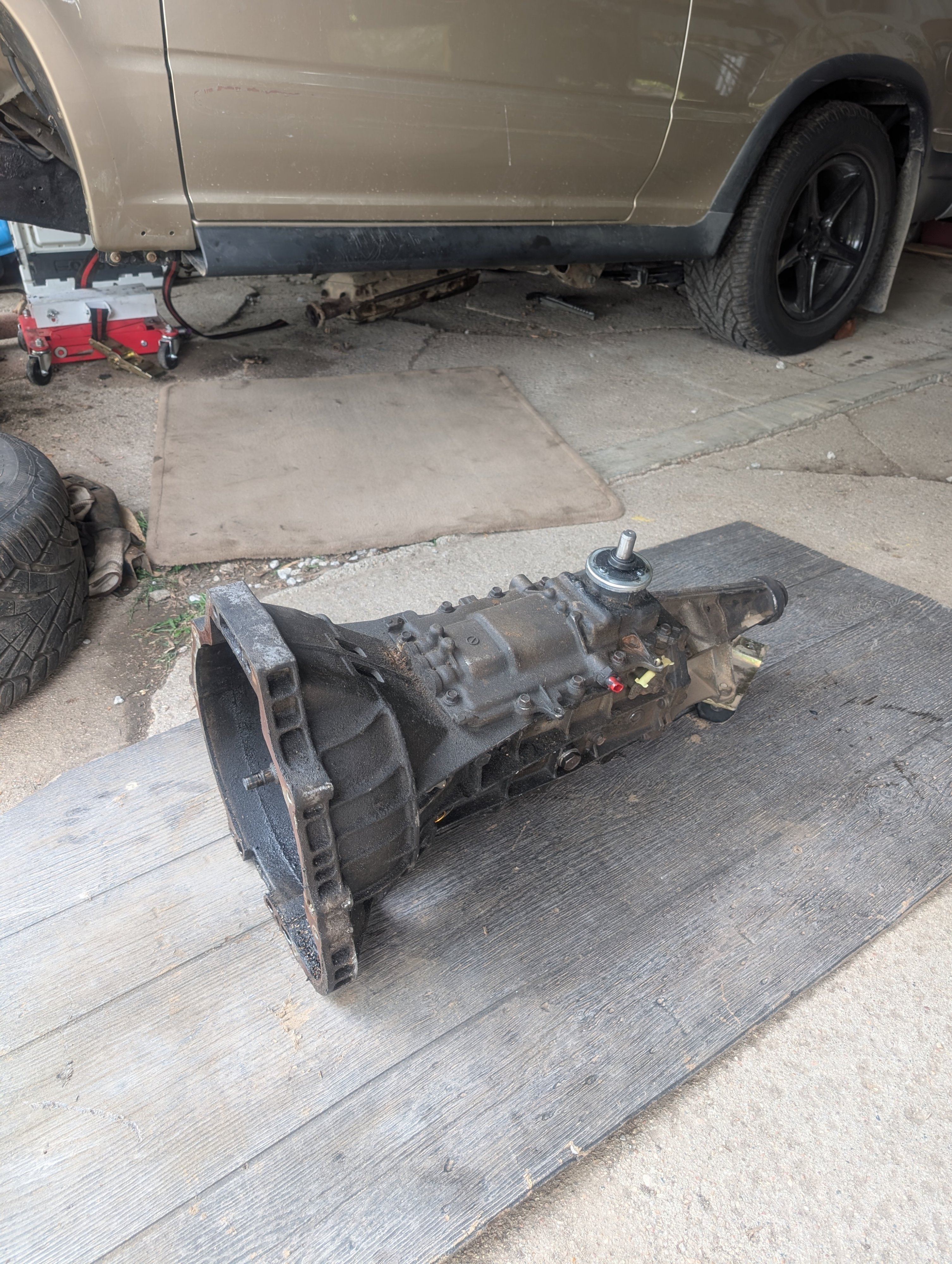

I almost have the M5R1 out. It's on the transmission jack and the bell housing is separated from the block plate and dowels. But it almost feels like the input shaft is hung up on something. Not sure if I need more wiggle, more force, or if something I can't see is interfering.
M5R1 is out!
The input shaft was binding in the clutch because the engine was tipping back. I never had that issue with my Mounty, but I also had it pretty level when I pulled the trans. Right now the Sport is Carolina squatting (just lifted on jack stands in the front) because my other two jack stands and my ramps are under the Mounty. Once I jacked up the back of the 4.0, the transmission literally backed itself out.

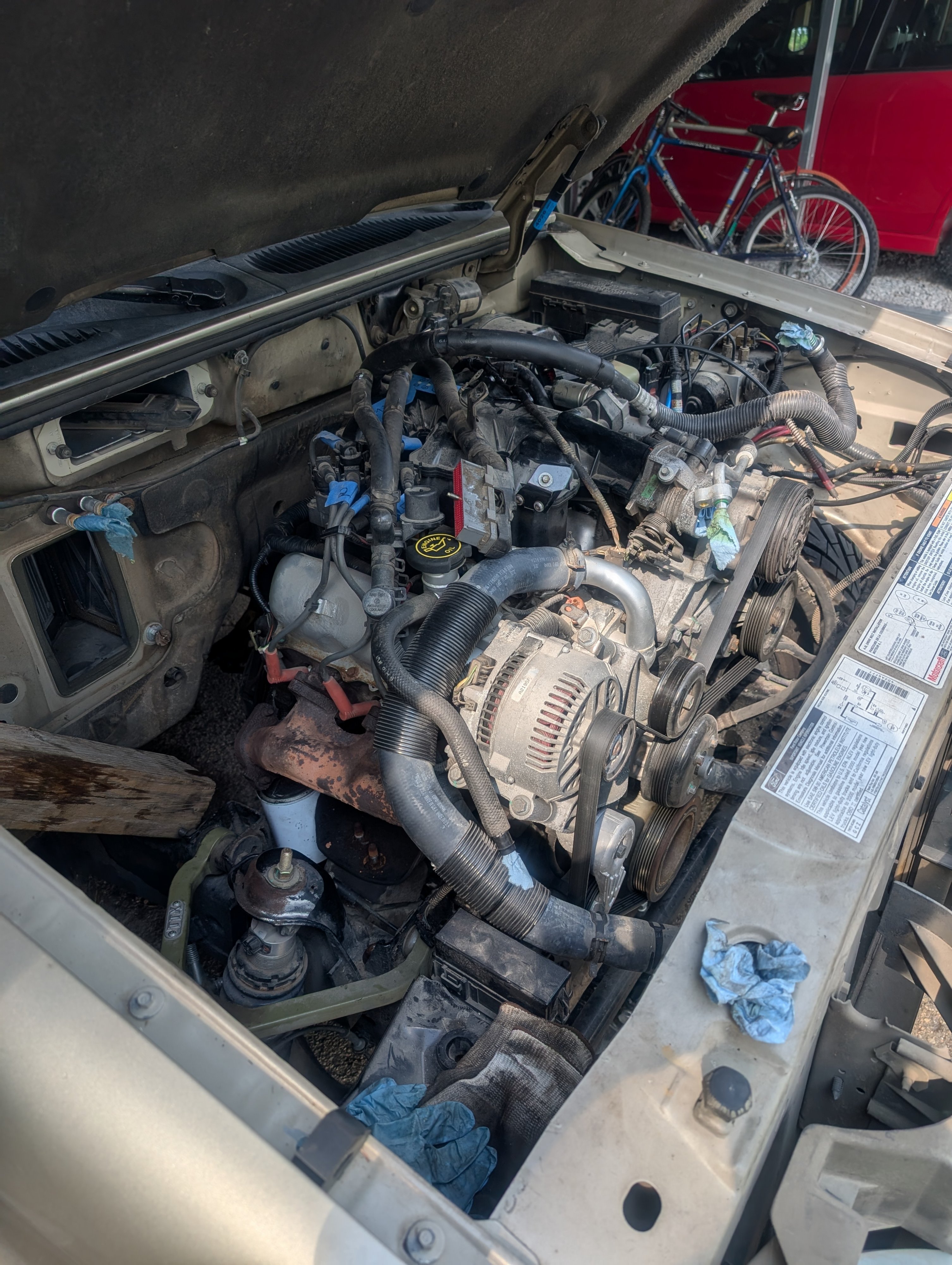

The only things attached to the engine now are the mounts. My plan is to get the wheels back on and drop the whole truck back to the ground then lift the OHV out the top. Where do you guys recommend attaching the lift chain(s)? Also, what size chain is appropriate? I'll pick up a few feet tomorrow.

Chain needs to be large enough for accessory or intake bolt to fit through
I actually use seatbelt strap material and just tie knots over the exhaust manifolds… stuff works amazing and it’s free at junk yards.
Yeah, I actually have a whole rebuild kit (seals, bearings, synchro rings), a shim kit, and a new input shaft for this M5R1. If anyone wants it, I'll let the whole bundle go for less than the rebuild kit costs. If you ask nice, I may even include the ES poly trans mount.

I can put the right exhaust manifold back on for another lift point. Only four of the bolts/studs made it out in one piece, but 4/6 still seems sufficient to me.
Is a load leveler necessary? I wish I'd bought one at harbor freight when I was in the city yesterday. I don't think I'll be back there till next week.

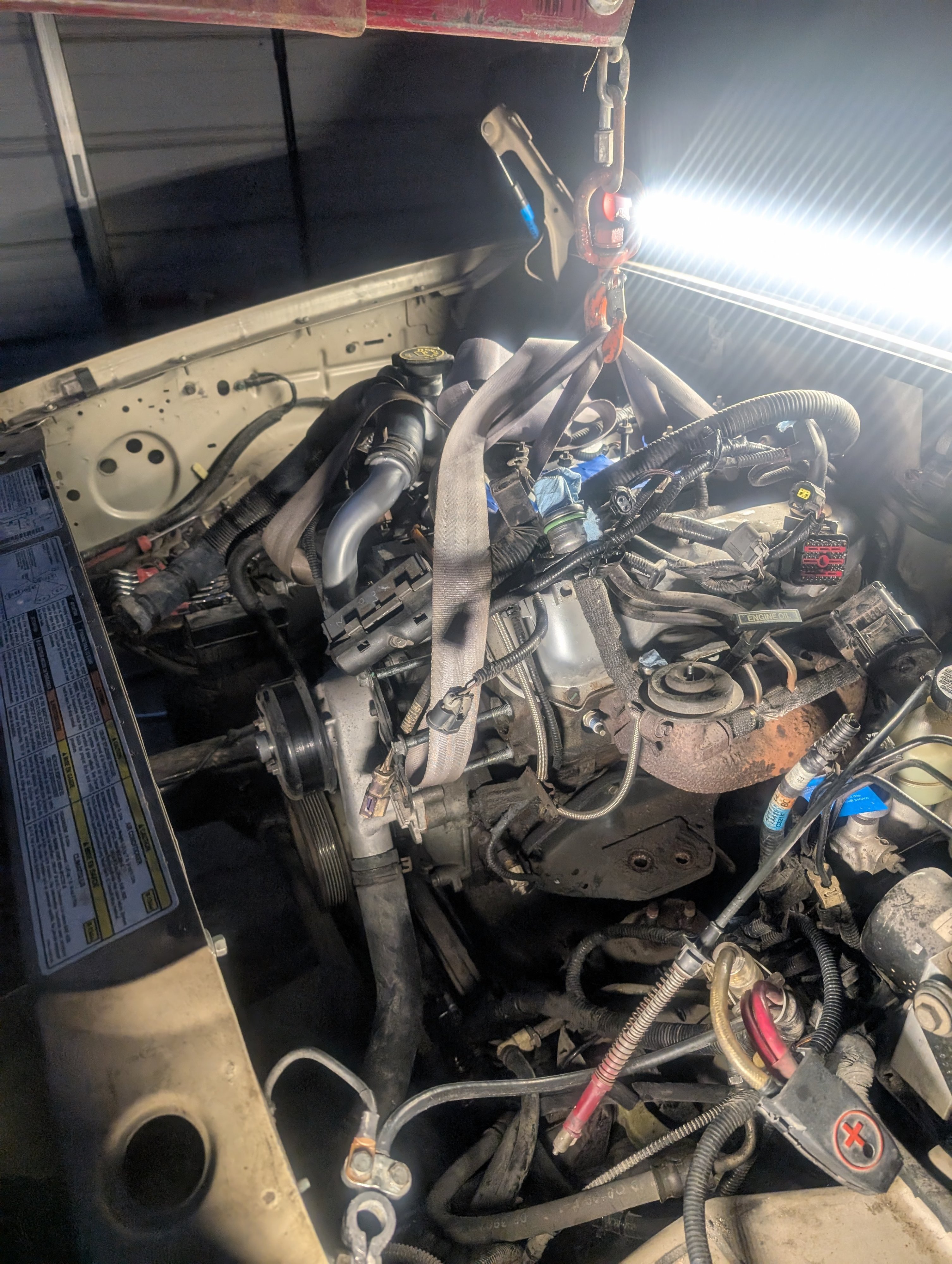

Mount plates are unbolted and I am itching to yank this 4.0
I was hoping to disassemble as little of this engine as possible, but I'm afraid I may crunch things like the upper intake, DPFE, ignition coil, etc. if I run straps over top and start hoisting. Do y'all recommend stripping off everything above the lower intake before pulling the engine? The AC compressor sits pretty high too, not sure if that should come off now.

I did some tape measuring a bit ago and I think intake off is going to be the only way to clear the gap between the hood and core support anyway.
Time to pull some accessories then. And I'll try to find an excuse to get to Harbor Freight in Lincoln this week.
I've been thinking that more and more...just don't want to have to put it back on lol

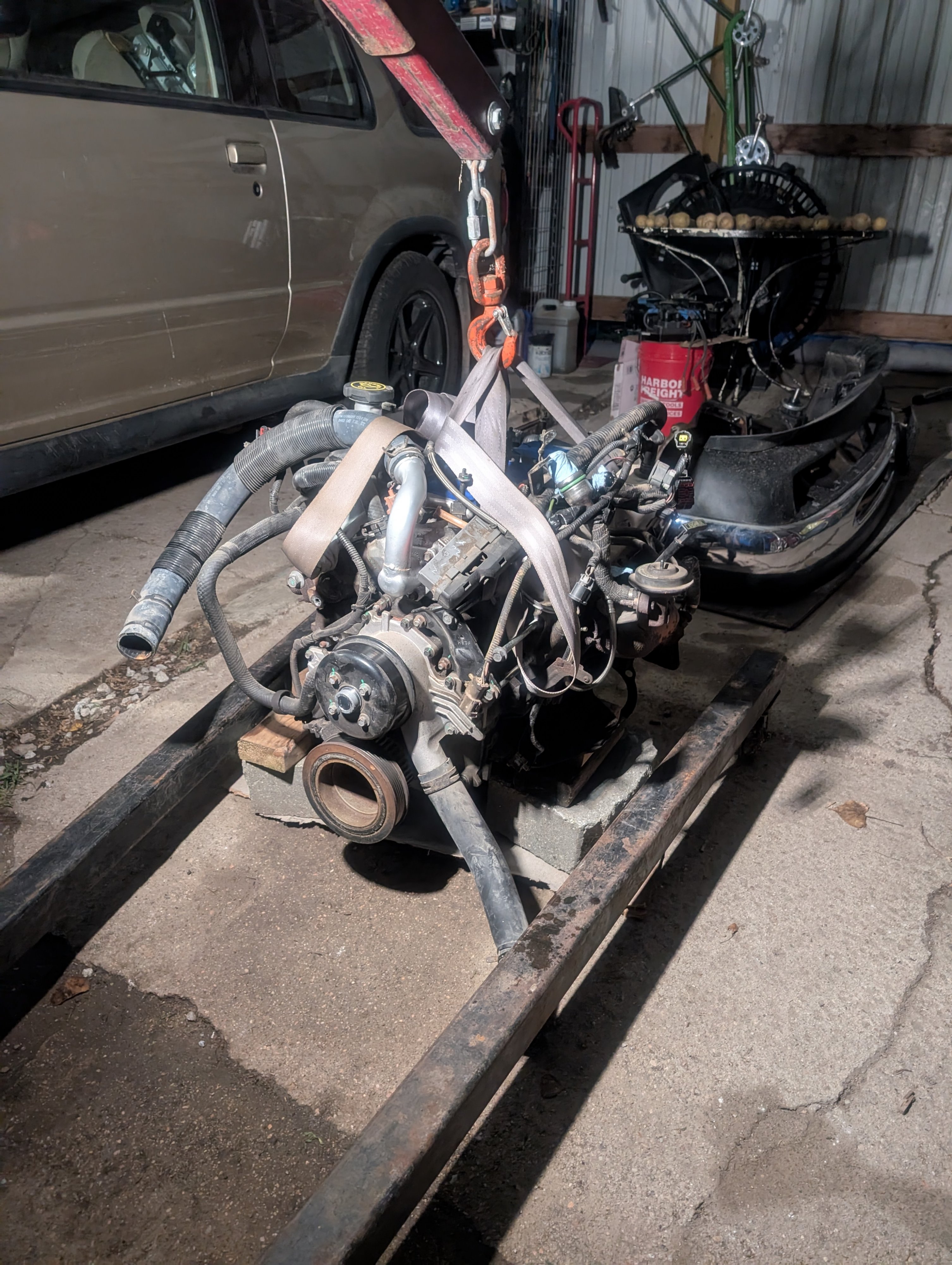

Here we go...
No longer four-liter equipped.
Anyone need an OHV core?
This thing is still loaded with new parts just needs, well, the engine.

Love the seat belt strap! They are fantastic engine pulling equipment!
