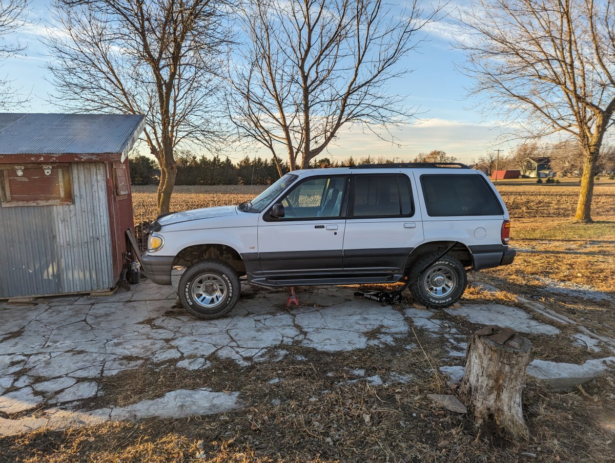

Things are slowing down a bit here, winter finally seems here to stay and our new baby came Monday evening. She and mom are happy and healthy.
While they sleep in, I'm taking over daily chicken duties which means I'm spending more time around the Mounty in daylight than usual.
I've gotten so used to seeing it on jack stands, I think I'm going to want to lift it once it's running and manual swapped. Probably just F150 leaves and TT for an inch or two.
Looking forward to lots of farm truck fun with this thing!
Congrats on the new baby!
I like how Ford / Mercury went with what's referred to many as storm trooper look, white with dark grey /black trim / cladding. I have that with my WJ ...great look for a white vehicle imo....first time I've seen it on second gen, I guess it was only available on the Mercury version / Mountaineer.
