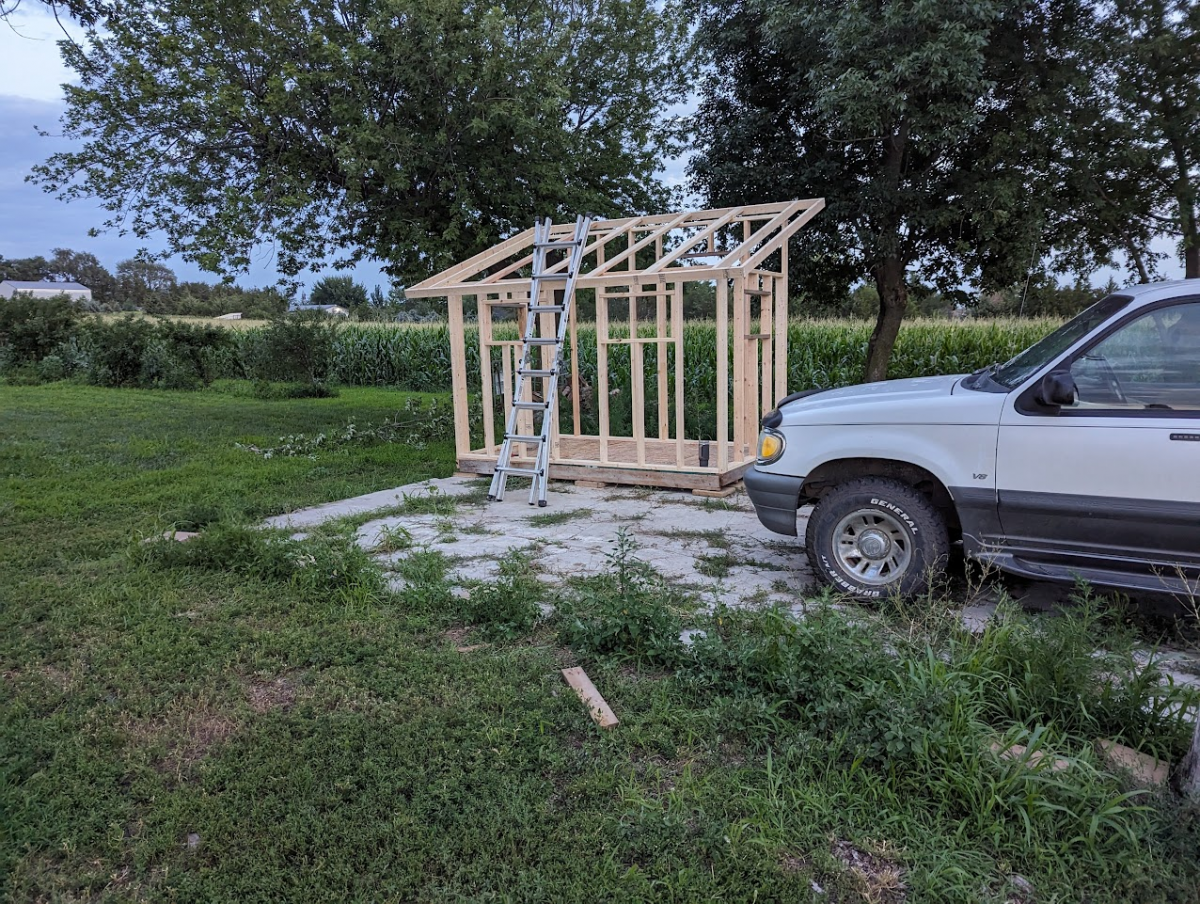

After more progress dismantling the barn this weekend, I came to the realization the studs were too deteriorated to use effectively in the coop. I broke down and bought a bunch of new 2x4s, at least it was a pleasant reminder of how fast you can work with new materials (not trimming off rot, pulling nails, etc.). Framing is pretty much done!

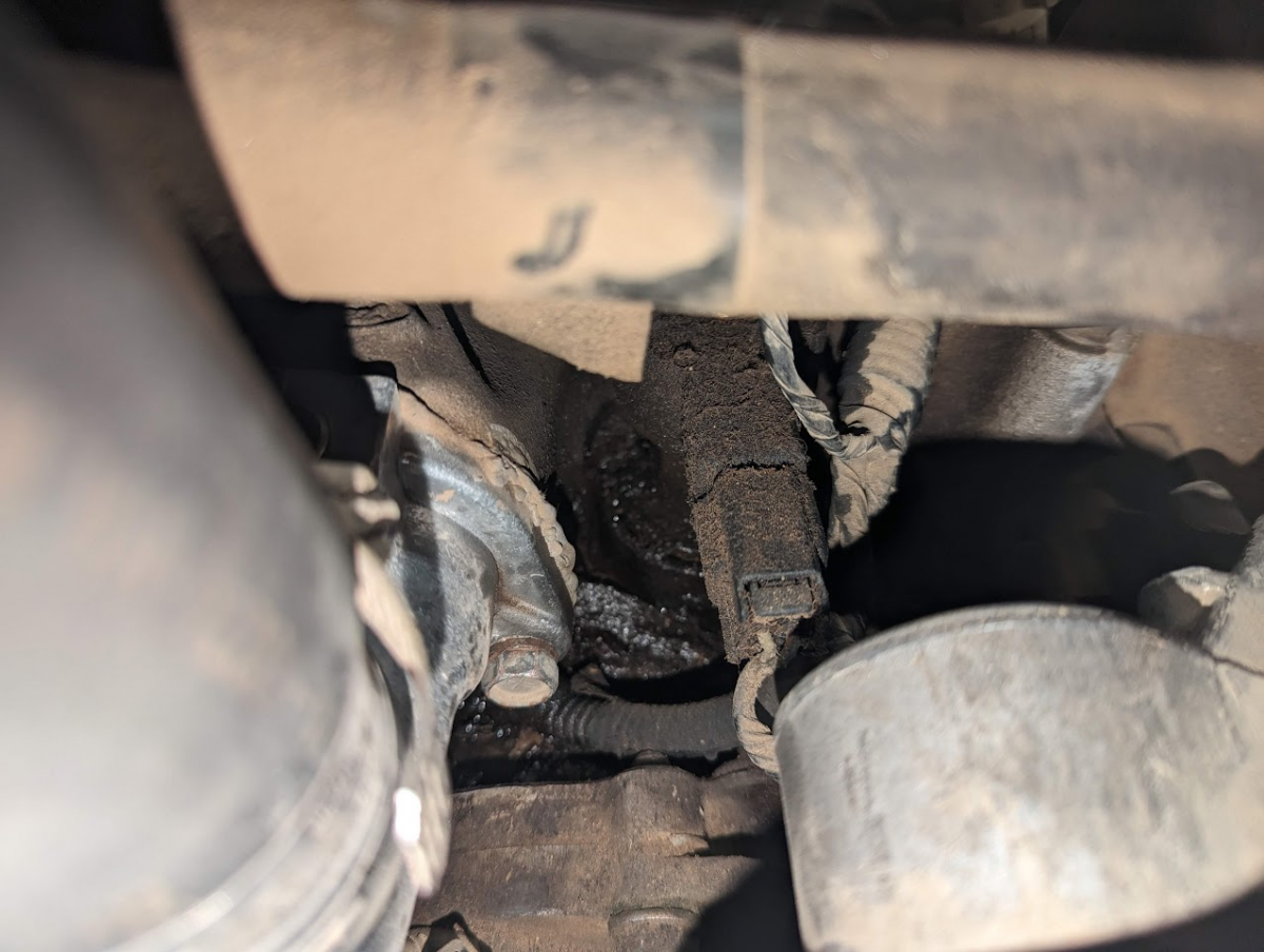

2. At least one oil leak source appears to be the cam synchronizer. Do y'all recommend replacing the whole thing at this mileage (190k)?

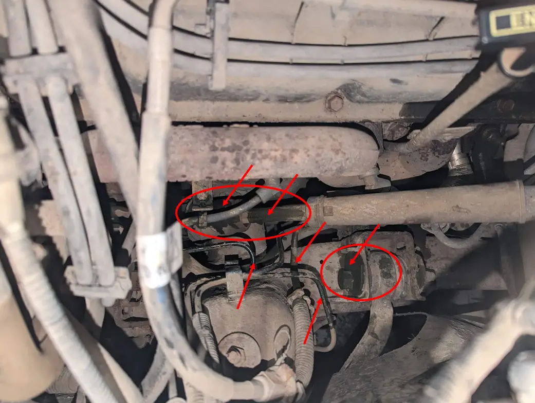

3. The coolant leak seems to be running down the left side and is getting sprayed back onto the steering shaft and left UCA:
I can see where it's pooling to the left of the cam synchro and behind the PS pump bracket:
Interestingly enough, there isn't any noticeable coolant drip under the thermostat housing or aroundthe water pump. Does this indicate a leak via lower intake manifold gasket?
There is also the heater water jacket in that area that can leak coolant… usually though it is the thermo housing or the little bypass hose
I have never ever seen a cam synchronizer leak oil not once! Valve cover gaskets?
I would for sure plan to re seal the entire engine when it’s out timing cover lower intake and rear main are the big leakers
The oil pressure sensor and dipstick usually seep some oil

I agree on the CPS leaking oil. The gear should be wet, but the well it sits in should be clear of oil. They have an o ring, but I assume that’s for vacuum, and to keep stuff out.
I’d also suspect the valve covers, and it’s just pooling in a low area.
I'll have to look closer, maybe it is the bypass hose (which I already have a new replacement hose for).

Surprisingly there isn't really any oily buildup on the lower intake manifold or heads, but I will definitely be replacing the valve cover gaskets. Maybe it's just leaking at one or both of the front two areas where the head and lower intake come together under each valve cover? I'll have to look closely when I start taking parts off
