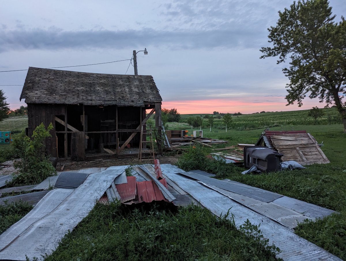

Slowly but surely picking the old barn apart for chicken coop materials...
It's getting sketchy to keep working on the barn so once I get the rest of the good sheet metal off, I'll put the farm rig Mounty to work and yank the barn down. It'll be safer to pick apart the wood when it's not up in the air.
