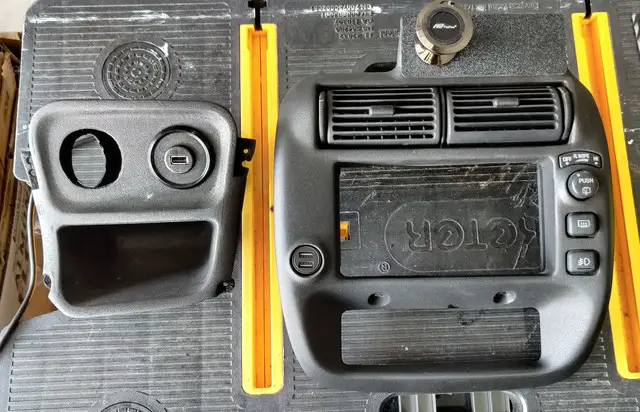

I also ordered up a fairly inexpensive double din stereo for it from Crutchfield (like $250ish) to replace the old hardly working Walmart radio that was in there, plus began work on the radio bezel... cut out some PVC plastic to glue over the old Sat radio piece that sticks out the top that had some sat radio interface unit socketed into it and will have a phone magnet mount time thing mounted there and also installed one of those nice recessed double usb charger port sockets into the cig lighter port. For the bottom cubby and dual gauge spot that had the AF and boost gauges I put a nice gauge hole plastic cover piece that snaps into place to fill an empty gauge hole and will drill the center out and install a USB extension plug that will run from the back of the new radio and mount in that spot, and will order a replacement AEM AF gauge for the left hole so I can still monitor the AF and hook to the SCT v3 if I ever can get car retuned :D

Added some pvc plastic and filled the old sat radio controller slot and then added like a faceplate over it. Added a phone magnet mount (not pictured) to it so can snap a phone to it for hands free whatever, lol. Also added a dual USB plug into the cig lighter port :D Got in new radio today as well, haven't had a chance to install it yet or test fit.
Very nice. I need to put you in charge of some interior refinishing items for me.

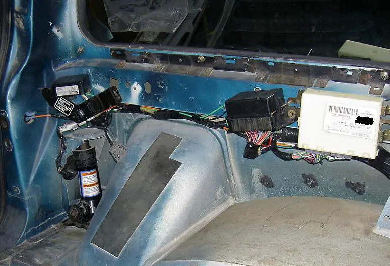

I should have thought of a picture before. This is my 99 in the left quarter panel area. The grommet you want is there just behind the jack, you can run wires through that.
Ok, a little progress... I added some flex loom type cover on the tip wire bundle coming from the hatch into the headliner area, and also re-did the wires at the bottom and ran them through the tire jack area into behind the tail light which worked great, thank you! :D Much cleaner.
