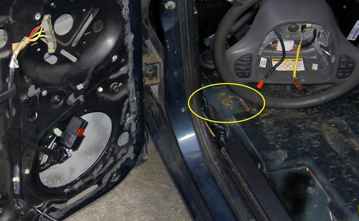

They do go to the floor very close to the "B" pillar trim, near the back of that trim. I'm guessing you are looking for the thread insert in the floor for each front belt along the side.
Here's two pictures that may help. To find them I'd go under the truck and locate each, and push an awl or thin screw driver up through them and the rug. What is circled in yellow below is the thread insert I think you want, that's just behind the driver's seat.

Yeah, that helps a little. What I'm looking for is what is around the seat belt for the front seats where the belt bolts to the floor by the edge of the car. I have my belt in place but can't remember if some kind of plastic piece snaps over it? lol.

Yeah, there is no cover over the end of the seat belt at the floor. I store a small 12v Milwaukee battery next to my right belt, there, for my air pump.
