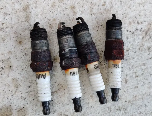

Got the driver side plugs swapped out and pulled all of the old spark plug wires and heat socks.. The old plugs are pretty nasty, lol...

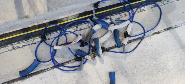

And the old wires and socks...

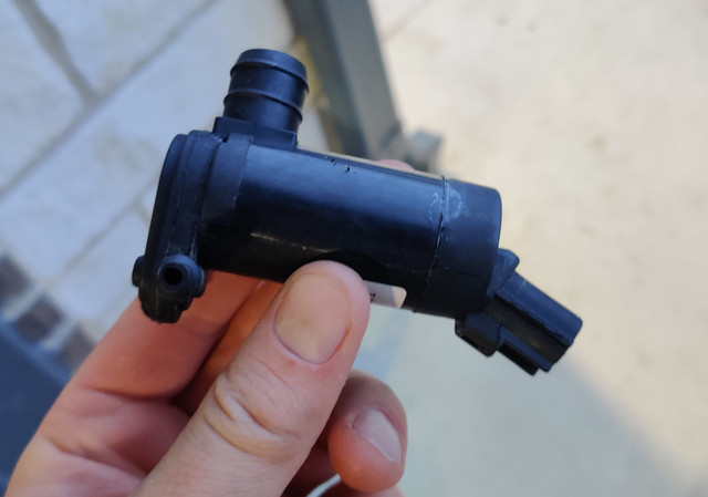

Also while in there I took a look at the windshield washer fluid reservoir leak.. looks like the pump itself is leaking around the seam near the bottom somehow.. Ordered a replacement...

Swapped out the wiper reservoir pump and also knocked out the oil change. Not much time as it's been storming a ton lately, blah.. lol.

More storms and rain.. sheesh, lol. Hope to drain brake fluid and cycle it all out with some fresh fluid sometime soon, as weather permits! New wiper washer pump seems to be leak free, so.. that's nice :D Still need to find where to order some new manifold cover plate bolts so I can bolt on my pretty blue 5.0 plate but that's kind of a low priority issue, lol.
