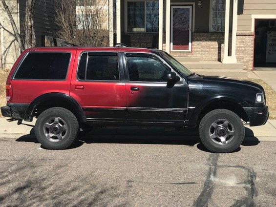

I was able to spend a bit more time on her, got the pieces welded on and a quick repaint, but it still needs bondo. I got an idea for a couple of stripes that should look good and help blend Ranger to Explorer body lines.

I just held the flairs where I wanted them, marked a few holes for the fender clips, drilled them, installed the fender with enough clips to hold it in place, then marked the rest of the holes and used a scribe, dragging it along the fender to mark what needed to be cut-off for better fitment. I was able to use a utility knife to trim them to fit. They don't fit perfect so I used a little black caulking.
Hear ya go, the best it looks so far, still need to do the passenger side and light bondo where I welded on the Explorer fenders to the back edge of the Ranger fenders. It won't be perfect like any show truck, but good enough for my purposes.......................
First pic is the drivers side, compare it to the passenger side with fender gap fixed, stripe to tie-in upper body/fender line, and I moved the side molding trim up to tie-in the different lower body lines:

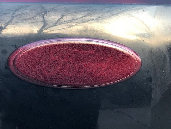

I also painted-up a couple of "Ford" emblems to put over the holes in the fenders from the old Ranger emblem:

Lookin way better man, I'm feeling it now. Considered an 04+ conversion at all to gain the bigger grill? I'm sure you have enough skills to make it work with the power dome hood. I'm about to do the swap to mine.
Props on the body line / stripe deal, way to tie it in without spending hours of sheet metal fab.
Thanks man! It looks pretty good from a distance and that's good enough for me.
