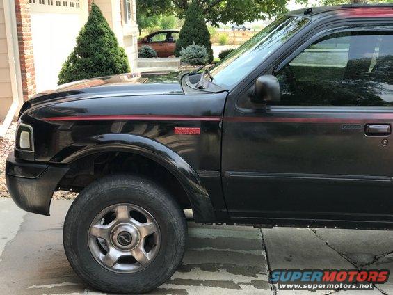

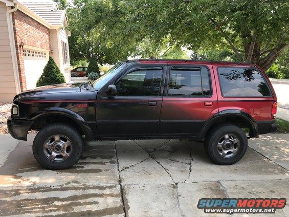

im curious, will this hood work on stock explorer fenders? The contour and fitment? (disregarding headlight and grill assembly)
The curve of the hood is different than the fender, though someone posted a pic of a dome hood on a Sport Trac within this thread.
The ranger hood is not a bolt on to a sport trac or any explorer, it has to be completely modified.
I was hoping to swap out the headlights and grill assembly from a Ranger, including hood (if the curvature was the same...and possible ends of the fenders for turn signal lamps. I was hoping to cut the front section of the fenders and graft them to explorer fenders (i have done this to many classic car customs using) - like they did with the cars from the 50's swapping headlights and taillights.

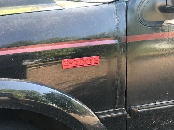

My son says it's an X-Edge and printed these for me.
That looks awesome.
The rig is got a little body work, good enough fo me, I spread a little mud over my stitch welds on the fenders:

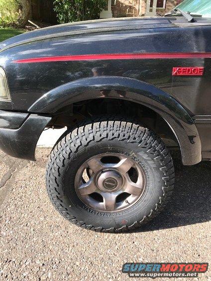

She is getting new shoes today! 265/75 16 Falken Wildpeak under $600 installed with road hazard and balancing. I was going to go with Good Year Duratracs but found these for much less.
Old Tars:
New Tars:

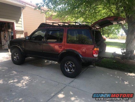

The rack is actually 4 hitch mount racks. I extended the rack forward with junkyard rails/slides and the vinyl pieces that protect the roof There is two bolts in each rack down into the slides and I rivitted tie-downs to the roof. It is very secure. It's easier to handle 4 small racks when installing/uninstalling.
Everything fits in the rack. My bed is made when I leave the house, so we can get anywhere and sleep then set-up camp the next day. The ice chest, food box and cloths go in the front seats when we sleep. I take the racks off on longer camp trips and bolt them together to make a free standing shelf to hold camp boxes and gear. We glamp when we have the time. We take, a grill, gas fire, stove, table, chairs, easy-up, sunshower, etc. etc.........................
Last summer:
Camp Shelves
Ha, the printed "X Edge" and Lightning Bolt cover the old holes where the ranger emblem was.
