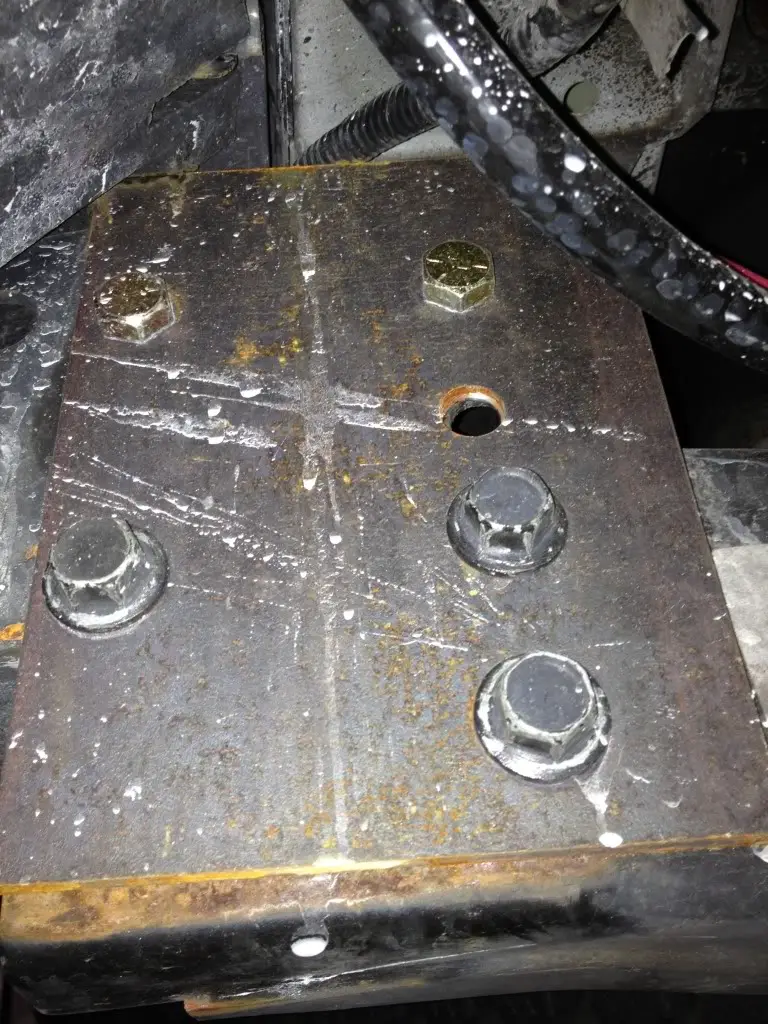

hey brian, can you post up pictures of the brackets?
Here they are:
Credit to James (Ronin8002) for walking me through it...
1/4 inch steel plate, 3 stock bumper bolts on the bottom, 2 grade 10 bolts and nuts from Fastenal on top.
You can't use the third bottom hole because the frame rail is in the way. If I had measured up 3 1/2 inches instead of 3 I probably could have made it work....

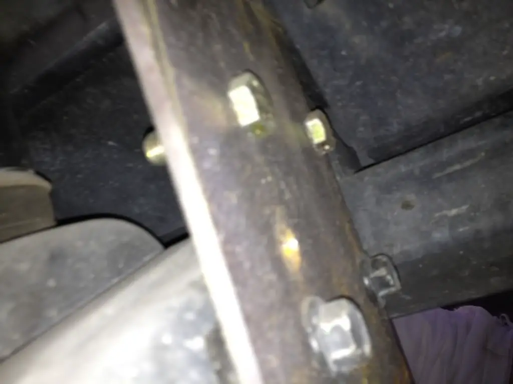

From the other side you can see the stock bolt on the bottom and the Fastenal bolt and nut on the top..
See here where the frame rail gets in the way of the third hole:
I just snapped these really quick in my driveway with my phone. If you guys want I can take better ones this weekend... Let me know if you have any questions. Oh and I plan on hitting the steel plate with some black rustoleum to try and keep it from rusting...
