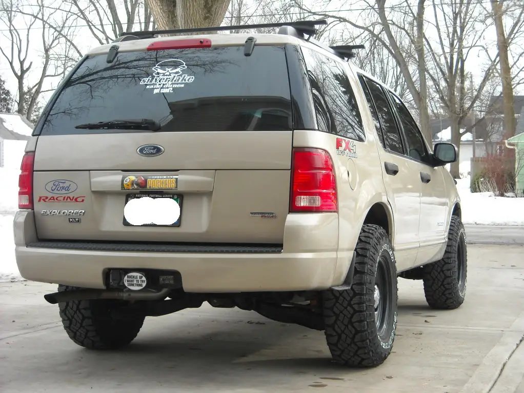

awesome pics millertime! although i think your 4x4 will throw a fit if you try to put that tiny spare on.
Epic shot's mate!!!! EPIC!!!
Nice pics MT! I like the poser shot on the stump!
