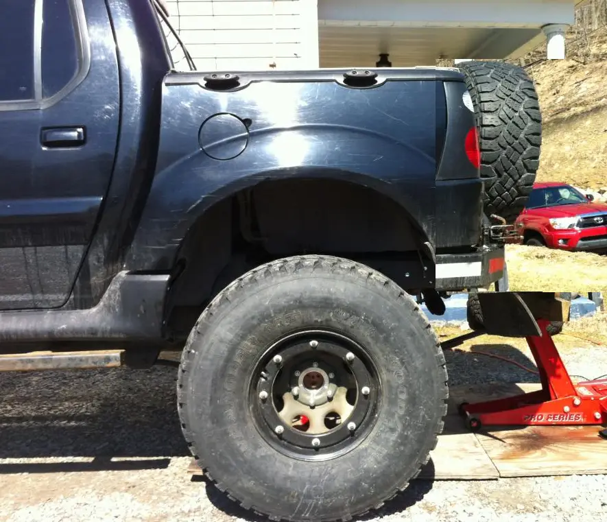

Ok, since I can't physically work on my truck right now due to injury and the -20 degree windchills outside I've been going through the list of mods that I want to do and have planned for years now. One of them is to get rid of the huge overhang from the back of the bed by bobbing the bed. This has never been done before and will be extremely difficult since the bed is composite and fiberglass with metal inserts so I can't just cut and weld like on any other truck bed.
Thanks to toypaseo for photoshopping what it would look like bobbed, I really like the extreme departure angle it has now. If anyone else knows how to photoshop and would like to do their own version you can use my truck picture as a template on this thread here and ad to it.
Can someone bob the bed of my Sport Trac please?
Here's the pictures he photoshopped.

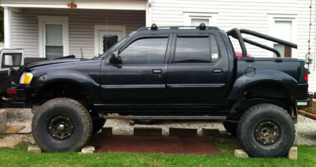

Got the cross member cut back 2" to move the front shackle cross member forward to where it needed to be. Lined everything up after measuring about 20 times to make sure before welding it into place. Now the rear shackles sit at 75 degrees back under full weight. Sitting on it's on weight now at ride height. Pictures are being uploaded to PB to post here now.
