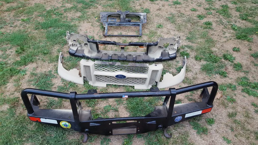

Well sorry guys and gals, no progress on the rig yet, been extremely busy with work and don't have the spare cash right now for the needed parts to finish it. My wife starts back to work when school starts so I'll have some funds then. I've ben slowly taking parts off to sale. Just removed the radiator to sale to a local ST guy that has a cracked rad. The drivetrain will be coming out soon if I can get weekend off from work.

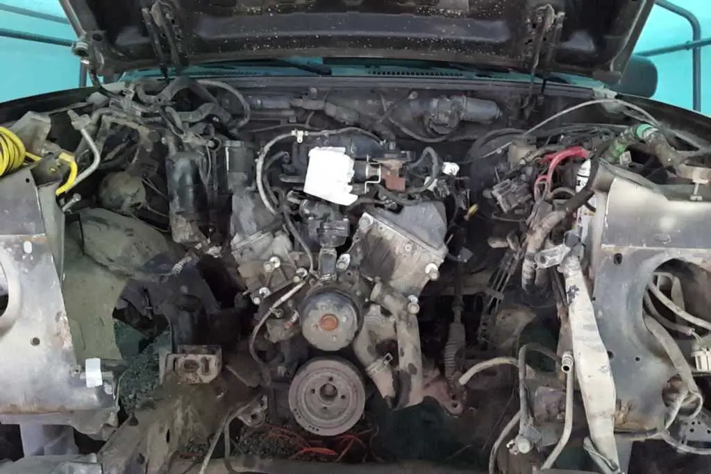

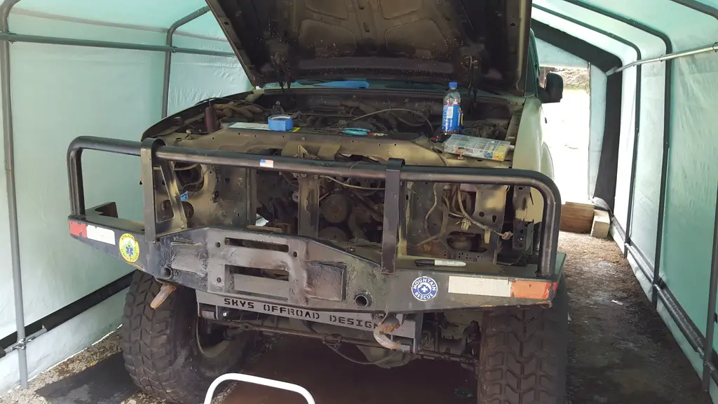

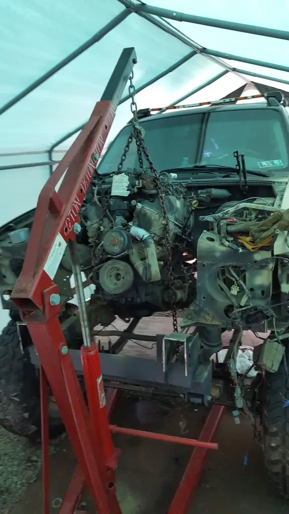

Late night wrenching, I miss doing this. Gotta get as much done as I can on my day off of work. I finally made some progress today on getting the truck ready to yank out the V6 drive train and swap in the 351w e.f.i, C6, 1356 manual t-case from my F-250 donor truck. Here's some pictures...
looking good! gonna be sweet when you are done
Hey everyone just a heads up Jerry, me and my son will be pulling his drive train out tomorrow. so there will be a little more progress for him. plus i am buying his drive train for my turbo build.

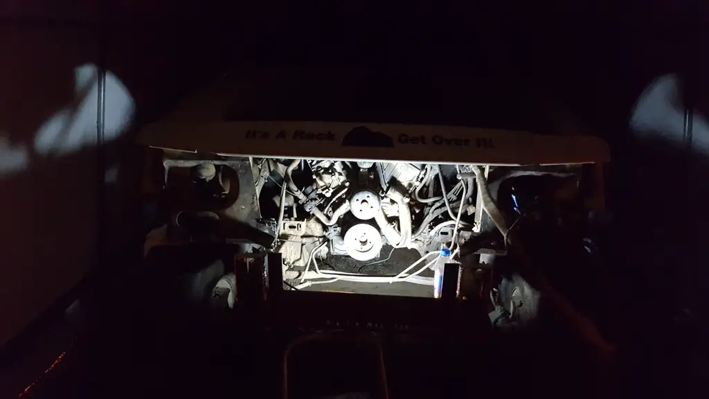

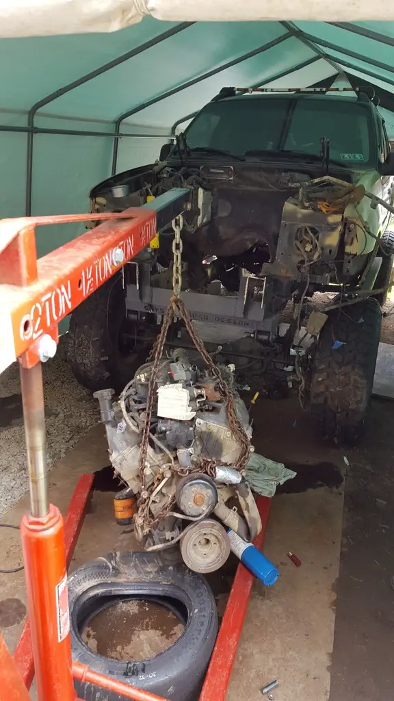

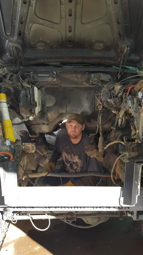

And it's gutted. One step closer to having the 351w, C6 and manual t-case. My buddy Valas Homan will have a motor and trans for his turbo build. I'll upload pictures as soon as I can get enough time.
May have already been discussed but what's the fuel delivery of that 351?
Electric fuel pump to the e.f.i. intake. It's from a 1989 F-250 so it's fuel injected but no need for emissions crap, all that stuff will be removed.

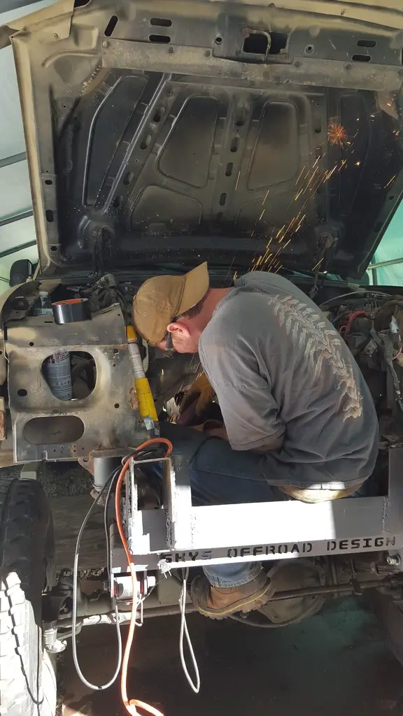

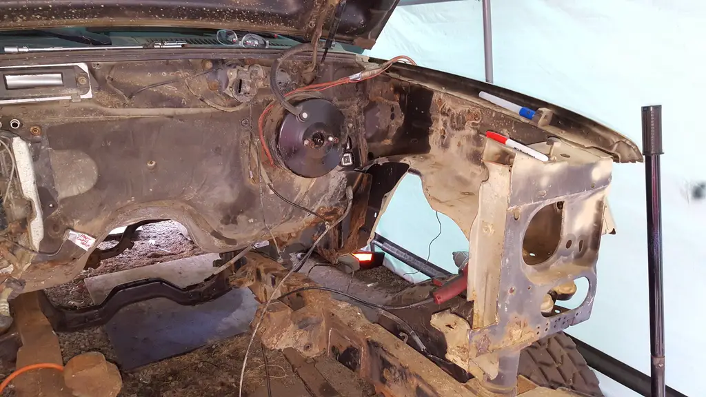

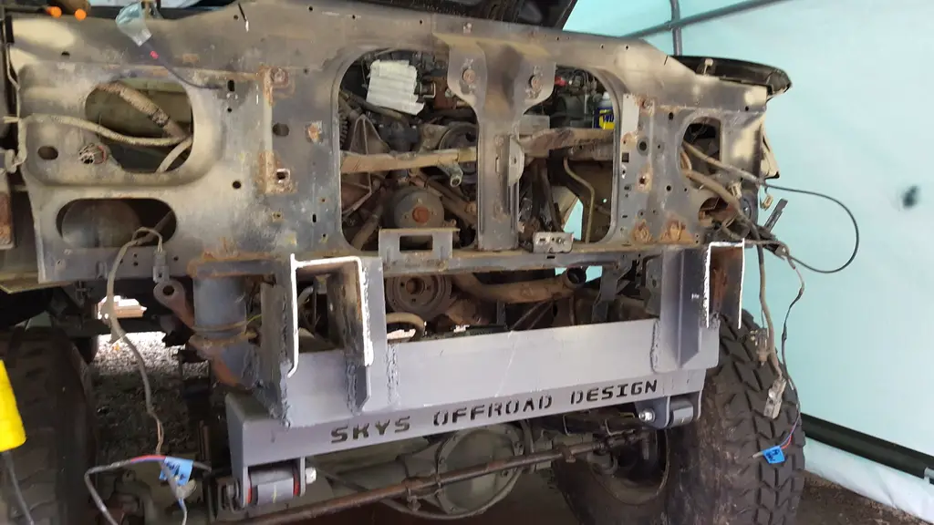

Everything except the power brake booster and A/C box is gutted. I removed the complete fuel system front to back because I'll be running a Bronco II gas tank. I removed the complete front and engine wiring harness so I can chase wires, splice and dice into the F-250 351w engine harness. Cut out all the UCA and shock brackets. Whenever I get spare time I'll be prepping the frame and making steel plates reinforcements for the front section and notching the frame for the Toyota steering box like they installed on the Rock Trac.
