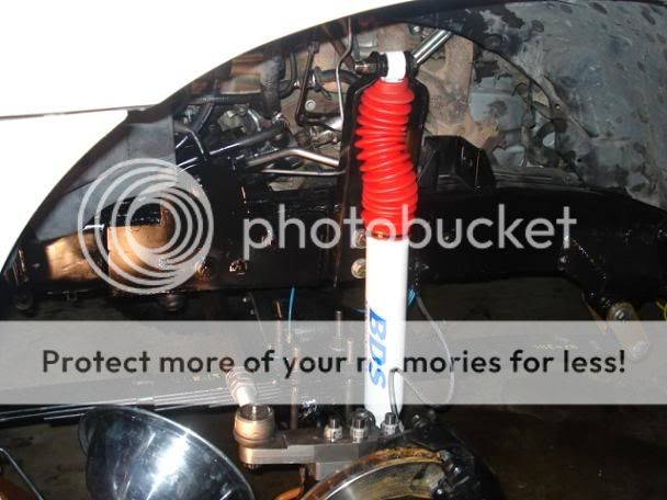

BDS front shocks

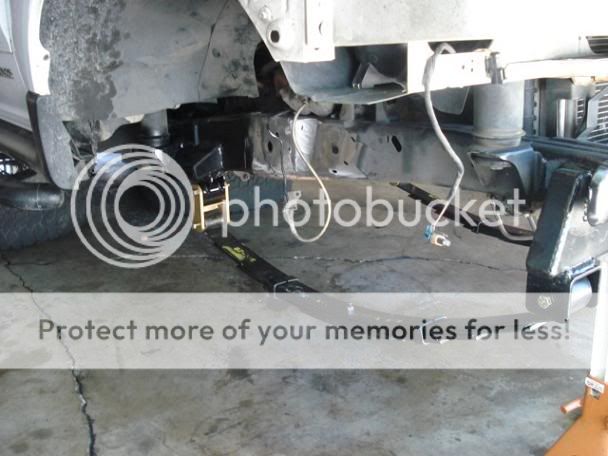

First was the install of the crossmember:
Then followed alot of cutting and grinding to get here, where the rear leaf mounts were installed:

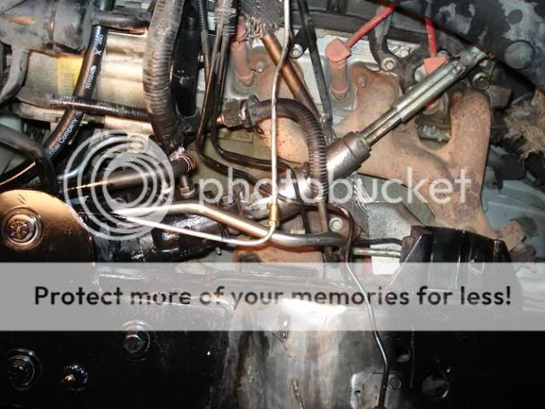

Steering was a PITA. Here is my Gen1 and Gen2 Hybris steering linkage:

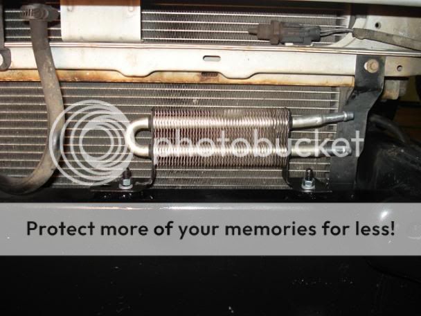

Here is the Rack and Pinion steering cooler re-used and mounted to my crossmember:
More progress:

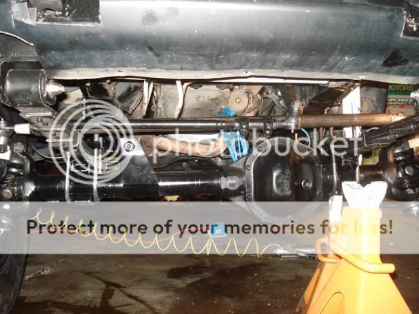

All this work to get here:

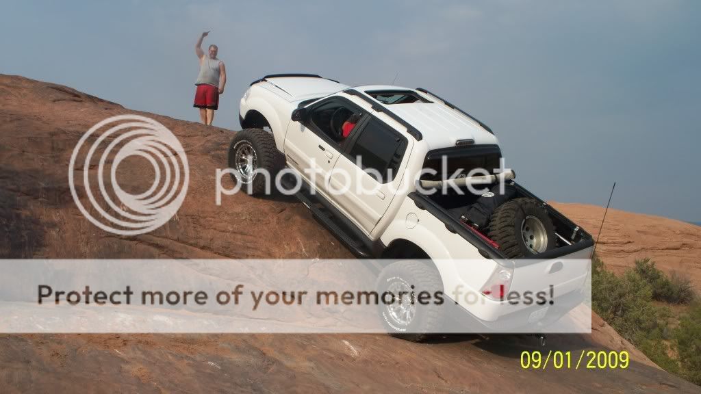

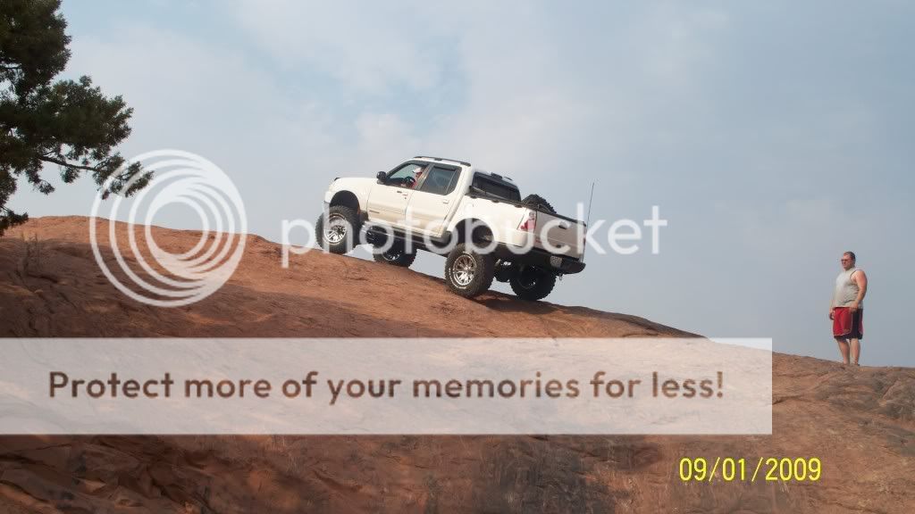

This is one sweet ride. Watching it climb in Moab was a treat. The pictures don't do it justice. You would not believe how big this rig is till you stood next to it. Some rigs look a little tacky lifted real high, but not this rig. It is proportioned very well. Street looks and creature comforts in a real off road 4x4, awesome combo.

They flexed good enough for the trails we ran in Moab. However only Brad (bronco2guy)
and Gregg (gmanpaint) saw how it flexed as I was busy driving up goofy rock walls.
Hmm, next time we go, will have some extra days and more time you can get out and check out your flex. Also we can pre run about 4-5 trails on some RZR's.
