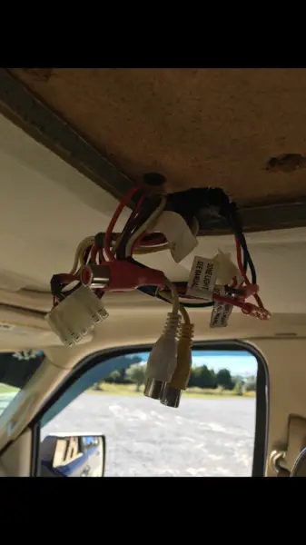

I have a 2006 Eddie Bauer and and hoping to add a few options. I pulled the navigation out of a mountaineer and installed that then got a Aux, Memory seats / switch and heated mirrors /switch. I am wondering if anyone can point me in the right direction to add these options. I mainly want add the aux and heated mirrors, do anyone know how to do so with any pictures? Also with having navigation I can not buy a adapter online to plug into the radio to have a functioning aux.

If you have the dvd player, you can plug into the aux rca jacks.

I don’t have a DVD player anymore but there is some old wiring that is still hooked up still from a old tv, would that still be able to work for audio?
