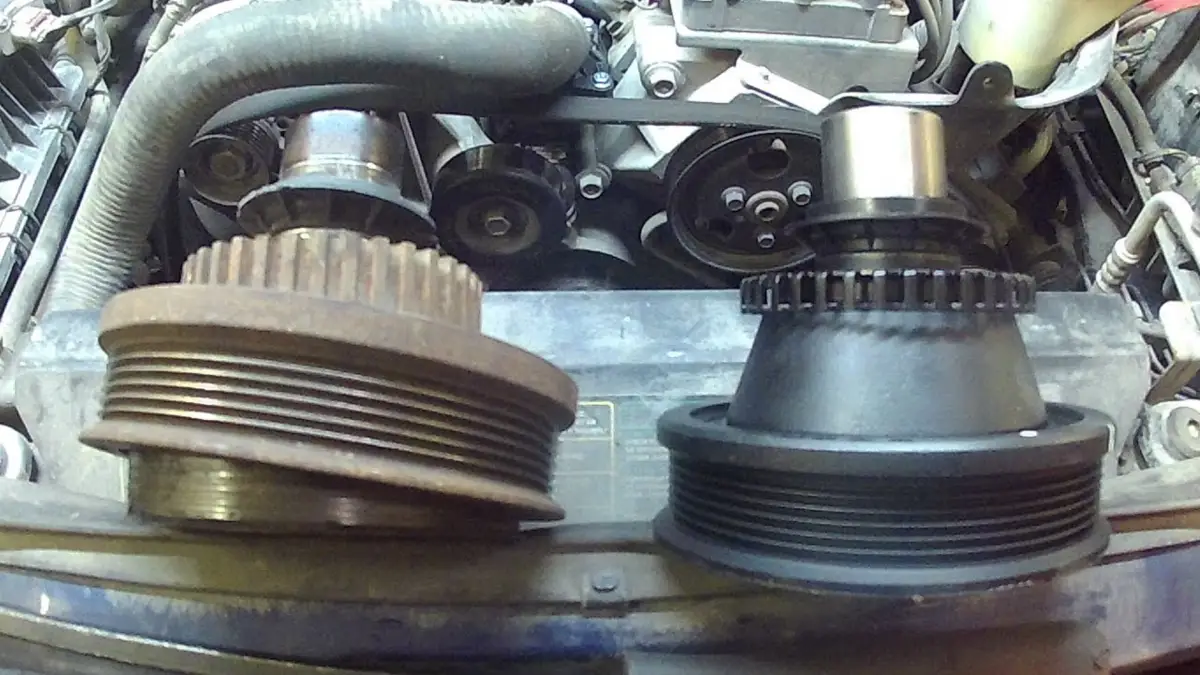

I took the belt off and started the engine. The chirp still occurred. So it's not a pulley.
I don't think it's the exhaust system either as I tried to shake it and there is no give or rattle.
I used the stethoscope on the starter, near the exhaust manifold, on the transmission and bell housing, nothing. I spent an hour last night having my wife start it and shutting it off while I was under it and all over trying to isolate the noise.
My only remaining idea is an engine mount squeaking from the initial torsion of the engine when it's first fired up. I have noticed the chirp when I accelerate from a standstill too. So this might be the issue. Should I just spray pb blaster on the rubber engine mounts?
