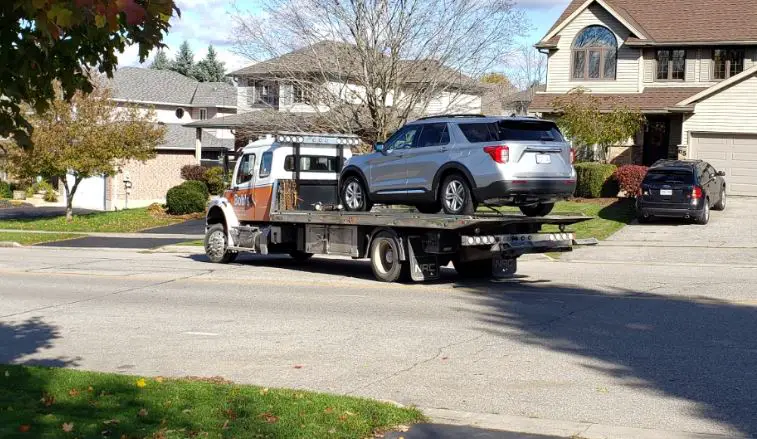

hi all, not sure if I'm posting this in the right place - if someone could let me know or move this, that would be appreciated.
Just this last Friday, Oct. 29th, I picked up a 2021 Explorer XLT AWD (base model). Happily drove it home and did a couple of errands, took my wife out for dinner. The following morning, so this would be day 2, it would not start. All the lights came on as expected but it would not crank. The start button was rapidly flashing green. I tried 20 times over and over with the steering wheel in a different position, brake on/off, etc,. etc.
A tow service came to boost/check battery and there was no issue there. A couple of days later, after talking to a Ford service advisor, I decided to have it towed back to the dealer. So this is with about 45 km on the odometer. Not 45,000.... 45! The dealer looked at it right away which was appreciated (and expected) and I was told from the service advisor that the starter motor fuse had blown. Why this happened, we don't know.
They're replacing the starter now and will try it. Has anyone else seen this and is this not just a little bit odd (not to mention frustrating) on day 2 with a brand new vehicle? Disclosure: This is my first ever north american vehicle. Also, I'm a fleet customer, so I didn't buy this outright.
I'm quite concerned this is going to happen again at a less convenient place than my own driveway when it wasn't urgent.
Any help, references or tips are welcome.
