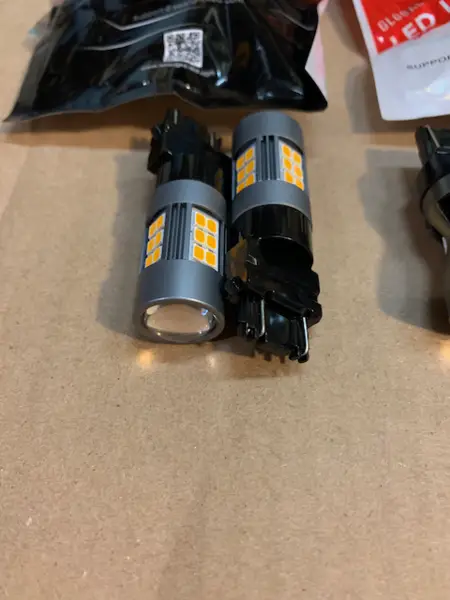

So used the same LED turn signals and theybare a vast improvement.

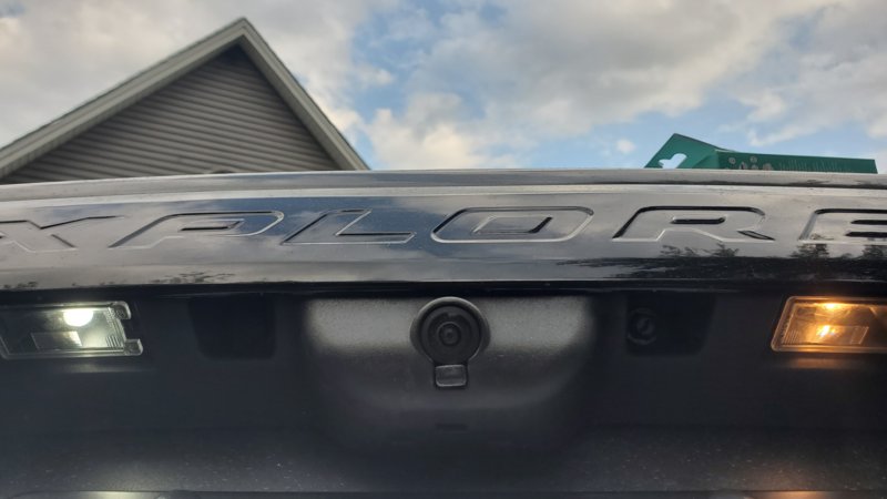

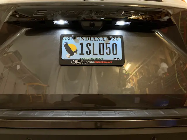

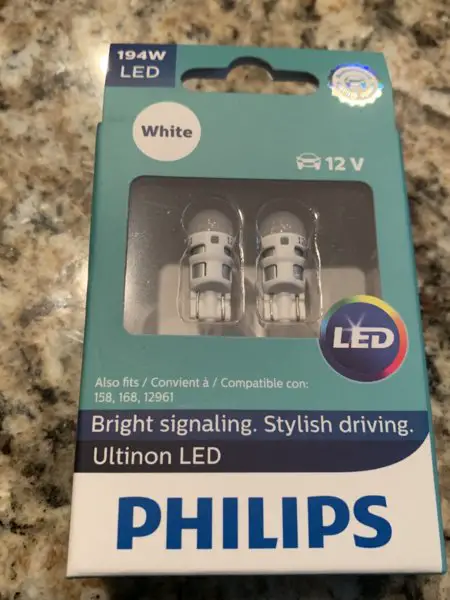

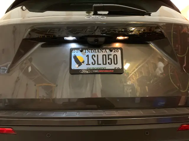

Also did the LED license plate lights but went with more expensive Philips LEDs. Didnt want to deal with cheap LEDs and starting to flicker with how much these lights are on (as opposed to interior lights). Left side LED, right side halogen in video (to compare)
Did you get the back turn signal lights just like these? I am trying to put the whole package on order with Amazon.

Here are the ones I ordered;
License Plate (similar but slightly different version of the Philips 194);
https://www.amazon.com/gp/product/B017VORB7M

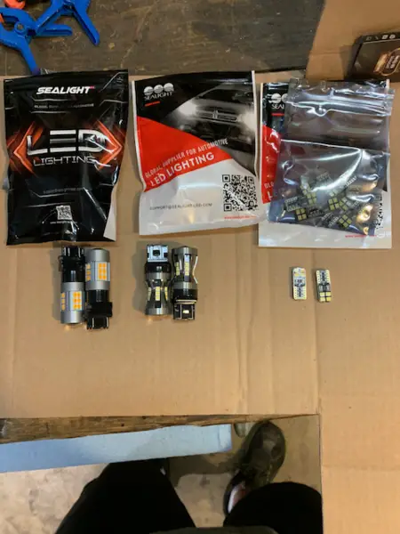

So I did my LED upgrades today. I went resistor-less for the rear turns as I can fix in Forscan if needed. I chose SeaLight for all the bulbs. Note that for the plate bulb, I accidently ordered a 10 Pack. I am guessing you could buy just two. Here are the links to what I bought:
Rear Turn Signals Bulbs

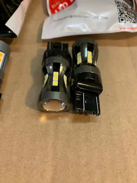

Reverse Bulbs
License Plate Bulbs (note that this is a 10 pack).

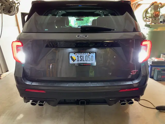

Here is the left Reverse Installed:
Both Reverse Installed:

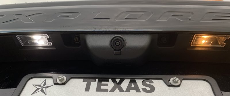

Left Plate Installed:
Both Plate Installed:

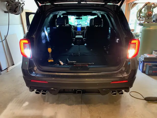

And here is both Turns in and both Plate bulbs in (I know should have put it in reverse as well :) )
