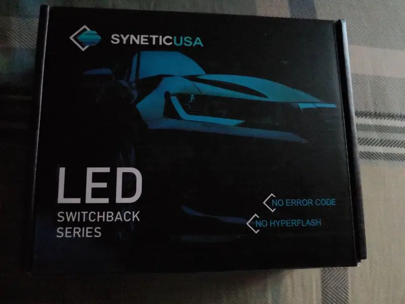

Here are the Reverse Lights
And the Signal Light

So used the same LED turn signals and theybare a vast improvement.
