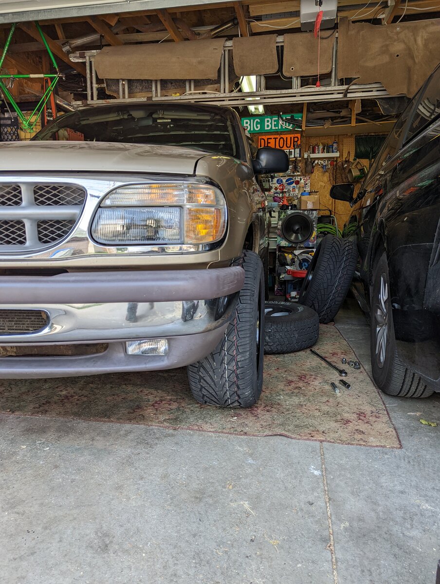

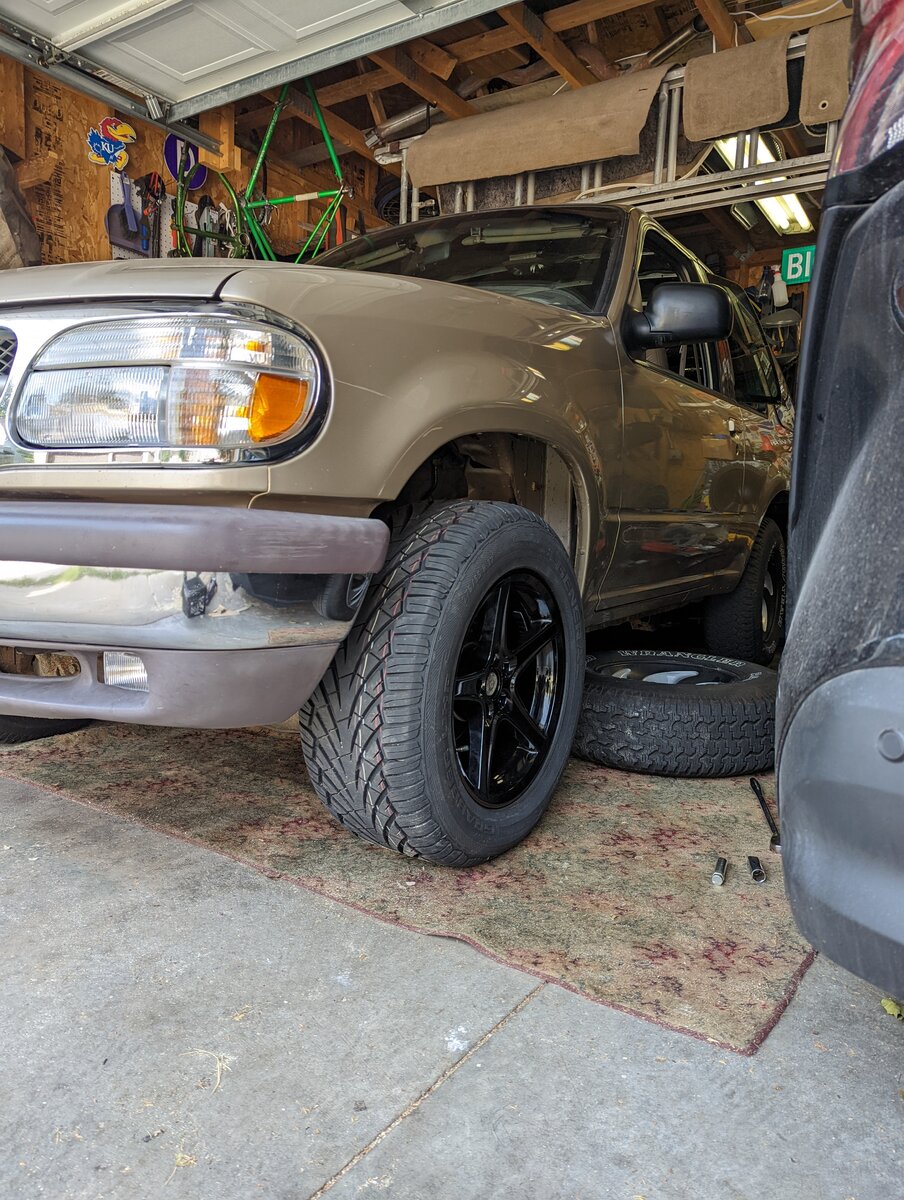

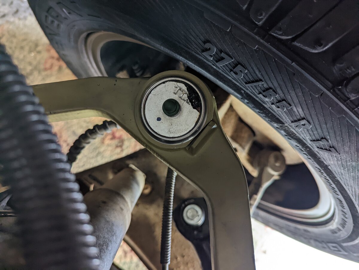

The update you've been waiting for!
I could only get 5/16" spacers locally, so that's what I used. With a 275mm tire on a 17x9+24 and the 5/16" spacer, there's about 3/8" between the sidewall and upper ball joint:
This means with no spacer, there'd only be 1/16" of clearance, which is right about what I expected.
Ultimately, I'm going to buy some 10mm hub centric spacers for a 2000 mustang (same center bore) and use longer studs. With the 5/16" spacers, I only got 4 turns on the nut -- 10 would be needed to have 1/2" engagement given the 20 tpi thread. TBD on what studs I need, I have to pull the tone rings off and press out the existing studs first.

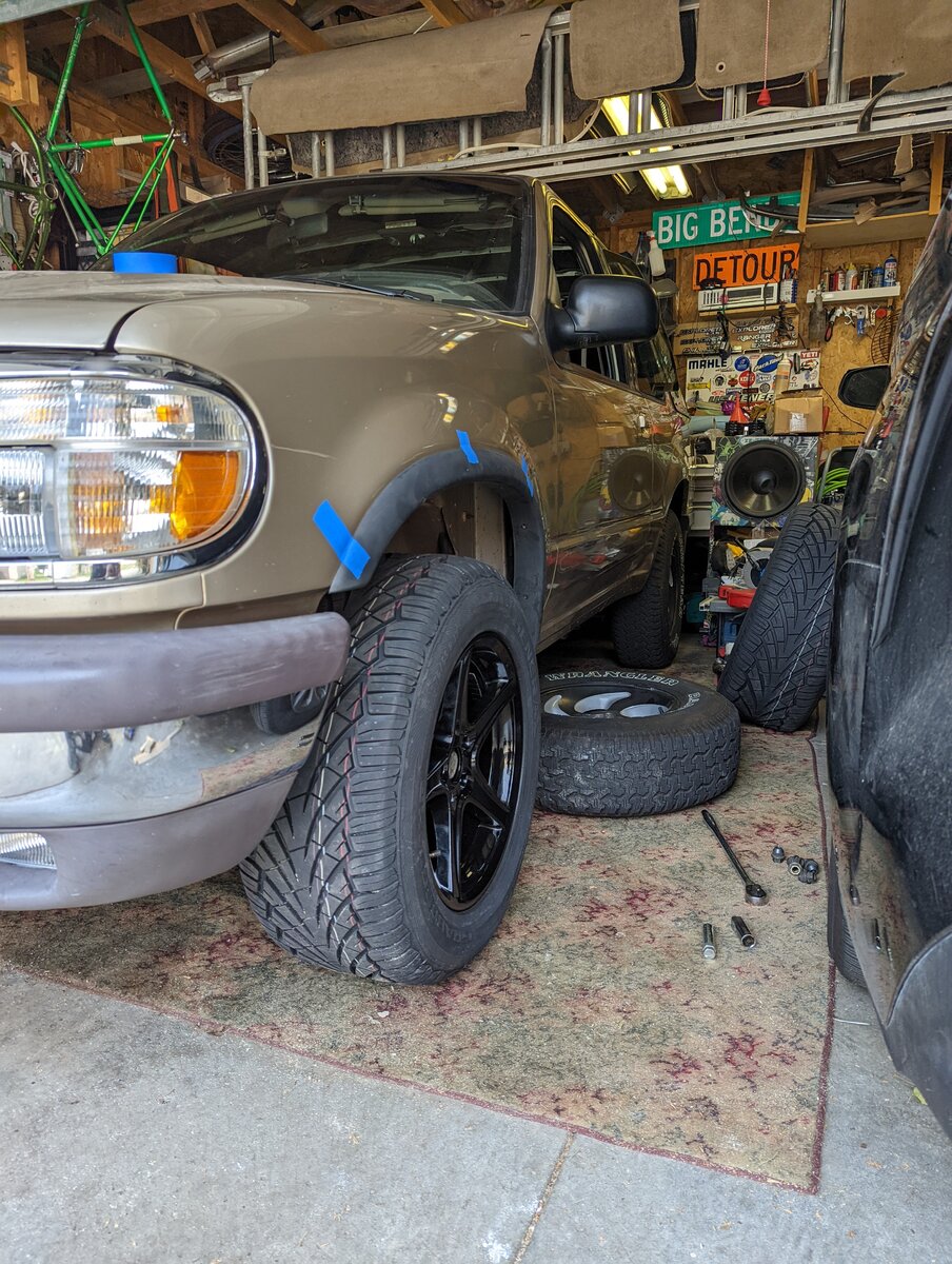

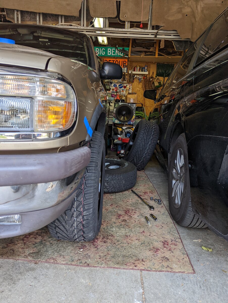

Here's the look with no flares (a bit of poke):
And with the base Sport flares, everything is just about flush:
Keep in mind these are all at stock ride height, there'll probably be a little more poke once the truck is lowered.

That's really close to what I was thinking it might be, the tire slightly beyond the fender too. That's about what my 16mm wheels I had been aiming for, and I have those front flares ready to put on also.
I drove my Mountaineer with about that same clearance at the BJ with my first 18's, 265/60's. They didn't rub on the BJ's at all, and that was 2007 with Moog UCA's. I like those TTX Mevotech UCA's, I've put about 50k miles on my black 98 with them.
