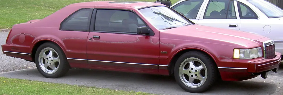

That's interesting. I have that exact tire size(255/45/17) on my Lincoln Mark VII right now, on stock 17x8" Cobra wheels. I hope to rework the suspension and move up to that 275/40/17 tire, widening the wheels 1.5" for that. But that's a car that needs that short of a tire, the SUV is made for a tire of 29" or larger. I don't think I want a 26" tire on my Explorer.
Yeah, it’s shorter than I’d like. These tire sizes are what mustangs typically run. These wheels were on a lowered ranger splash with the same tires and it’s looked great. My X won’t get as low as the ranger in the front. I have the torsion adjuster bolt all the way out and it’s still not low enough yet the least I could get the camber on the drivers side was -1degree. It needs softer tbars and custom upper arms.

My Lincoln I want to keep all four tires the same size if possible, so all of the suspension needs some work.
