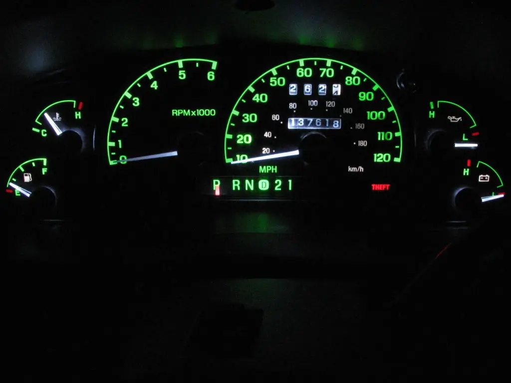

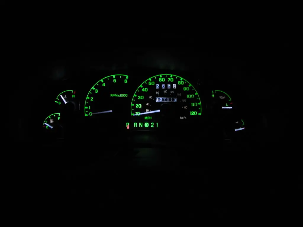

Pics!!
Jesus that's bright... I want to do it now........
Wow man that looks 20 times better than id have thought, makes me wanna do mine so much more now, i keep putting it off lol
