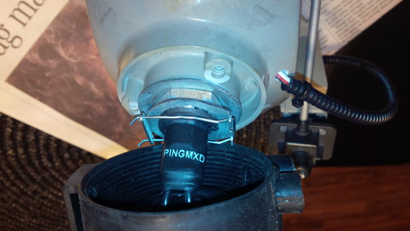

Btw, don can you take a picture of the back side of them? I want to see how you get into them to change the bulbs.
Of course Tim.
The first thing I did was look at the back when they showed up. Bulbs are easily changed. I forgot to throw the box in my truck this morning to show you.

Anyway, here's the pics Tim. I'm hoping I can do the install tomorrow, but its my wifes work party at our place. I'm sure she will keep me busy all day. Maybe Sunday.

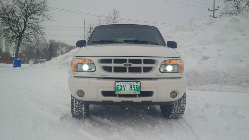

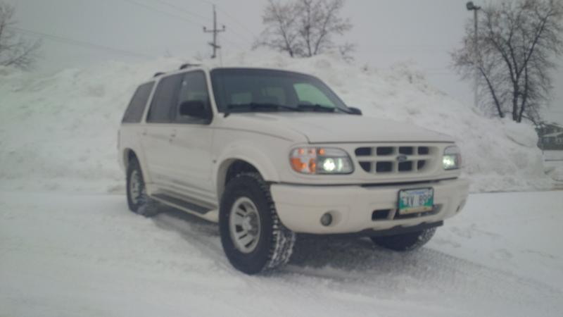

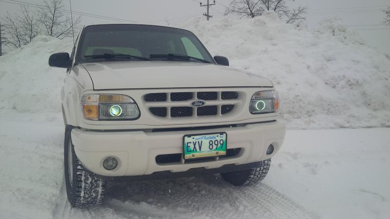

The shots of the beam pattern at night will come when I get a chance (And find a wall to take good pic's with).
The hid's are a huge improvement over stock.

The first pic was with just the halo's on, but the flash must hve reflected off the lens.
I did aim the lights better last night. It was a 30 second adjustment, so I was pretty happy.
