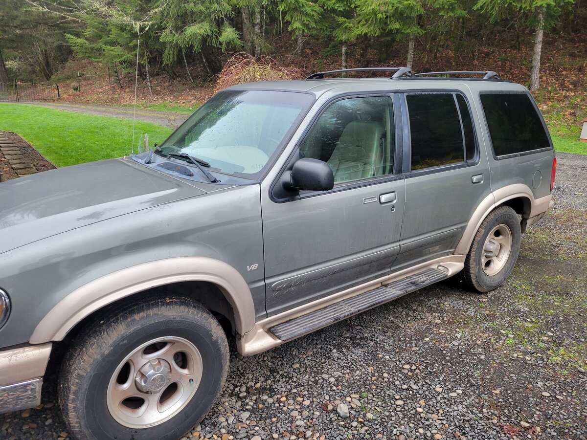

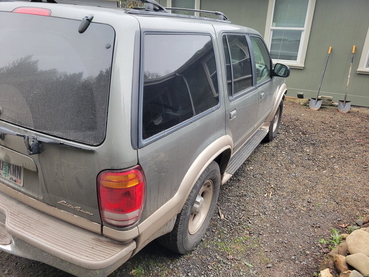

Hi guys! I'd like to avoid any fender trimming so 31s may be in my future. I'll need to measure and see how much space I have after a lift. Here's a few pics of the Ex!

Give it a few searches, there are threads with max tire sizes for each lift from stock to the 5" rc lift and such. Stock height, should be able to throw 31s on with no issue I believe, better of you go ahead with a TT and lift shackles, gets you a couple inches of room. Looks nice by the way, just dont throw tires wider than 10.5" I believe, becomes an issue beyond that.

i couldnt run 31s at stock height :confused: i even rub withmy OMEs and TT... its always interesting to see how differently everything fits peoples vehicles!
Very true, depends on the vehicle and its history. 31s definitely fit better on all of them than 32s do! 😂
