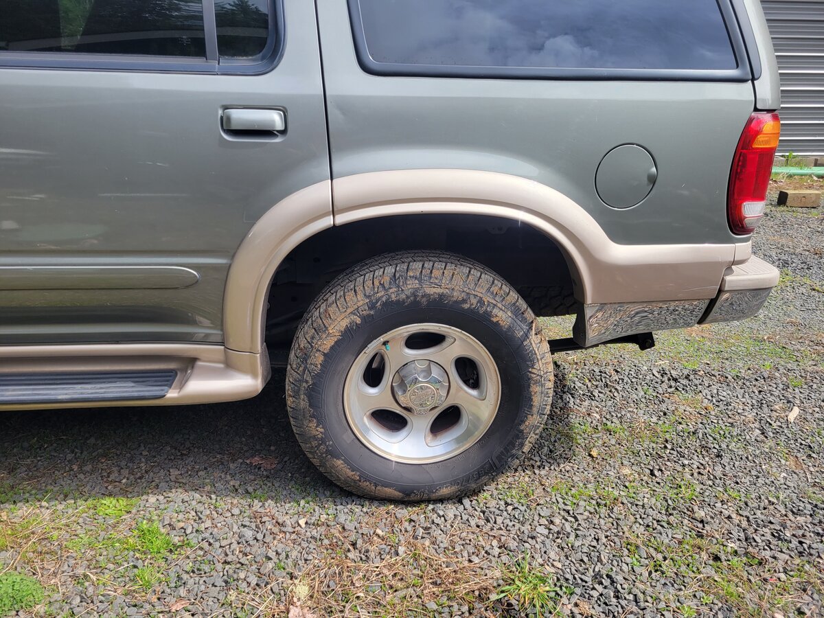

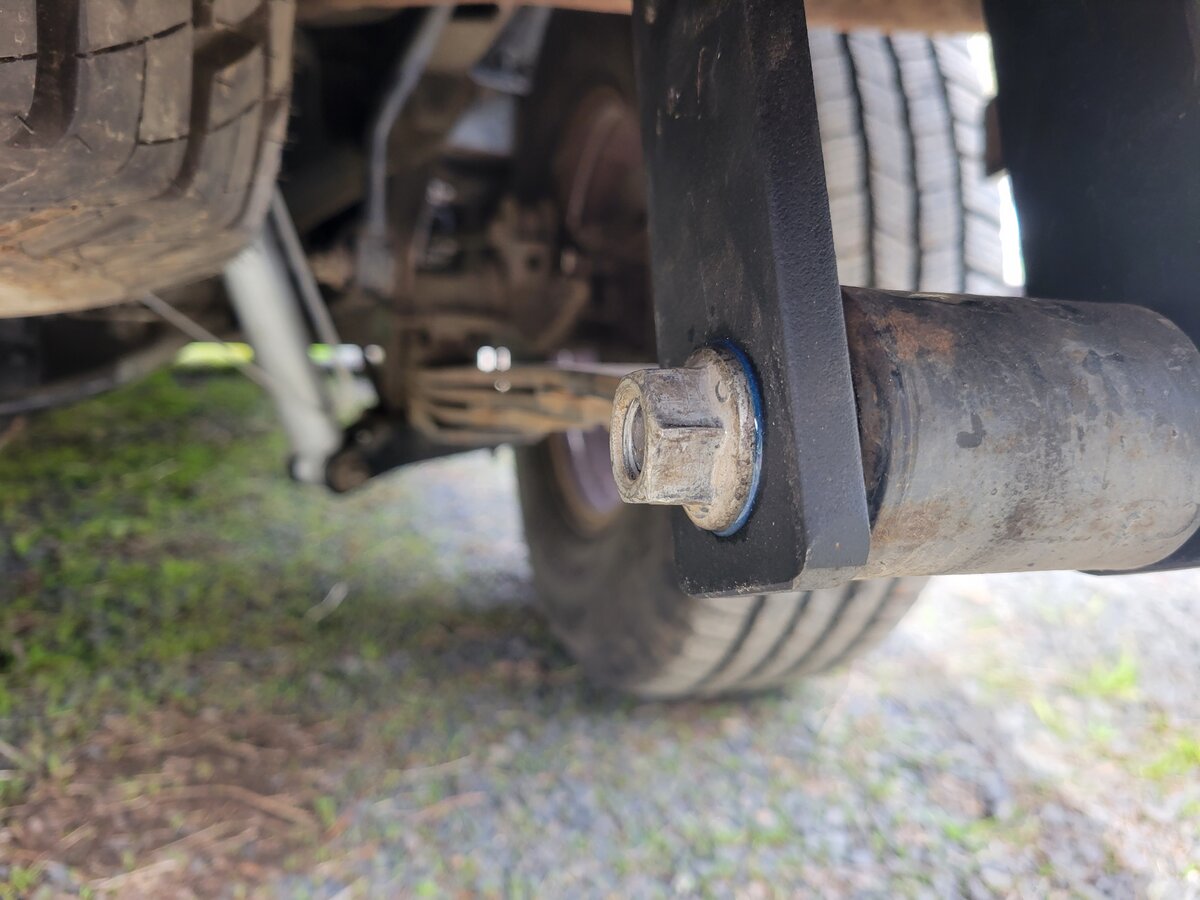

Got the control arms loosened and rocked and bounced it then re tightened it. I also did the t bar twist as well as the rear shackle lift. Is there a good PN for a longer rear brake hose? I may remove my rear sway bar in the future for more travel but I don't wanna rip a hose in the woods. Lol here's a few pics! I nearly had to lift the driver's side 2" and passenger 1.5" to get them even. Also I re used the shackle bolts and used some Blue loctite so it doesn't walk off, seems a bit short but what do yall think?

It looks really good. I have seen some pull down the plate that has the Hard line down towards the Axle. I had a 97 and I fixed a hard line to the center and ran a Soft line to the axle then ran two hard lines on the axle out to the Wheels. I will probably do that again with this one. I had a 78 blazer and that is how the lines were ran on it and I never had issues at the axle for brake lines.
looking good!!!
