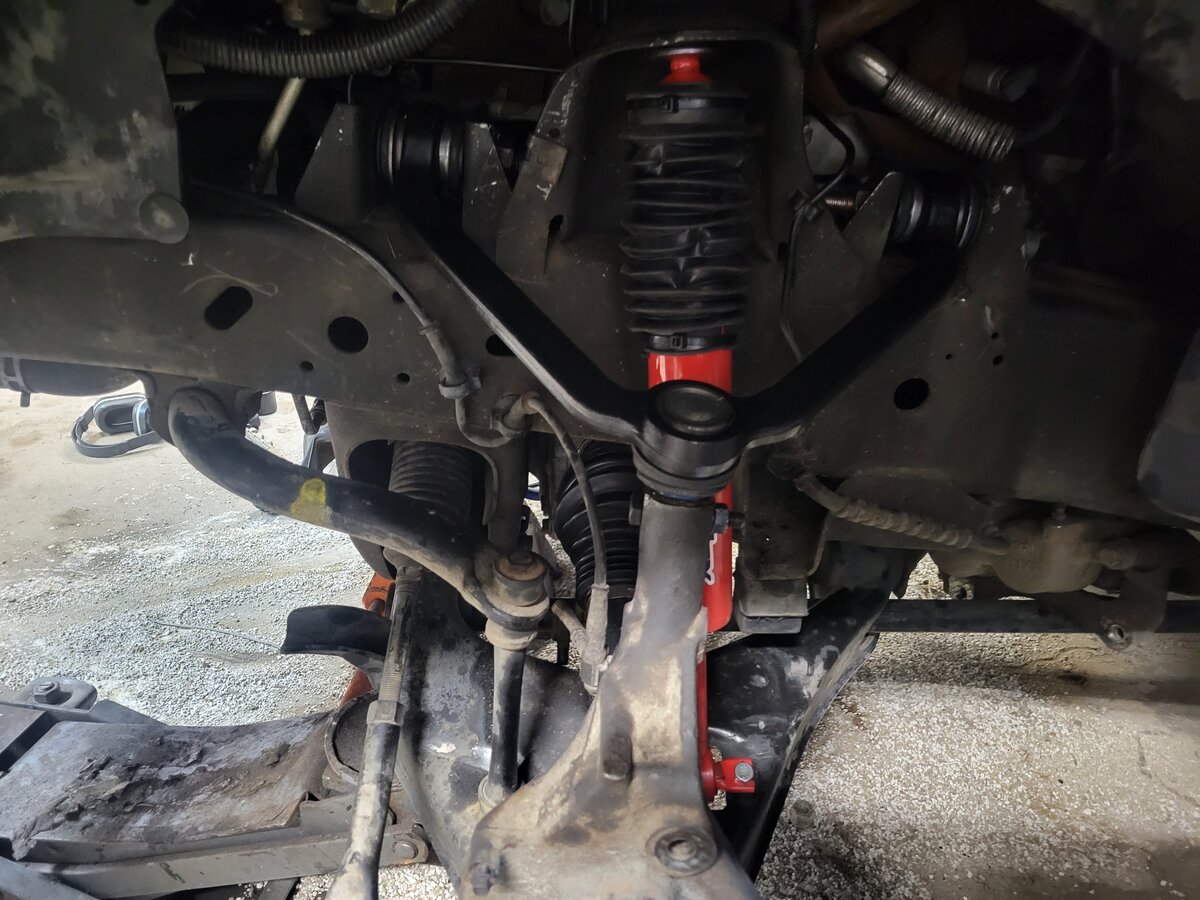

Hey guys just giving an update! I got all the parts installed and then realized I forgot the two outer Axle seals... so I'm waiting on those and will probably be able to finish the explorer this weekend. On the driver's side the UCA was a huge pain to get out. I ended up cutting one of the bolts out and getting a new one at the hardware store. (Grade 8). After I got the control arm in I noticed the most forward bolt had a gap between the bracket and factory square washer. I removed the washer and bolt only to find a brake line pinched in there! I got a whole new hard line ordered. I thought about coupling it but the space is was to tight to get a flaring tool in there.. all this work should be a huge improvement. 3/4 ball joints were toast and 1 tie rod had about 1/8"-3/16" of play!
I'm thinking I may order new keys lift the front shackle the rear for now because I have them and get an alignment. When I save up and order tires I'll probably do f150 springs in the rear to help with the sag. It's not as bad as some explorers but I do notice it.
Here's a picture of the DS nearly complete and a pic of the smashed brake line.

Yes getting the alignment bolts out of the uca is a real pita
First you have to unhook the Evap fuel vapor Line from its clips as well as some the brake lines, this gives you room to work
Next you need to get both sides loose so that the control arm can move out to the furthest outward position freely
Now you can wiggle out the front bolt followed by the rear
Install is in the reverse order
You do realize that the uca bolts are flat on one side to allow them to slip inside the alignment cams right? Cannot just use a grade 8 bolt here
You should consider getting an adjustable alignment kit comes with two new uca bolts and eccentric camber adjusters. I paid $12 for the last one I bought in rockauto, parts stores carry these as well

Didn't know that about the bolts! I did notice the flat part. I'll order a new set! Do you have a PN for it?
Does it matter which way I install the fasteners?
I want to say they only go one way, but my bet just to be careful would be to try and match them up how they were before. If you're not sure, chrisfix has a video from doing the control arms and talks about it a bit. Always a good channel for repairs on our trucks!
