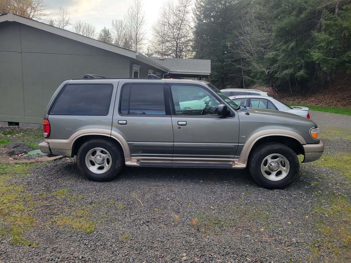

Good news! Got the front end sorted out and finished! New shocks, wheel bearings, high articulation CVs, ball joints UCA's and tie rods. I still need to do the rear but it looks like the new shocks lifted the front end. I noticed a large lean to the rear when I drove it out of the garage.
Plans are this week do the T bar twist and longer shackles in the rear, new rear shocks and take it to get aligned. Might rebuild the front drive shaft if I have time. New brake line should be in next week so I'll tackle that pinched line then. I think I'm settled on 31x10.50s all said and done especially for what I'm gonna use it for. (Hunting,camping and some snow wheeling/fs roads)

Shocks don’t lift suspensions. Did you tighten all of your control arms with the suspension in droop?
No exactly full droop, but close. The old shocks may have been factory. There was no rebound. Once it was compressed it stayed compressed.
Shocks only control the rebound of the spring the spring supports the vehicle weight
Helper springs can add lift but a shock never will unless it is an air shock and in those the air is acting as a spring

Your truck likely looks lifted because no more sag from suspension parts and proper alignment
Well done!!! Truck looks nice
You should tighten all of the control arm mounting hardware with the suspension sitting on the ground under regular compression. It may be sitting high because the preload on the bushings since you tightened everything with the suspension in droop. Loosen them all at once and then retighten.

Good to know! Ty I'm gonna Clean the shop out today and bring the explorer back in to do a little more work before it's alignment tomorrow. Should I loosen one at a time then re-tighten? Or both before re-tightening?
It took at least 80-100 lbs to compress each bilstein 4600 shock (very high gas charge) when I installed them on my explorer.. that's a combined 160-200 lbs, which could provide an increase in ride height... The lateral stability shock for the rear axle was very difficult to get installed.
Shocks with built in springs (helper coilover/strut/ air / gas) are similar to an airbag they help the spring carry the load which yes can increase ride height
Until they wear out
I would loosen all control arm bolts with the truck on ground at ride height and then bounce the suspension a little to reset the bushings and then finally Re torque
