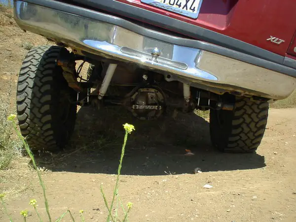

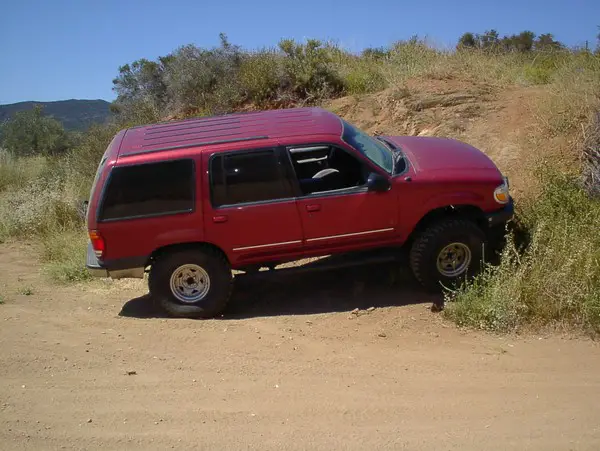

35s with no body lift trimmed corner of front fenders and it clears with no rubbing. 3" shackle lift an tightined stock torsion bars.got ramps on both corners in pic.
@Donaldsundstrom Pics please showing more detail of trim, also, show that area with steering wheel turned to where the corner tire tread comes closest to touching the trimmed area.
Thanks!
Oh, I could see that with a 3 inch lift. Mine is just a one inch with no extension required. Thanks for clarifying.
Is this SAS in the front or still IFS? Got 35s and beadlocks sitting I wanna put on so bad.
thats Jefe's rig, iirc he has an SAS for 7" lift. However, for a bit, he was able to clear the 35s with 4" lift but TONS of trimming, imo not worth it... or Gerald had 35s on 4.5 lift, again lots of trimming
