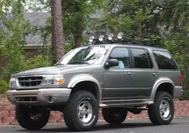

Thanks Elessar65. Ya it looks the truck in this picture has the same rims I do:
He's running 295/65/16 BFG All-Terrains, so I guess those are 33"s? Also, I think 295 is about as wide as the 16x7 rims will handle, right?
This truck has 3" spindles, and 3" TT.
Is 3" for the TT as far as you can go on a 2WD explorer? The truck in the photo is just about perfect, except I would go with another inch or two in the front
I believe all the stock 16's were only 16x7. I have a set of tri spoke chrome Eddie Bauer wheels I have not been able to sell, they are 16x7. I am thinking of putting on some all terrrains to use for winter and was going to purchase 285/75/16's. People have put 33x12.50x15's on 15x7's on this site, I think 295/75/16 would be about as wide as you would want to go. Only negative I can see is, there arent many tires to choose from in that size.

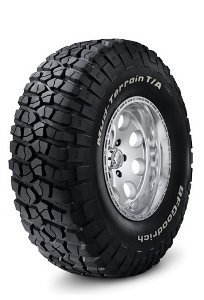

- For tires, I am wanting to go with a 305 width. Will this be ok with my 16x7 rim?
Here are the tires I was wanting to go with:
BF Goodrich Mud-Terrain T/A KM 2 305/70 R16 118/115Q
Anybody know where the best prices on these tires are? (or comparable tires). These ones are like $250/piece, would like to find some place cheaper if possible.
Thanks!!!!

Ok, so I should be good to go with 33x12.5's on my OEM 16x7 rims?
Cool, because I found some 33X12.5R16.5 BF Goodrich All-Terrain T/A KO's online for around $150/piece. But these say for 16.5" rim - will these fit on 16" rim?
thanks for your patience, Im learning as I go haha
The 16.5's will not work on a 16in rim their different sizes. I think the size you should be looking for your 16's are 285/75/16 for a good fit and minimal rub.
tires
i would highly advise against the 16.5 tires, they are a pain to try to find wheels for, but like they mentioned it wont work on a 16x7 rim. I found some BFG all terrains 315/70(ithink)17 on craigslist with atleast 75% tread for 75 each so i got a set of those. i looked around the site for all terrains vs mud terrains, if this is your DD (mine is too) id suggest the all terrains. it seems they grip better on wet roads and are all around safer on streets. just a suggestion :thumbsup:
thanks, ya I think I am going to go with all terrains. I just want to find the best tire for the 16x7 rim I have. I get confused between...for example, the 33x12.5 and say a 305/70/16
