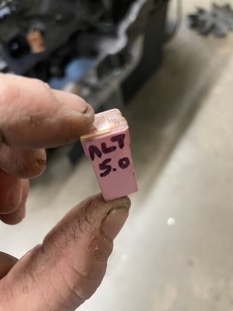

new fuse added

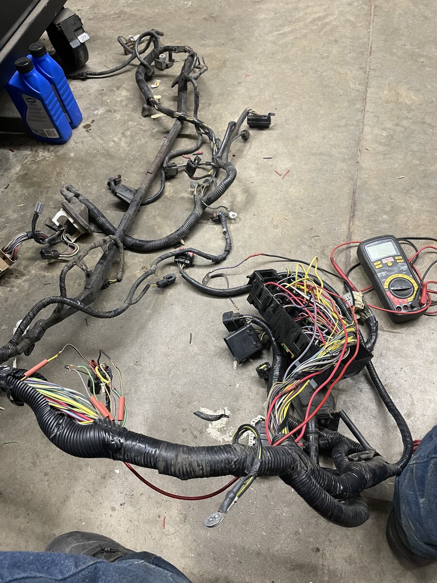

Truck is prepared the holley PCM battery harness was run through the firewall and into engine bay then the steering went into the dash
Holley wires going through factory wiring grommet
routed, PCM has power
