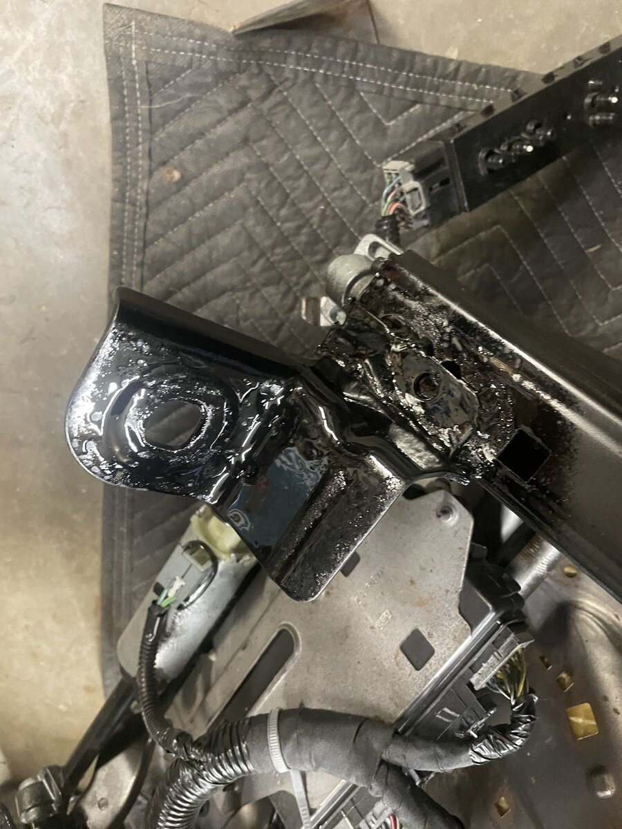

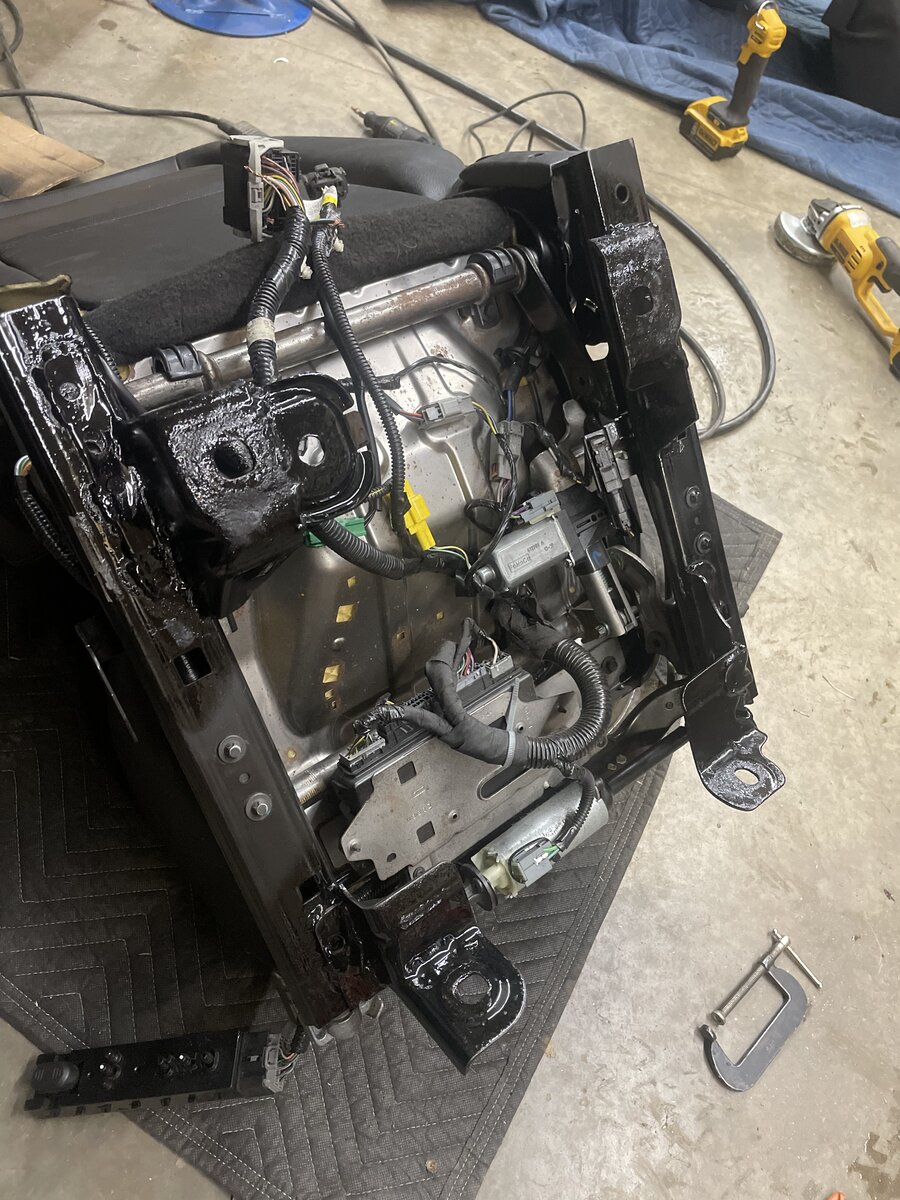

These “brackets” Made from
Ranger slider base parts and 14 edge seat mounts. I have installed lots of weird “restomod” seats…. each time it is custom fabricate mounts….. make sure it’s centered, straight, and as far back and down as you can get it. Use the feet from the oem seats and make them attach to the new seat. Have to
Make it strong and safe consider location of seat belt mount etc.
Then there is all the wiring… these smart seats have many wires

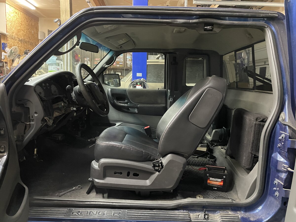

Drivers seat fabrication is now done!! Fully
Bolted in this picture
It took a lot of fabrication / trial and error, this is as good as it gets with these power seats. I cannot space them any lower to the floor!!
Had to get a seat in the beast so I can test the drivetrain, cluster and begin the next phase
I plan to have this truck done by the end of this month! Yea February 2023!! Hoping it makes Moab in May
The inner rail on the drivers side is as low to the floor as I can go
All 4 “feet” fabricated from stock parts made to fit the factory seat hold down bolts.

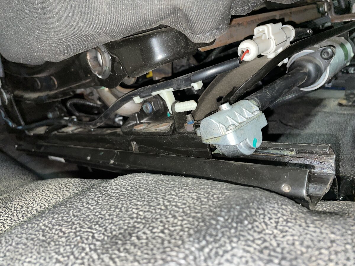

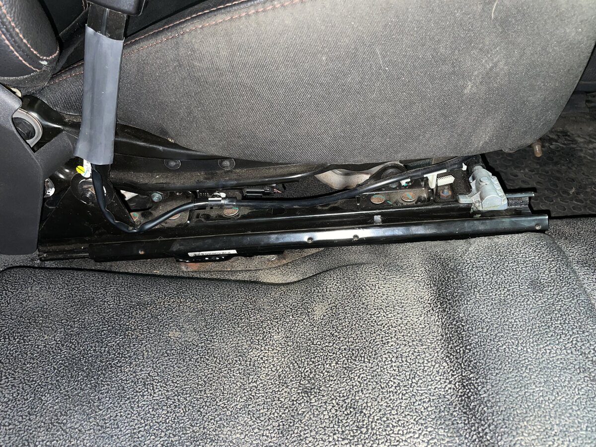

02 sport trac seats fit a ranger almost like stock, you have to modify the seat belt track slightly to reach the ranger hole down bolt in the floor. Easy mod. I’ll show you I have a 2000 ranger here w 02 trac power leather buckets

Drivers seat final Re enforcement on feet and paint, now bolted fully in and with side plastics
Seat sits 1-1.5” taller then factory at the front bolster
A little large for a ranger but do able
I am still looking at ways to shrink it closer to the floor. I may try to use manual slider tracks on the passenger side which could lower it another 1” by removing the power forward and back tracks from the 2014 edge seats
