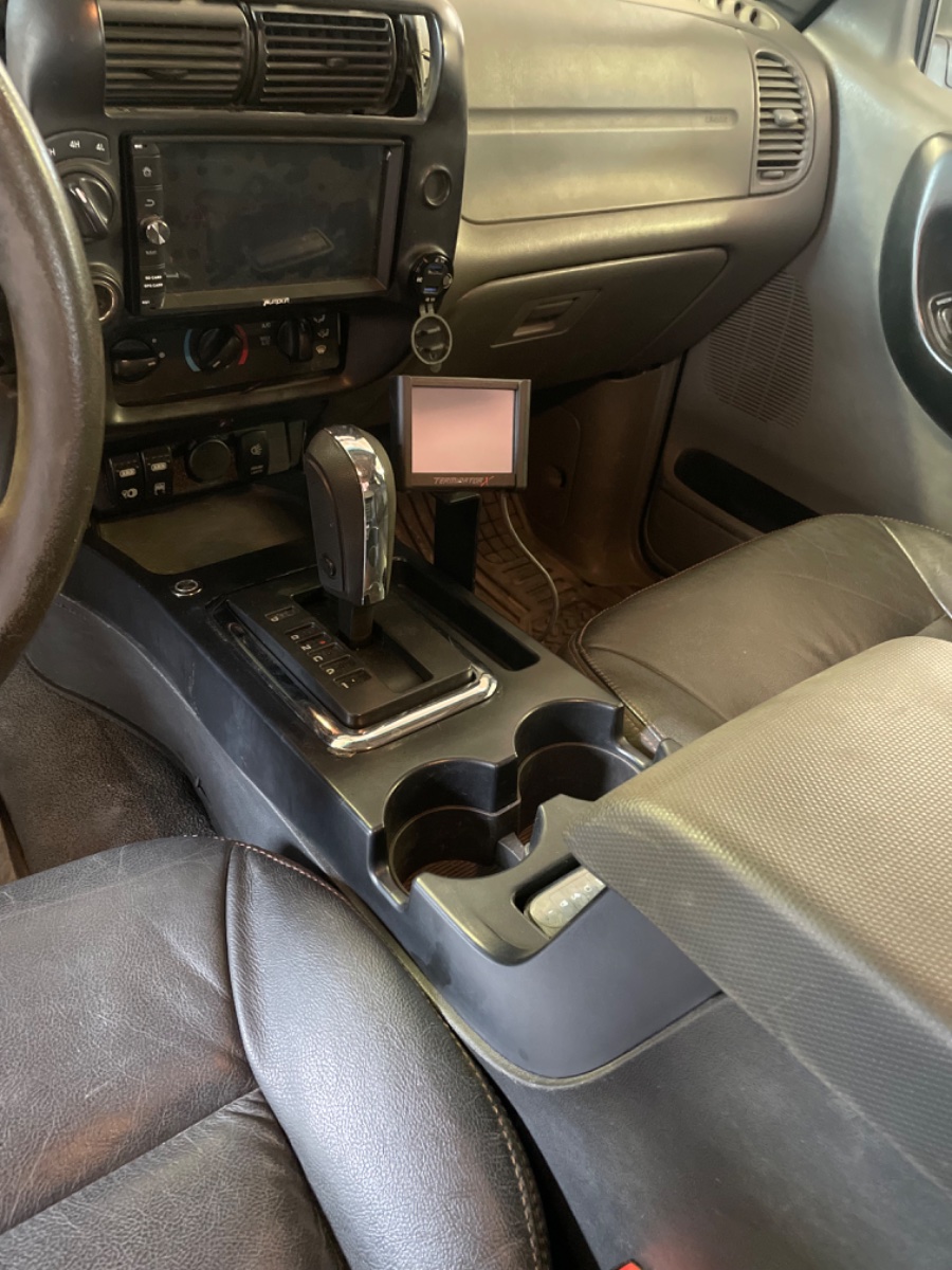

I using a 05 cluster in a 07 truck with a 07 dash and 07 wiring harness. I ran a new wire, I tried a different ground, reversing polarity, checked continuity, ran my own leads to bypass harness...... same result. There is no anti slosh module on these its a microprocessor....it is kind of neat actually you can watch it take a "sample" about every minute....
55 ohm empty 230 full
I put 5 gallons of fresh fuel in it a few months ago when I started driving it, then during test drive on Wend i went to the fuel pump figured I would get as much fresh in there as I can...... I never could have foreseen this issue!
