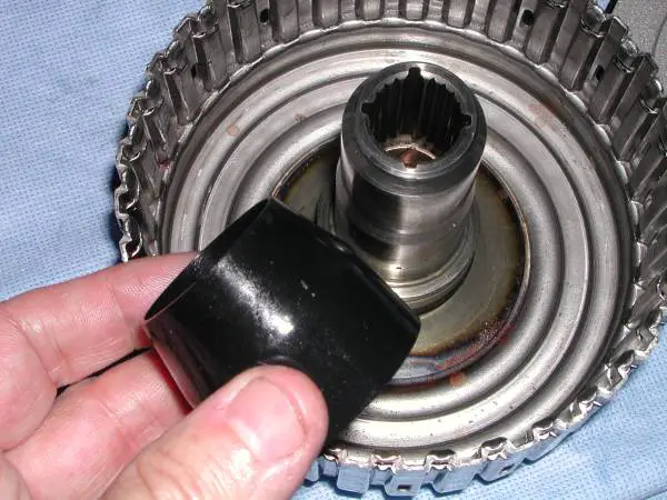

I have purcchased, or already had the following tools:
Lip Seal protector set (seen in various posts/pictures, here are a couple)
Pilot Bushing Puller
Clutch Spring Compressor
I also just bought THIS spring compressor:
Rear Case Bushing R & R Tool
Direct Drive Solid Sealing Ring Installer Kit
I have also purchased a new Digital 6" Caliper, and the 4r70W manual from ATSG...
