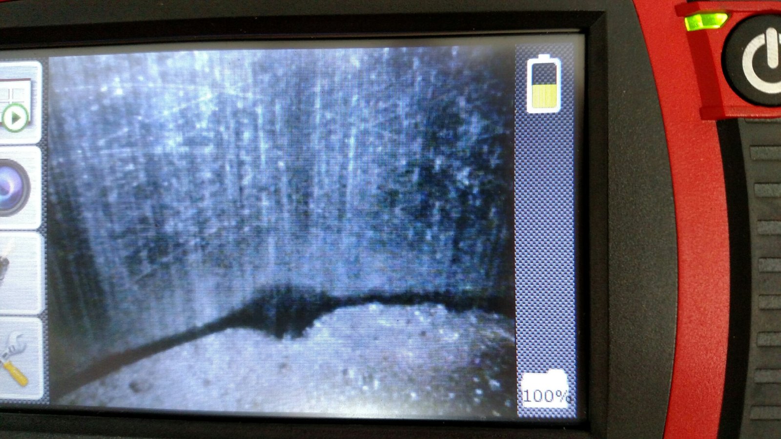

Not really sure what happened, I was pulling a trailer up a steep incline on the interstate near Cookeville. I got on it pretty hard to pass a slower big rig and it lost power started smoking and the CEL started flashing. It know makes a knock noise above 1800 rpm under a load. Got the scope from work and found this. Not sure why, timing, plug issue, injector?? CEL was not on before this happened.
