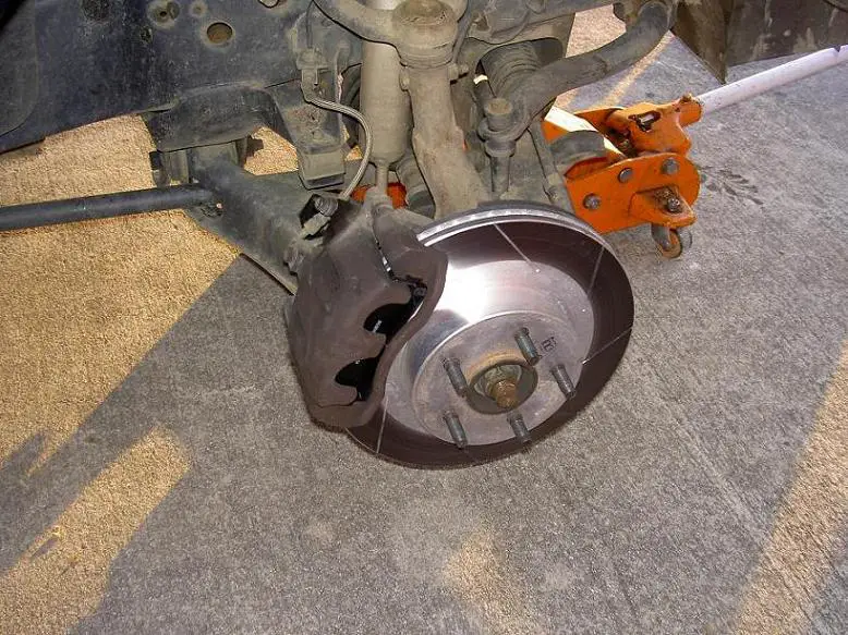

Sorry, I was out in the garage all day, Atco Raceway opens tomorrow so I was prepping my truck.(removing center caps etc).
If I remember correctly,
the brake parts were from a 2003 explorer sport(2door).
I got the 2003 spindles from the junkyard, new 2003 rotors from pep boys and EBC pads from ebay. The pads were the same for 98 and 03.
The caliper brackets and calipers were the same as well so I did not need to change them. Check out the caliper bracket holes on the spindle in the pictures.
$28.00 each for spindles from junkyard.
Maybe I should have replaced the calipers since they are so ugly.

I don't know anything about the Aviator Spindles. I edited my previous post to clarify 2003 Explorer SPORT (2door) for the spindles. I had two explorers in the junkyard right next to each other,
1998 explorer 4 door(same as 98 2 door) and the 2003 explorer sport 2door.
It was awesome, I tried the parts on the 98 before I bought them.

No, I did not have to change the calipers or brackets. Just spindles and rotors.

I would say, at the end of the quarter mile when I let off the gas and hit the brakes that the vehicle feels like it will slow down and stop when needed. Before that it was kind of like well the brakes are heating up and loosing grip now, hope it slows down enough.....

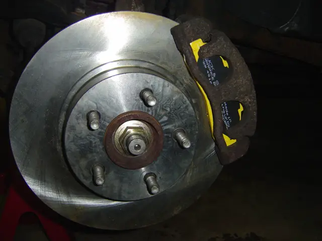

I don't know how else to describe it. Just going to slightly larger rotors is not going to be night and day difference, but it will be an improvement. Adding good pads will also be an improvement. I don't recommend the yellow ones I got. There are different pads for different applications. I was looking for the best Cold bite. After installing them I heard back from an employee at EBC that the green ones have a better cold bite. Research your pads by the type of stopping you want to improve.
How much better would you say it stops with those 12" rotors?
I recommend the 01-05 Sport and Sport Trac rotors. I installed the rotors and spindles on my mail truck in 2007 with EBC green pads. They worked great, but as said they are not much more powerful. I later changed to the Brembo Cryo treated rotors, very nice piece.
You have to have the spindle to match the rotor size, in your 2WD or 4WD choice. I also got the calipers back then, not knowing that the pads are virtually the same size. I suggest sticking with the OEM pre-2001 calipers, they have steel pistons and the pads then match the truck.
As for pad choice, I've liked the EBC green the best, but for my big custom brakes I moved to the yellow pads this time. I think these bite much better when cold, I did notice before the green version would be weak when cold(took much more pedal when cold).
As part of a good suspension or truck rebuild, the OEM 01 Sport spindles and rotors are worth the minor upgrade. For a real brake power upgrade, it will require special parts unfortunately. I was the first to do my own, and others have done kits with the Cobra rotors. But those limit wheel choices,,placing the caliper farther outboard, seriously close to the wheels. Few wheels will clear those. Saleen XP8's had Alcon brakes until the brackets cracked and were recalled. Those can be duplicated if you can get steel brackets, but those special rotors and calipers(and pads) are super high dollar(plus wear very fast).

Rotors
What were the two different rotors in the pictures?
