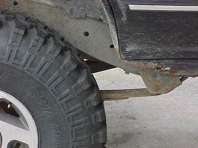

This is 6" of lift with 36" tires (and they measure a true 36"). A little fender trimming is all that is needed, no F150 spacers and no expensive and fragile fibreglass fenders.

Does it rub at all when on the trail? I just worry about cutting tires up, that was my main concern.
No rubbing if you trim the fenders properly and adequately. You will also need to trim the plastic inner fenders.
