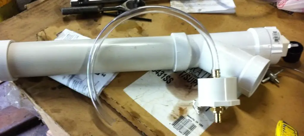

I have lurked on this site for a while.... lots of good stuff here! Yesterday I tackled a trans fluid change on my '02, which I picked up a few months ago. Thanks to the posters in this thread and my Ford service CD, I knew that I needed some way to put the fluid back in the trans.... so I made a trip to the hardware store and came back with parts to make contraption that allowed me to use shop air and blow it back in the transmission. ;) Maybe this will help someone else looking for a way to do this job.
This photo shows the tool partially assembled. The clear tube laying on top goes inside the "y", and reaches the bottom (left in the picture) where the flat cap is installed. At the top (right in the picture) there is a threaded cap which allows me to pour in the fluid. In the cap is a tire valve stem, with the valve core removed. Air is blown into the tool via this valve stem. Anything could be used here, but I went with it because I had it laying around. :D

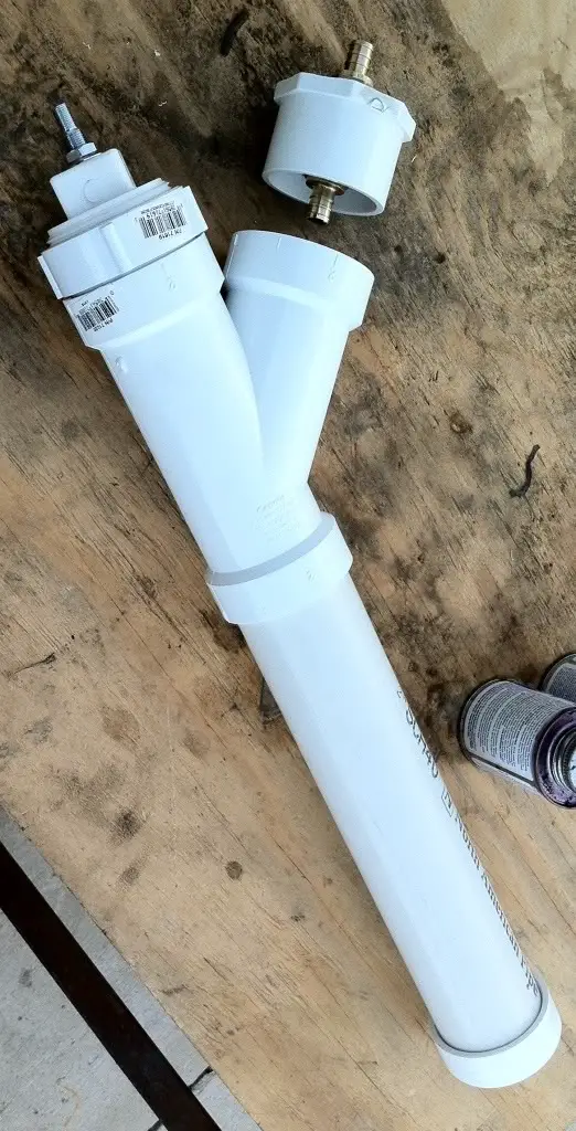

This is another picture of the item unassembled. The pipe diameter is 2", and the length of the long piece of pipe is 12"... obviously larger would get more capacity, but this size was chosen with price in mind...

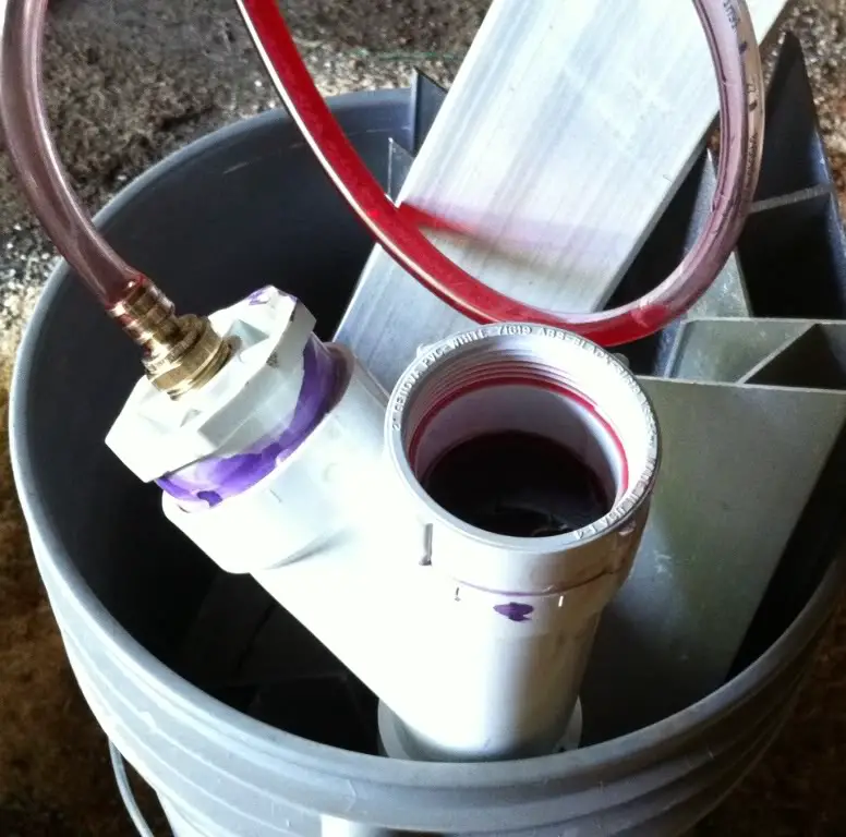

This picture shows the level of the fluid with one quart of fluid in the tool.
Finally, a not so great video that shows how it works - note that I am trying to hold the air gun and tubing while trying to video this... so the air leaked a bit at the gun and the valve stem. This made the transfer slow as compared to normal.... When using both hands air leakage is minimal and the transfer of one quart takes about 10 seconds. :thumbsup:
