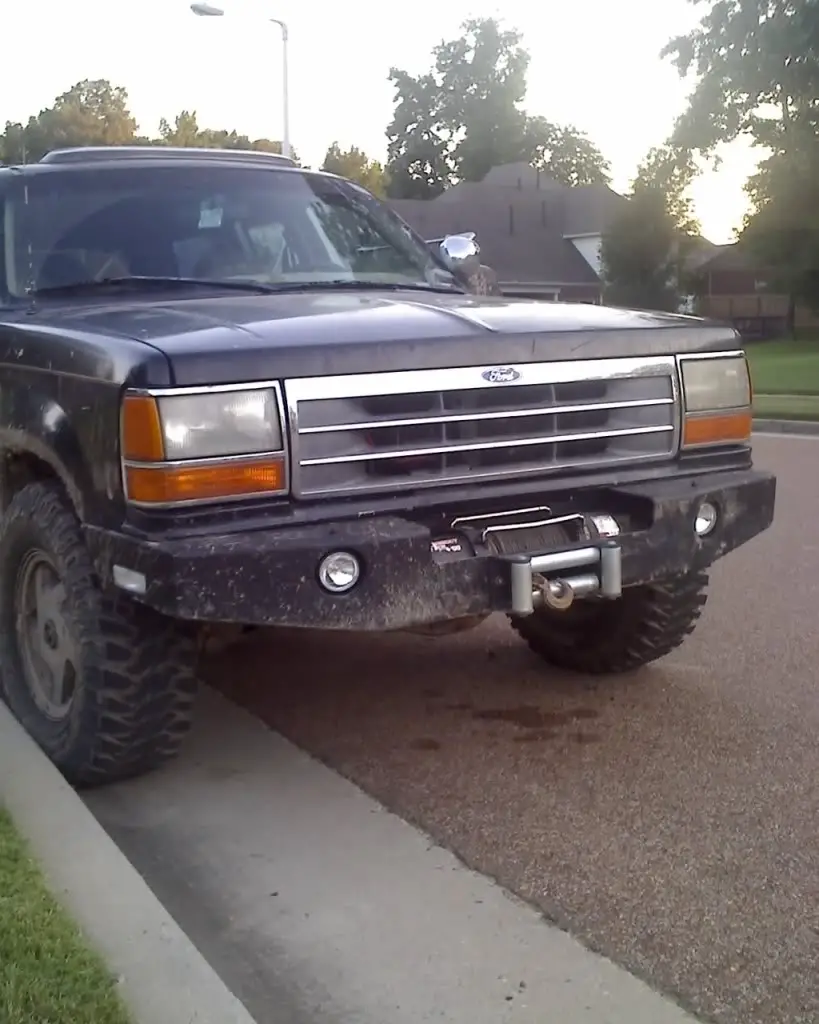

You can see the mounting brackets in the pic where it's painted on the sawhorses, I welded a section of 5"x2"x.25" angle into each of those retangular holes in the back, and cut slots so that I could adjust the fit slightly if I needed. I can't wait to see what my plasma cutter does when hooked up to 220v, it ate right through that .25" stuff with no problems at all on just 110v.

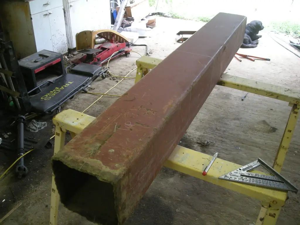

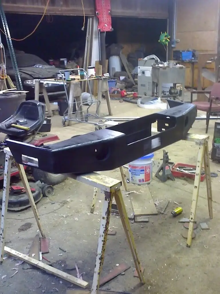

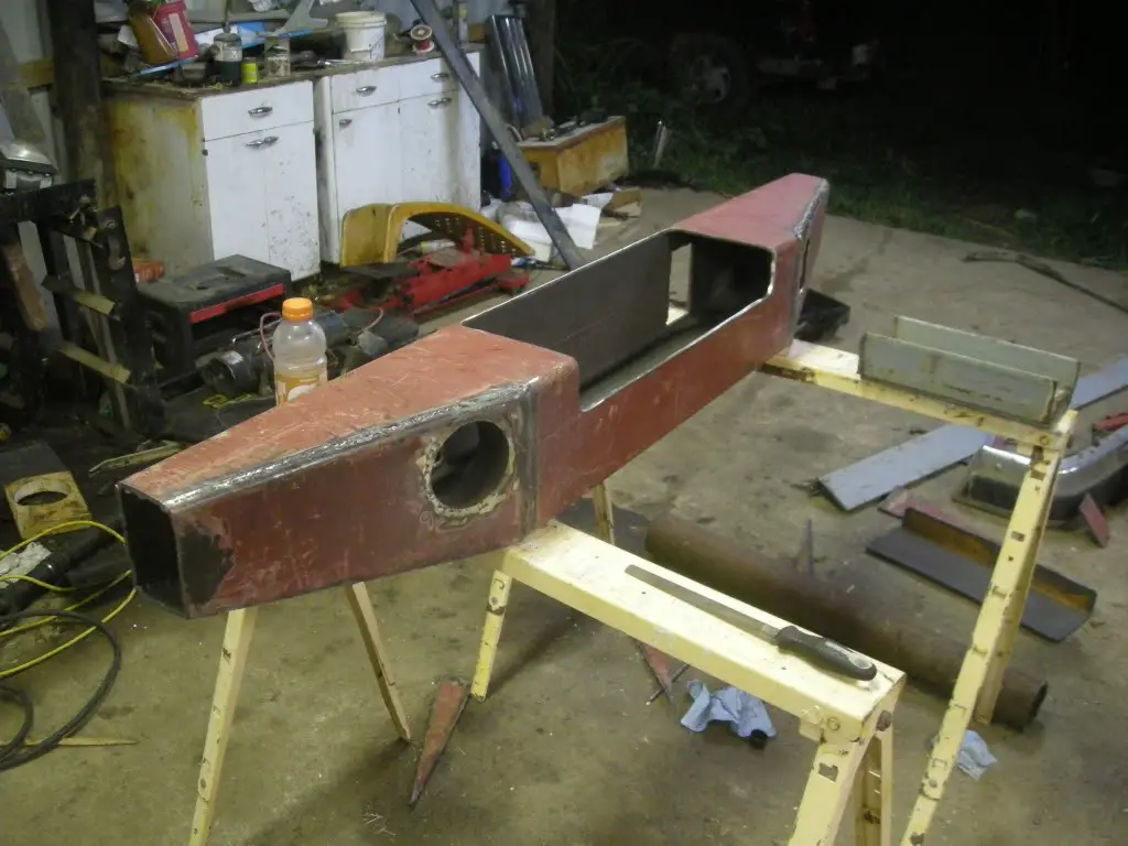

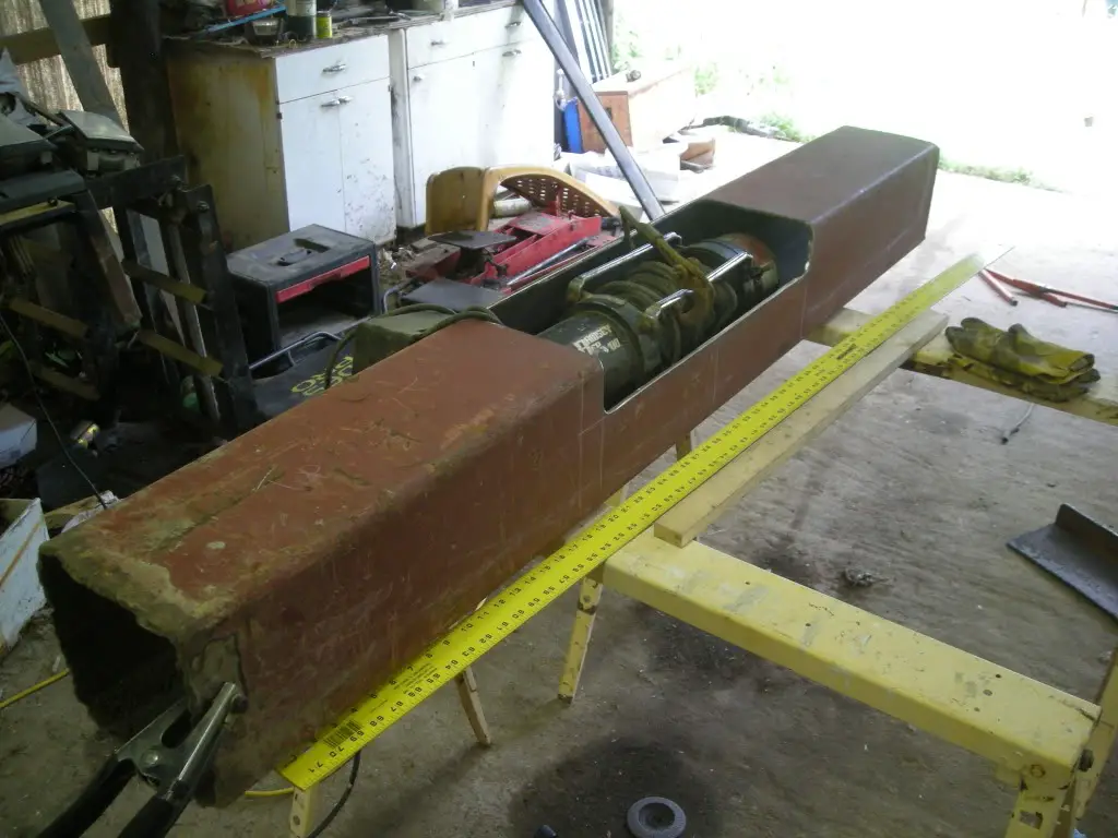

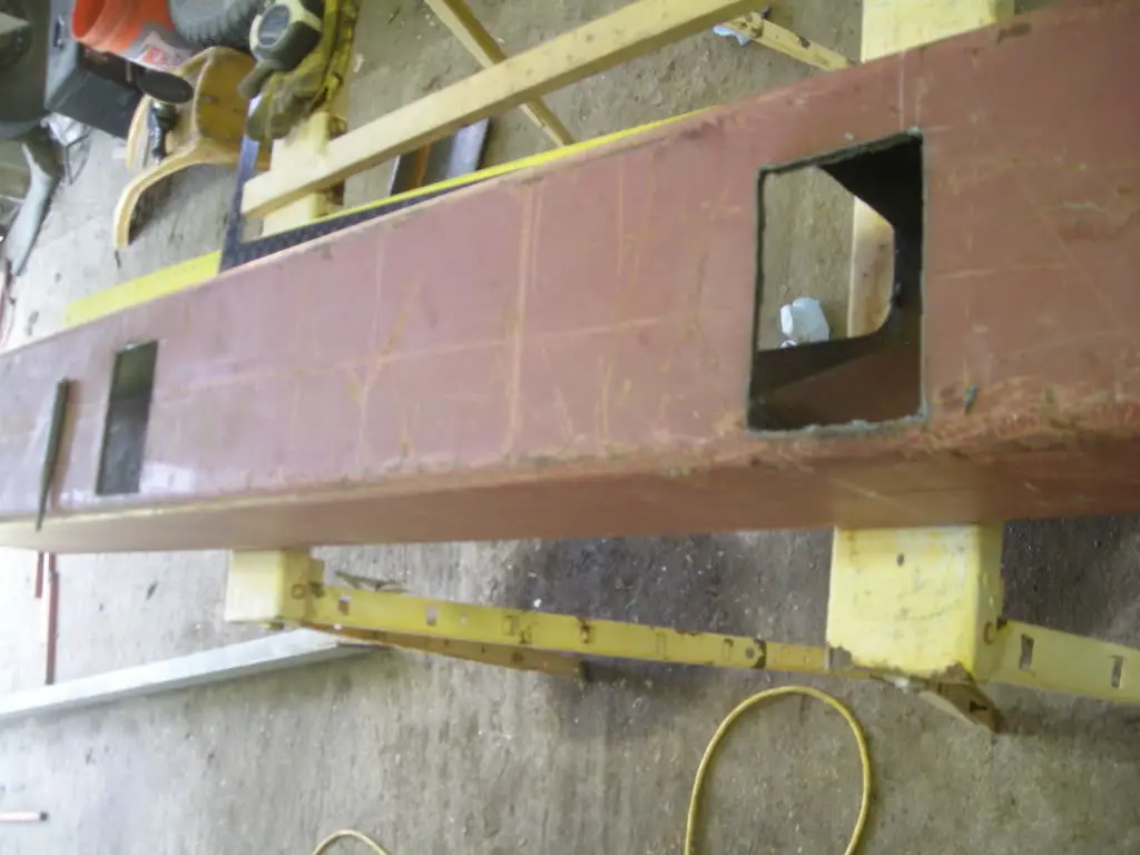

starting point of bumper:

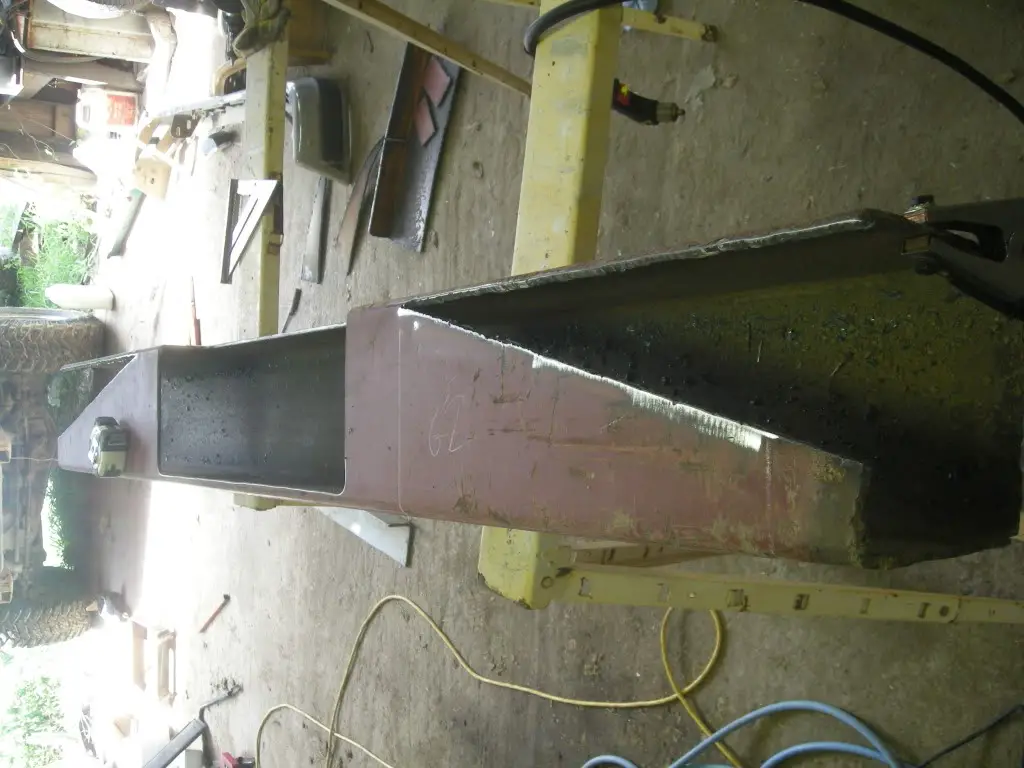

Winch cutout done:
Bracket cutouts done:
Trimming started:
Trimming, body welding and fog light buckets done:
Install mockup:
http://i603.photobucket.com/albums/tt118/black96v6/08-20-09_2332.jpg
Side pieces welded on, painted:
Final result:

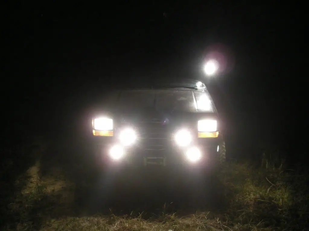

KC lights installed, with GE 130 watt bulbs:
Night pic with all lights on:
Another night pic, this one is with hi beams, fogs, KC's and spotlight on:
GIMME!!
LoL. That has got to be the most awesome and simplest bumper fab work I have seen. :thumbsup::thumbsup:

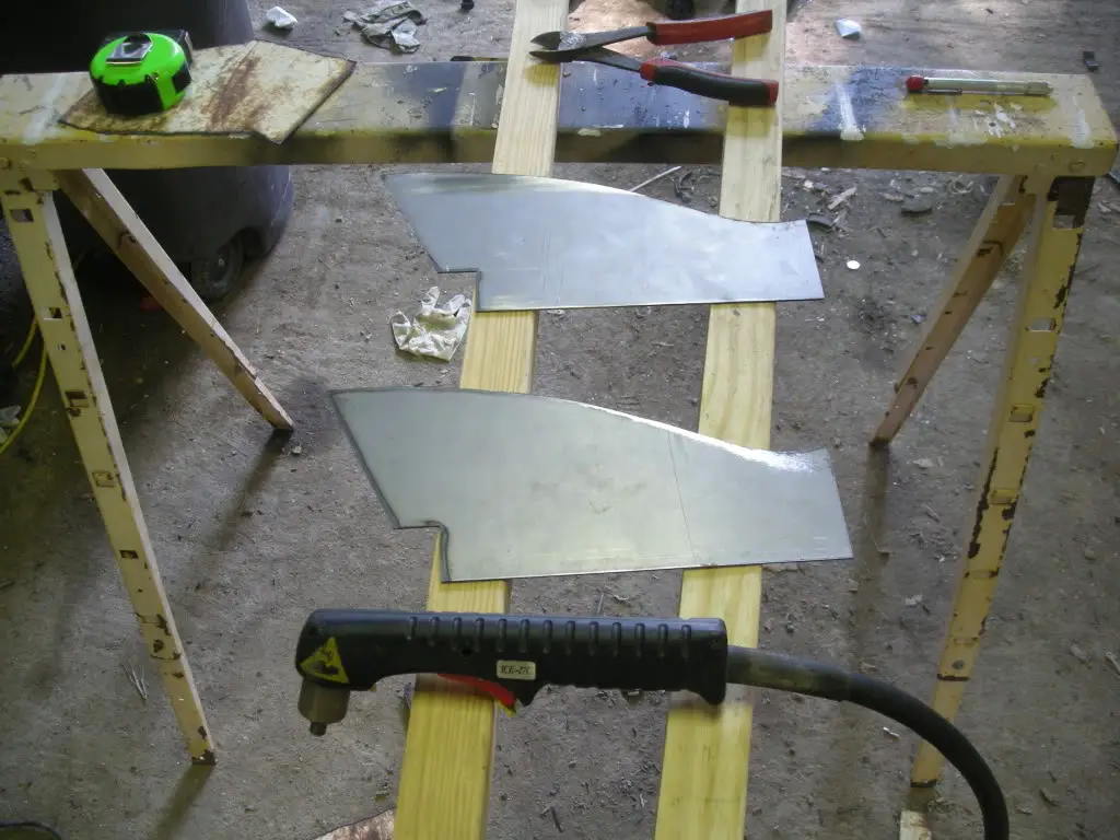

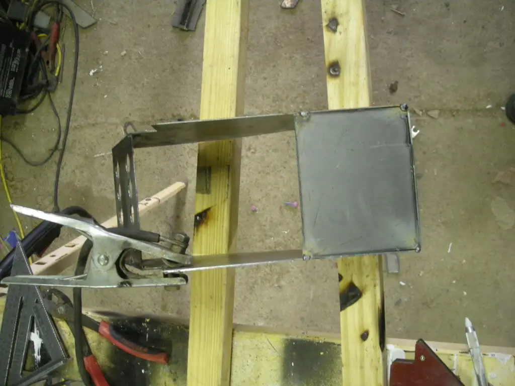

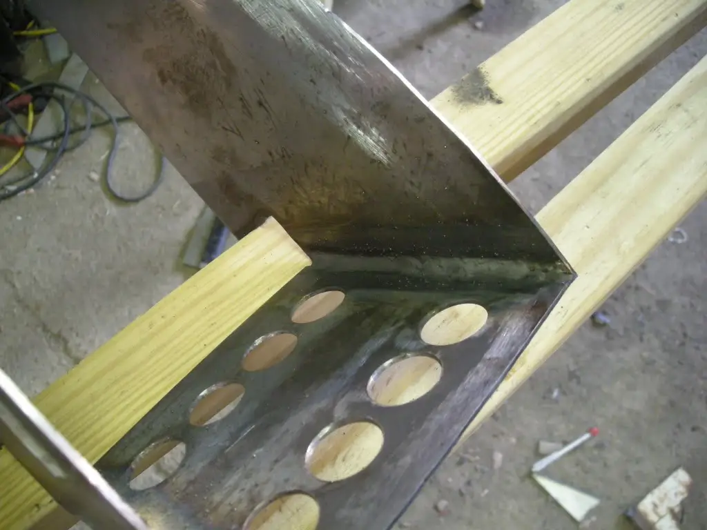

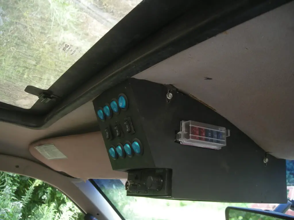

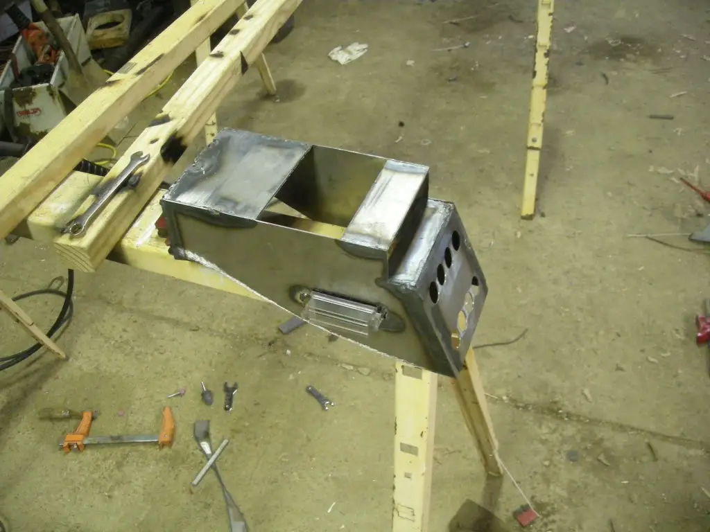

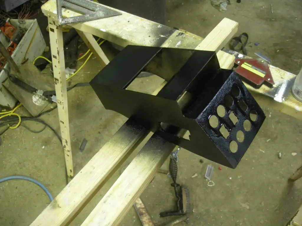

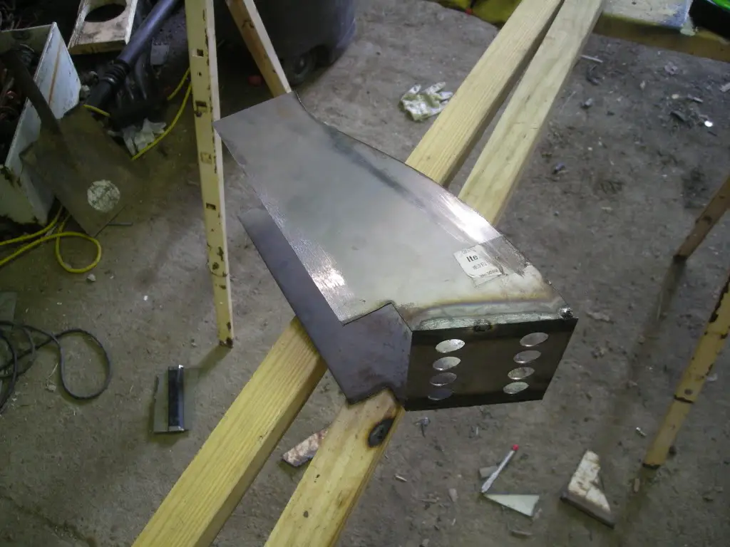

So, yet more pictures. These are of my overhead switch panel. Switch panel cost me less than 20 bucks in materials, made out of 16ga Sheet Steel.
Side panels cut:
Switch face cut, drilled and welded in:
Bottom plate cut and tacked in:
Fuse box hole cut and box installed:
Filler applied:
Painted:
The bottom slot is for my CB radio.
Installed. Notice the fuse panel in the side for all my accessories. Makes changing fuses sooo much easier.

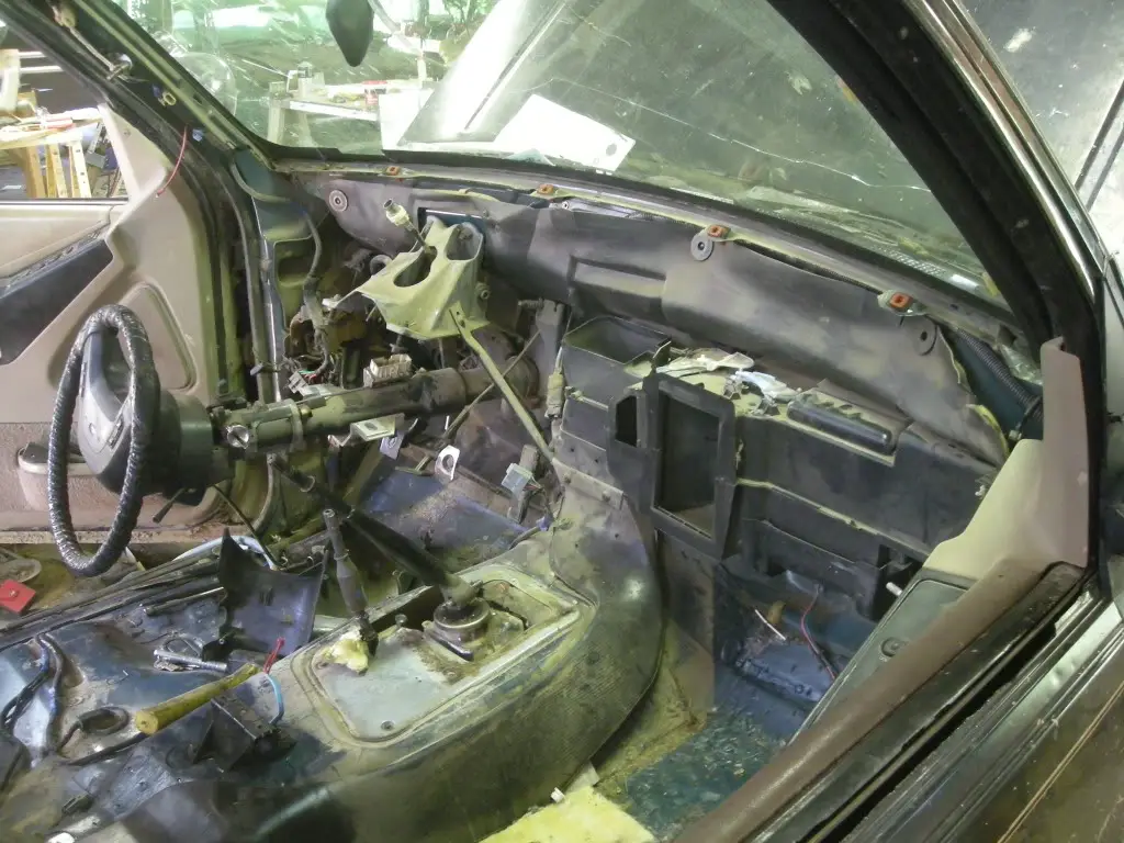

My Ex with no interior:

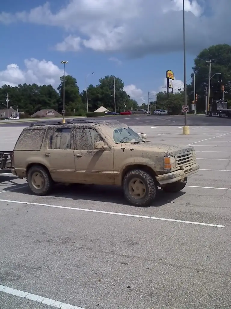

An old, really muddy pic I found:

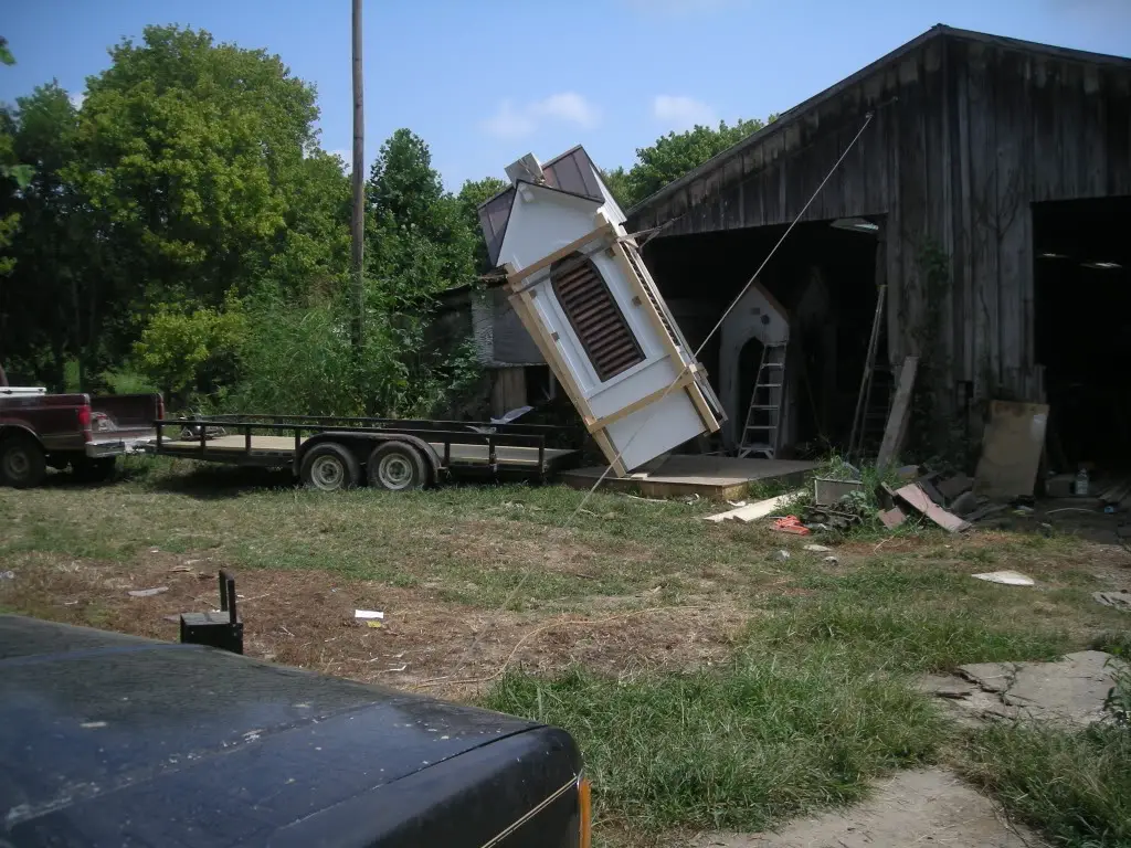

Something kinda neat. I may have said something about it earlier, but the family business is construction. The latest project has been a church steeple. After building this, we had to load it on the trailer to take it to the church to be installed. We did this using 2 winches, which you can see the picture. One is on the front of the trailer, the other on my truck. The one from my truck runs to the building, and through a snatch block, whereas the one on the trailer runs directly to a chain wrapped around the crating around the steeple. As one was let out, the other was pulled in, slowly lowering it onto the trailer. I thought it was a pretty unique use of an explorer.
