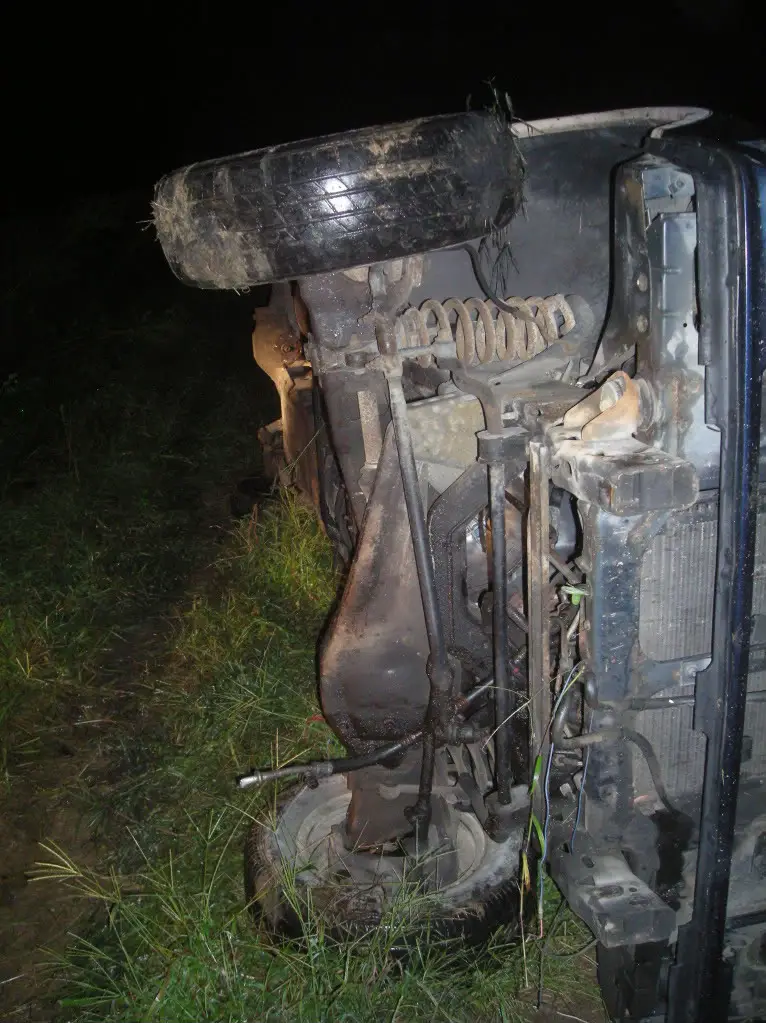

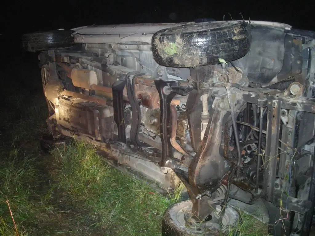

Then, my rear u-joint on my rear shaft gave out, I noticed a bad vibration at anything over 25 or so, and the culprit turned out to be this messed up joint. This, however, was an easy fix, as I winched the parts car over onto its side and pulled the shaft. :D (have pics, will add later)

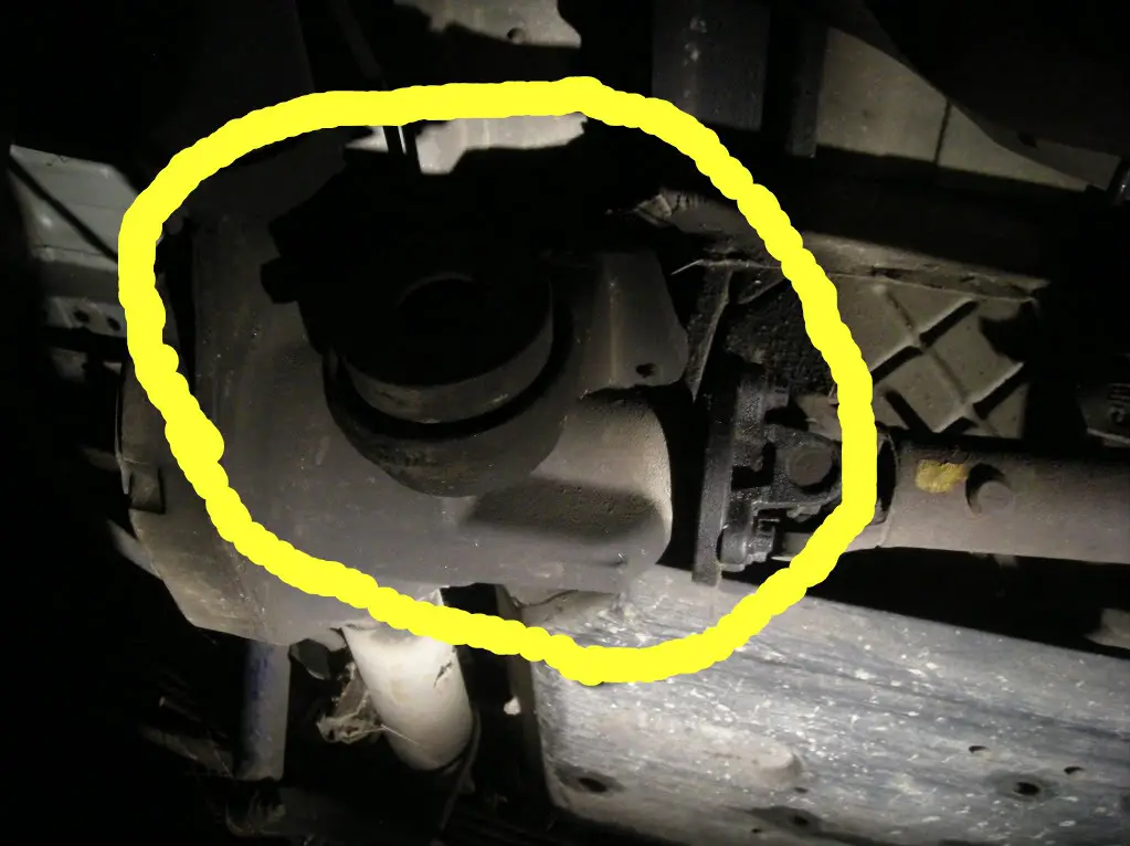

Does anyone know if the vibration dampner in the circle does anything? My truck does not have one, but the axle housing has the flange for it to mount to. I don't want to bother putting it on if it serves no real purpose.

My 91 doesnt have the vibration dampner thing on the rear end either but it has the holes.
The 8.8 I got off a 94 Explorer I have in my Ranger had the dampner on it when I got it. I removed it and I havent had any vibration problems or anything out of it so I would say its not needed.
Interesting. Thanks for the input. I may stick it on there just to see if it does anything.
It hangs up on things when your wheeling.. :) I removed mine a long time ago for that reason.
~Mark
~Mark
well, in that case.... definitely not going on there! :D

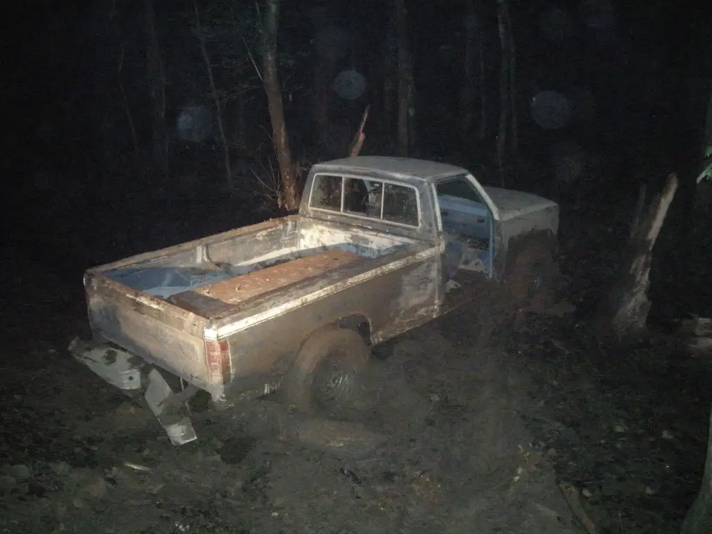

well, more adventures last night, I get a phone call that my brother has gotten his truck stuck. What I did not realize was were he got it stuck, and why it was stuck
That picture is taken from the part of the trail where my ex was, so he was down in a pretty good-sized hole. The reason he got stuck is that the front u-joint on the front driveshaft came apart.
That's a 37" IROK, so you know he's dug in pretty well.
Never a dull moment. With the help of my winch and a snatch block, it came out easily, though I need to upgrade my battery cables on the winch, as they got really hot.

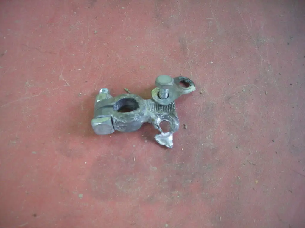

so, did some minor maintenance stuff to the truck, and discovered that the battery cables for the winch were not the only thing that overheated..... I'll let the pic speak for itself.
Umm, WOW. Looks like you need to upgrade your battery cables. I wonder if running a second battery just for the winch would be a good idea?
yeah, what I will probably do is get a battery with a larger CCA rating, with both side and top post terminals and hook the winch up to the side posts. I plan on running a dual battery setup, but the aux. battery will be in the back of the truck.

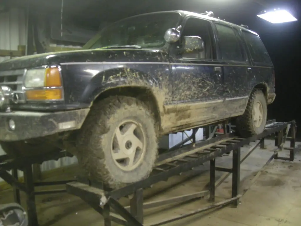

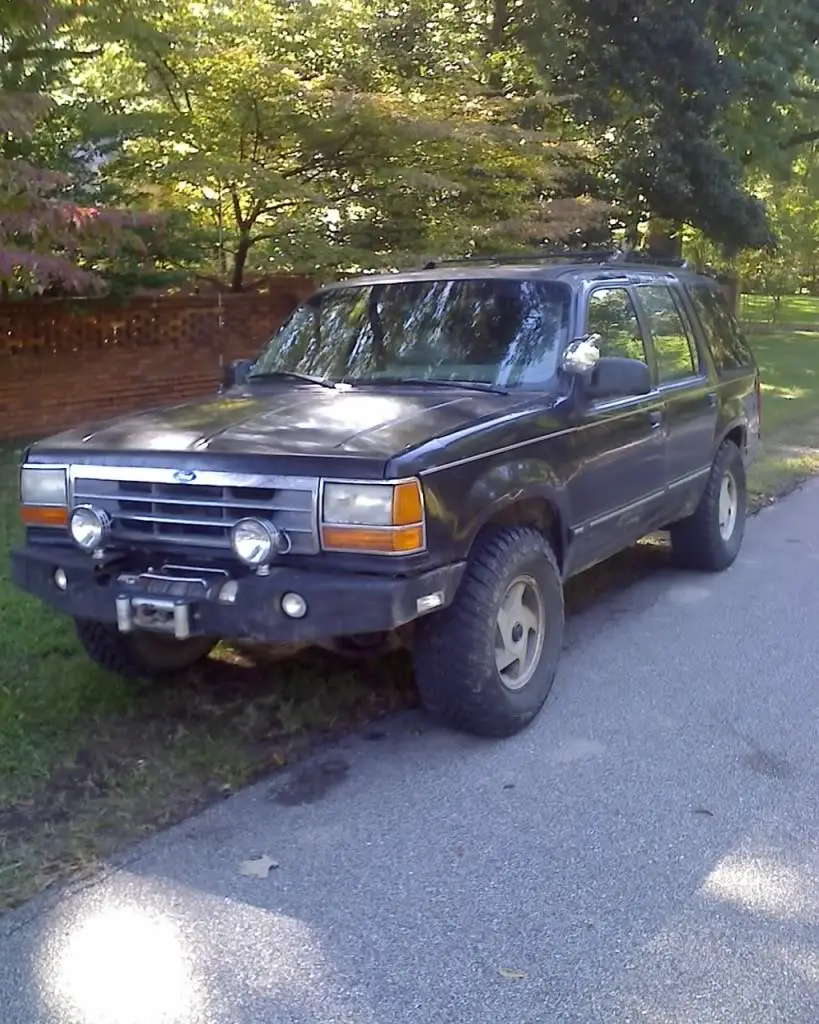

well, due to it being midterm, I haven't done anything to the ex other than drive it, which is rare, but kinda nice. Did wash it, which does not happen very often, and it turns out that it looks pretty good when it gets somewhat clean. (Pay no attention to my 3 different pinstripe patterns....)
