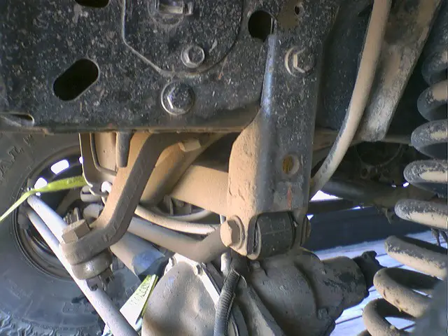

Looks good. Its a great start. I would say Zainy has some good suggestions. Also when you address the steering make sure your trac bar is the same angle as the drag link. Move the mount up on the axle end.

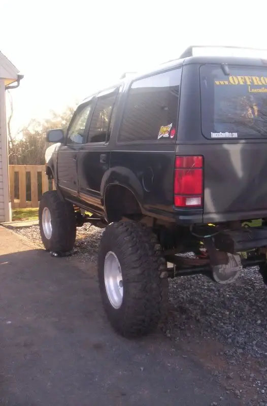

Hum, thought it was a 3" body lift, still looks too tall to me, but again that's personal preference.
no i may have posted i had a 3" body lift, and origionally it did, but i took it out and put a 1" in instead. it is very tall i must agree, they are 3.5" full size bronco coils, my 5.5" cols are on the passenger seat. the coils in the truck on the ground measure 17" compressed
Your build is coming along nice. I used several of the same components on my white truck (see it in my sig)
I used the same track bar bracket, but got creative. 2 things to look at in this pic.
1. I grooved out the bracket to contour the frame and flipped it around to get lower
2. I added a brace to the engine crossmember, I know of 2 trucks I have wheeled that have done this and never had in issue with the track bar bracket getting ripped from the frame (I remember back when SAS's were becoming popular and it was a common problem)

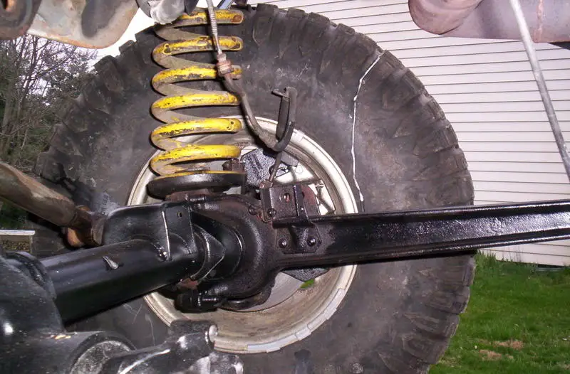

Here is a pic of my trac bar mount. It has changed a little since then because i needed to add some more blocking to move it out a little after i lifted it a little more.

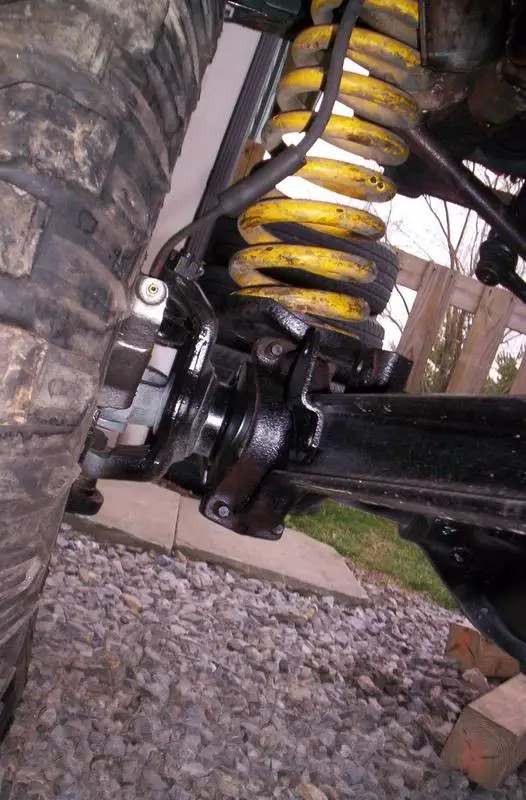

well i got my crossmember in for the trans, got my rear perches redone, cut fenders out, painted all of drivers side frame, rear springs, front rear. pull all old brake lines off, redid all the hardware bolts i went alot bigger now that everything is in place.

front brakes done!
all breaks bled!

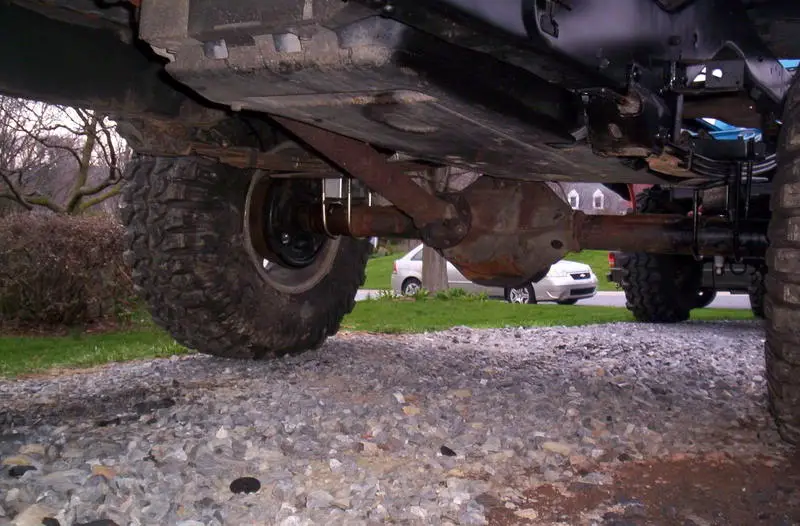

rear shaft in
used the origional brake lines for now

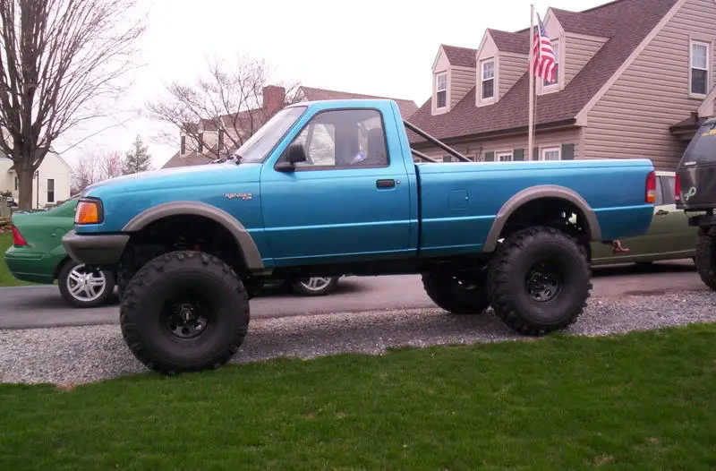

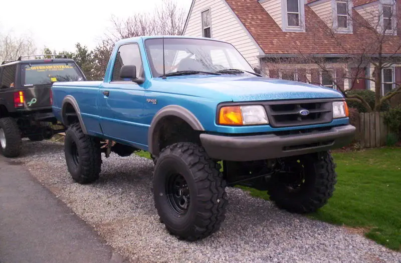

dads 96 2.3 ranger with 5.13's front locker, rear wleded, 3" body 4" suspension, 35" tsls
his cage
