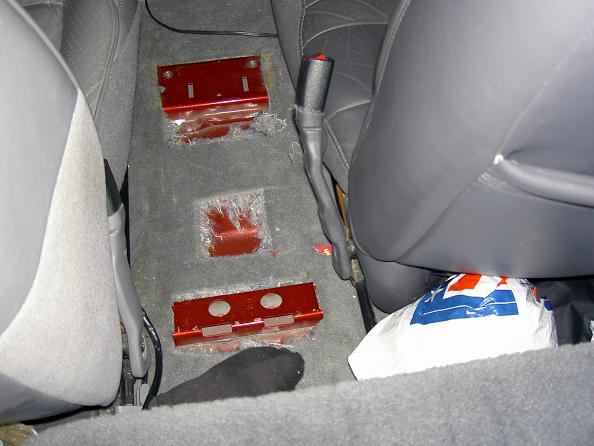

The rug covers the access panel under the console. It has a bunch of tiny bolts around the panel. So you end up pulling one of the seats as well as the console. I'm sure some have cut through the rug to avoid the seat R&R. Below shows the mounts for the full length console. After removing the front and middle bolts(4), the console pulls rearward to unhook from the rear bracket.
I slit my carpet right down the middle, no need to pull seats, witht he console replaced the carpet cut is hidden
4ea 8mm bolts hold the access panel down

here is a huge pic of the center console covered access panel
Holy cow...that is a big access panel. I will try it. Thanks for throwing in the pic.
