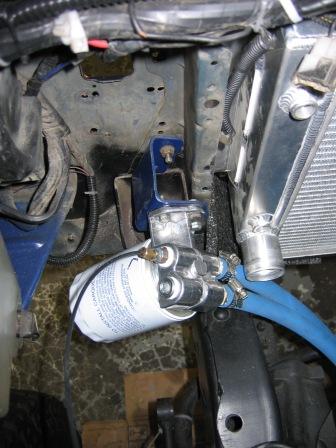

We all have projects, that will keep us out of trouble. I had a short "L" shaped piece made for this with the elbow fitting pointing to the right. They couldn't make the bends short enough, so I have the elbow pointing down now. I need a longer steel line made to sweep down and back up to the top. It is very tight back there. I'm being as careful as I can so that I don't end up with any leak. A leak in a fitting back there would not be good, just like a rear seal leaking.
This will give me another oil tap, and I plan to have two sensors mounted on the firewall. It also will give me an oil source for a turbo.

oh wow! On my BII I used the canton oil filter adapter, I remote mounted my filter with a 4 port filter mount (FL-1A) one line in, one line out, 3rd port = oil pressure gage fitting, 4th port is currently blocked off
a VERY nice solution for getting more oil pressure ports without tapping the block or burying them
