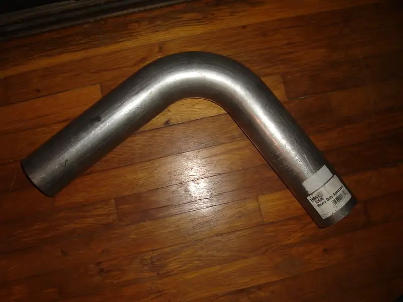

Well im going to start off with the picture of the actual pipe i picked up:

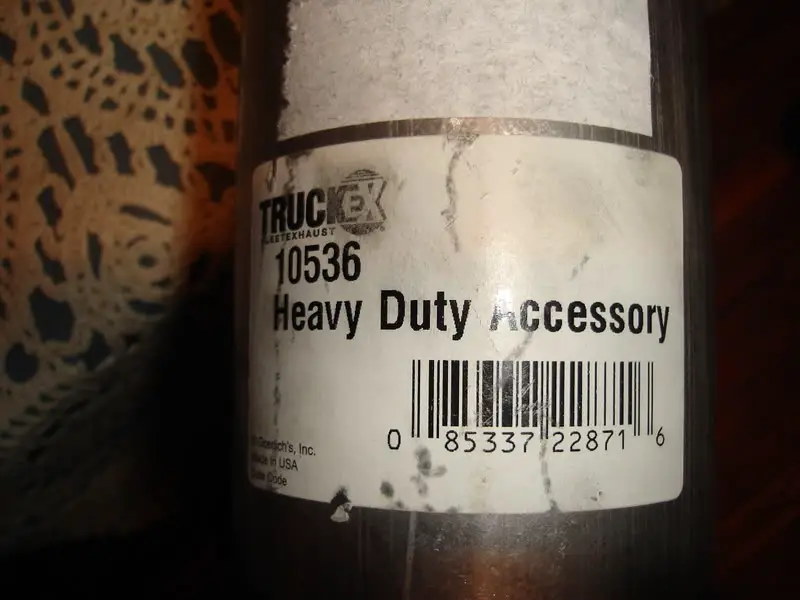

Here is the label on it for a part number if you would like to pick it up right from Car Quest:

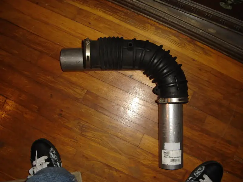

I put the stock pipeing ontop of the pipe and marked it like so:

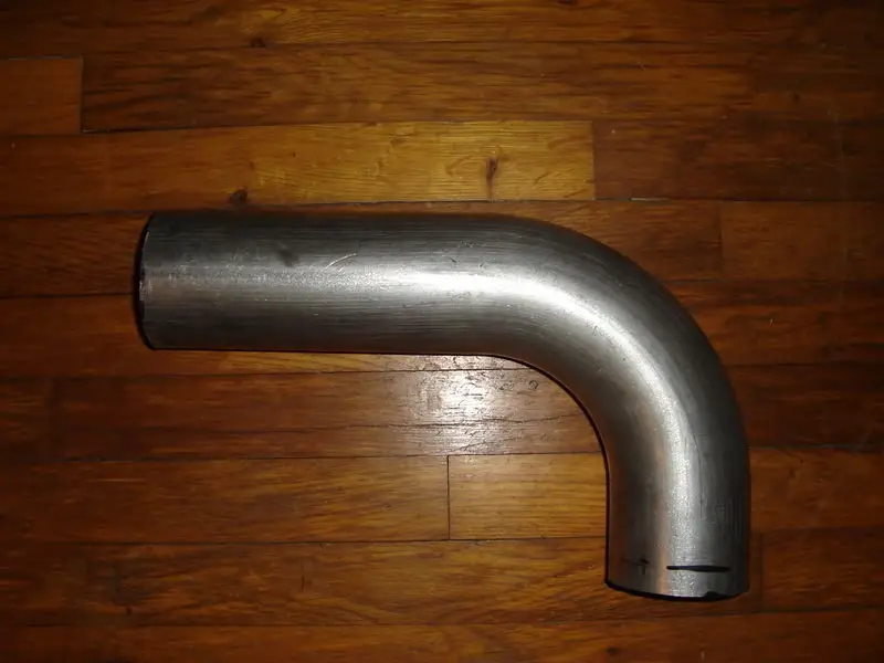

Came out with this, i actually left a little more on the side that connected to the MAF so it went a little futher away:

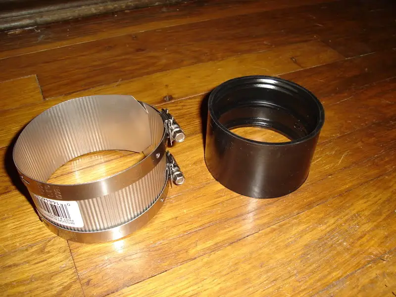

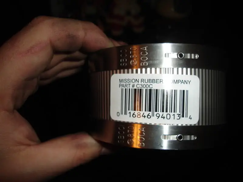

Now here is the picture of the couplers i got from Home Depot:

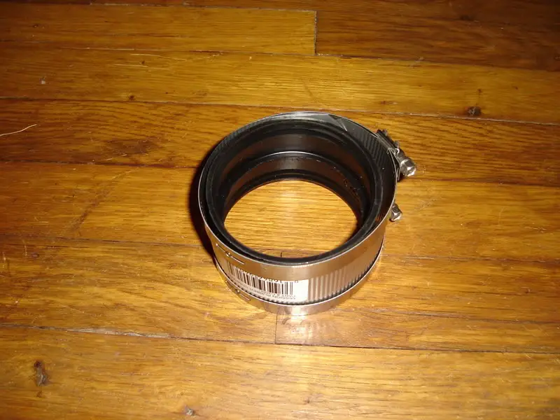

A picture of the label, its basically just a 3 inch coupler with that has metal around it, you really can't miss em:
All i did was pulled them apart from each other

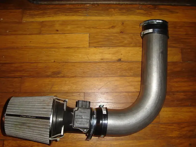

Put the couplers on and the MAF on with the air filter, the clamps are 4 inch hose clamps:
Before and after:
Finished product, ofcourse you can paint it...i will be paint matching it to the truck as soon as its a little warmer. I also advice you head on ebay and order a MAF adapter for the MAF so you can attach the aftermarket filter:

The IAT on my truck has to be built into the MAF because there was not one in the stock tubeing. If you do have a IAT you drill a hole for it, then get a ruber gromet from a auto store and put the IAT in.
The breather tube is off, i replaced it with a filter. If you want the breather tube back to the same as you would do for the IAT.
The zip ties hole the filter into place, im waiting for my MAF adapter...
