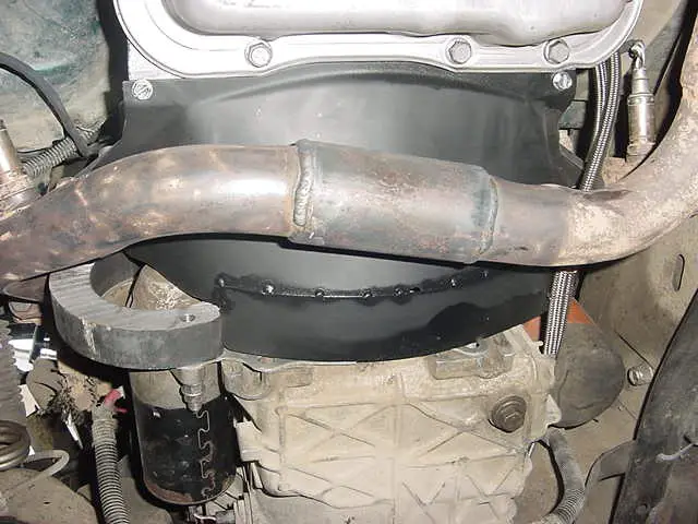

EXHAUST
Yes, the exhaust will need to be slightly modified. The bell housing on the 700 is a little larger than the old A4LD. On stock exhaust, the y-pipe needs about 3 more inches added to the center of it.
