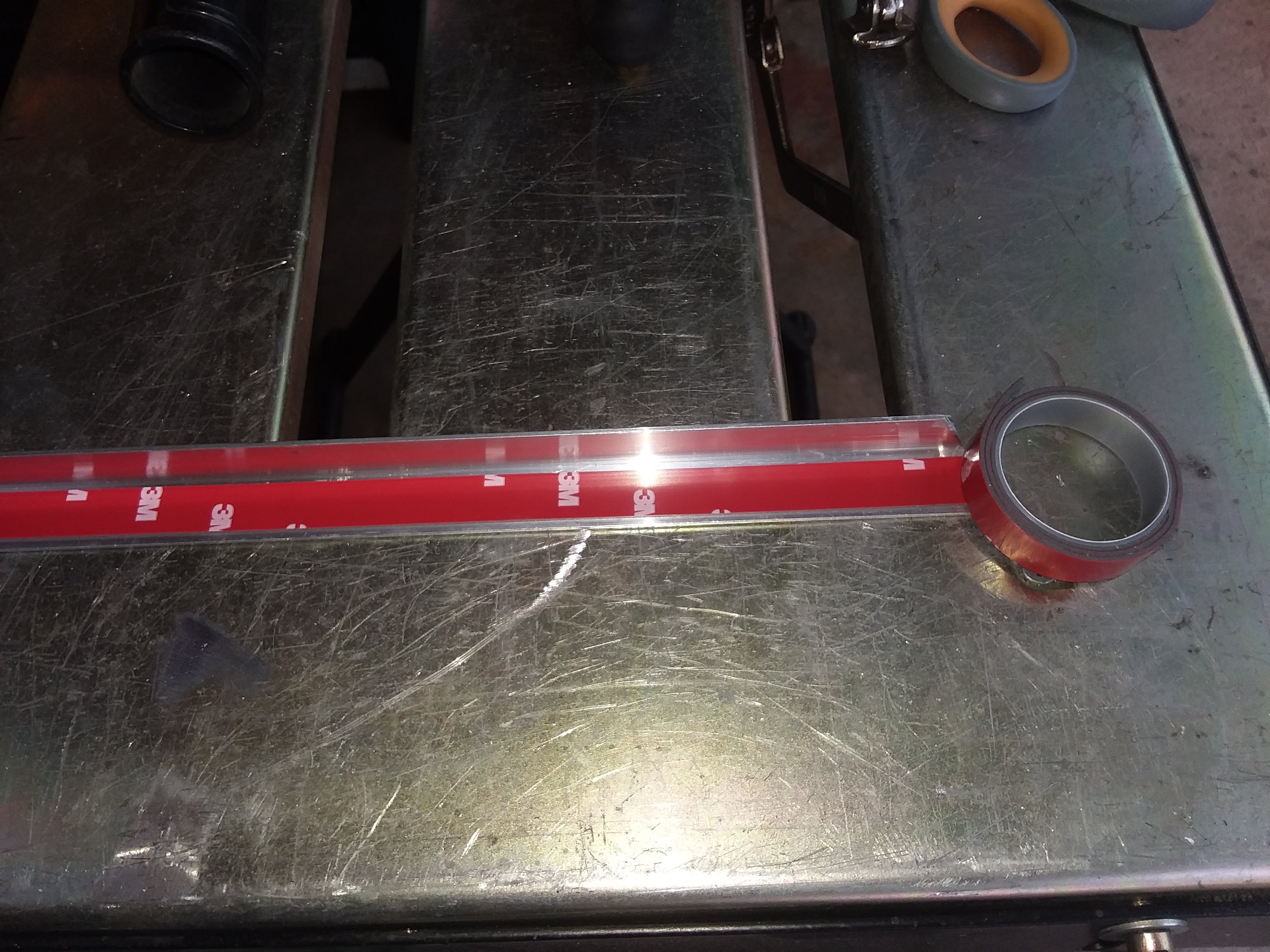

So on Monday, I started to trim the Dr side box. Did a bunch of head scratching, cut some aluminum angles, and using 3m auto badge tape, got that box done. That took me all evening.
Fast forward a day, and realized I had a made a mess of this thing, and spent a couple hours with the air gun and shop vac. Lots of metal bits in all the nooks from working on it. Decided to lay some beads of black silicone on the interior walls and lower frame rails. Sealed it right up, and let it set up overnight undisturbed.

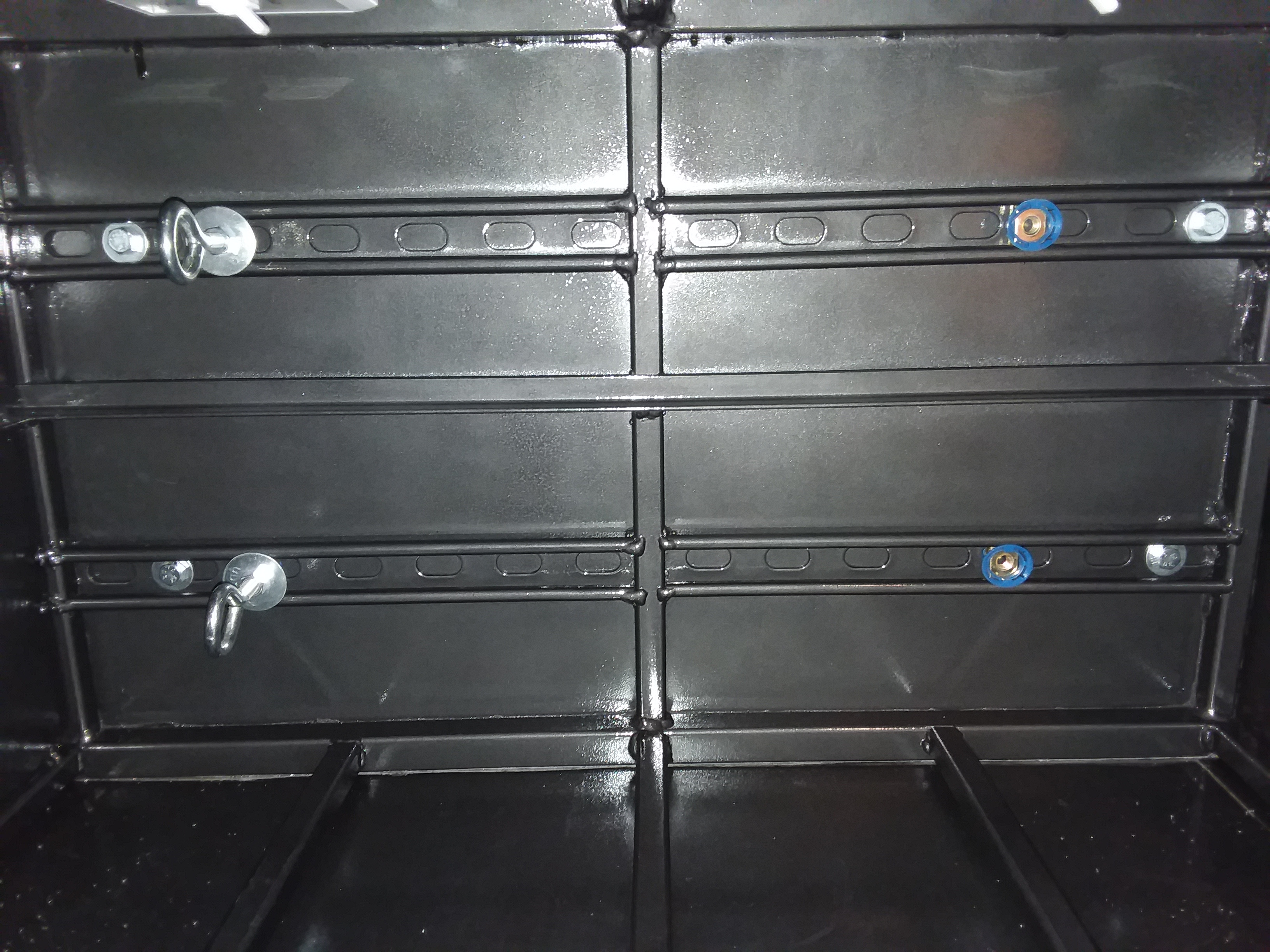

Put in the strap tie downs. These are adjustable, and can move side to side across the box. I am going to cut these 1/2" eyebolts down a couple inches eventually. Left the right ones off, so you can see the special nuts used in the unistrut channels. You push them in after loosening the bolt, then slide them where you want, re tighten the bolts by hand, good to go again.

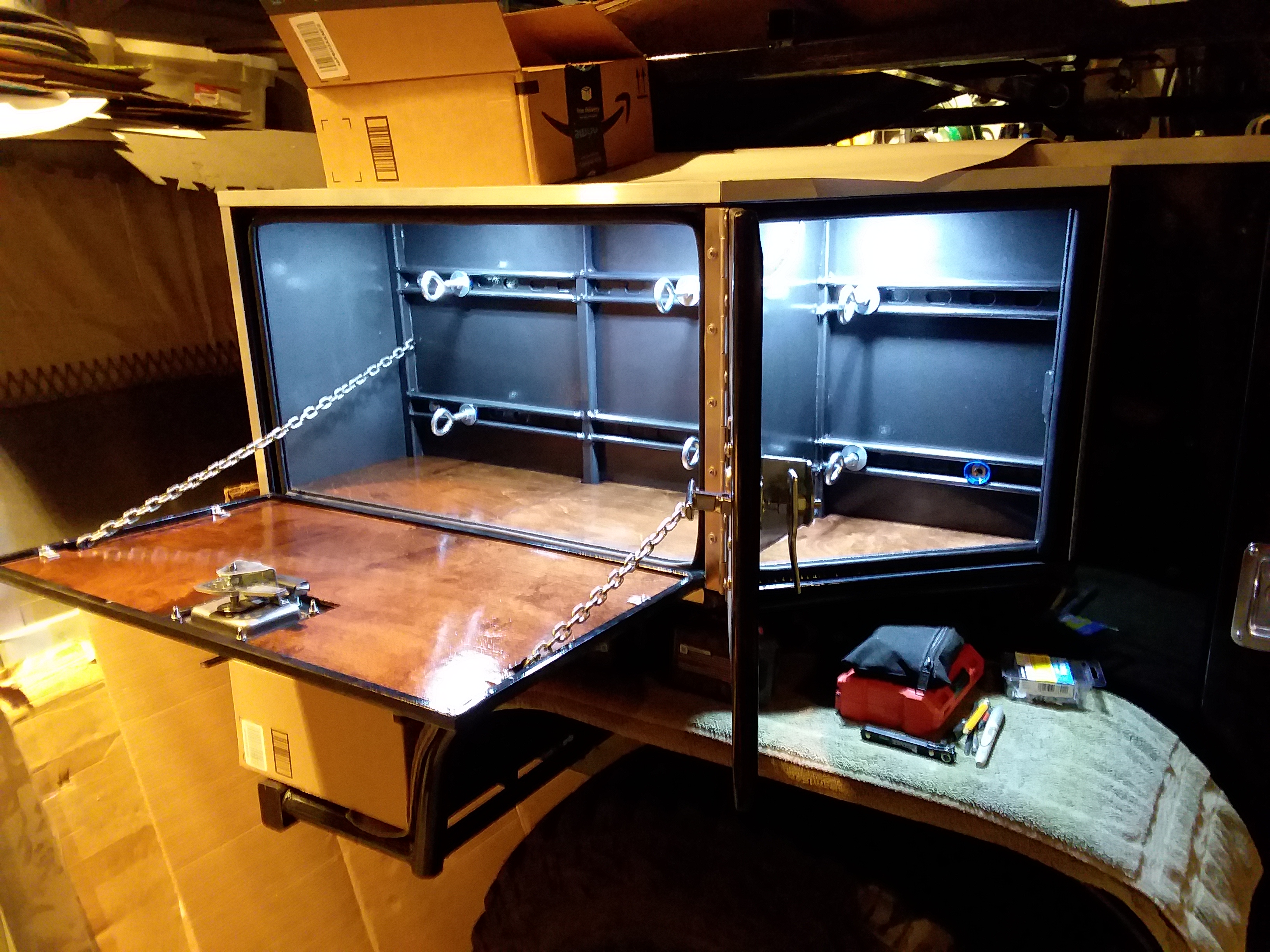

Installed some chains on the doors. Small door, the chain is small, and only meant for a stop. The bigger doors however, they got some beef chains to hold the doors flat, when opened. These will be used as tables for various things. I am going to line the back sides of these box doors with something, probably 5 ply 3/16" Baltic Birch. That's down the road tho. These doors should be able to hold 50 lbs easy.

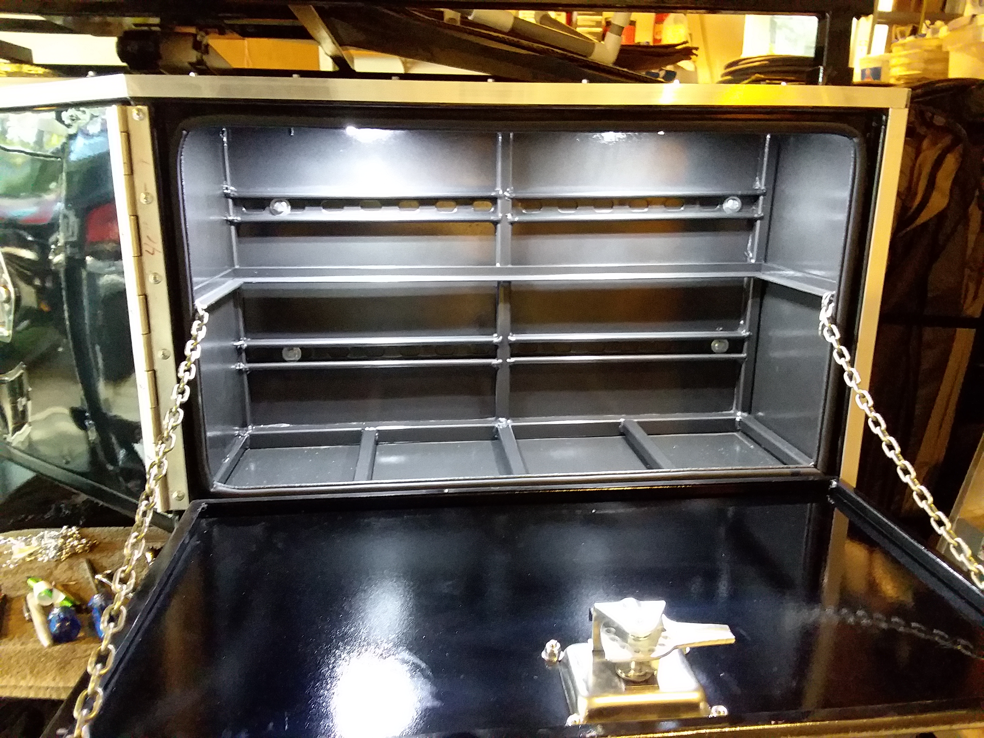

Front compartment done
Main compartment almost done (minus shelf, floor,and door liner).

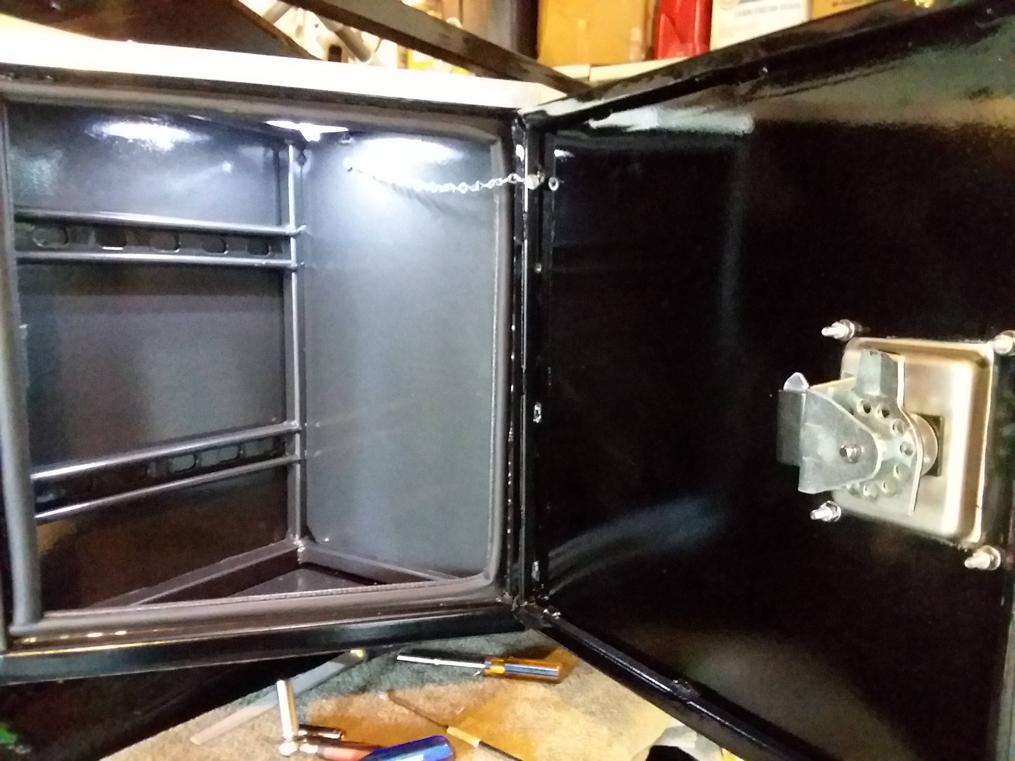

Oh, played hookie after lunch, and spent 5 hrs getting the pass side box done. :D

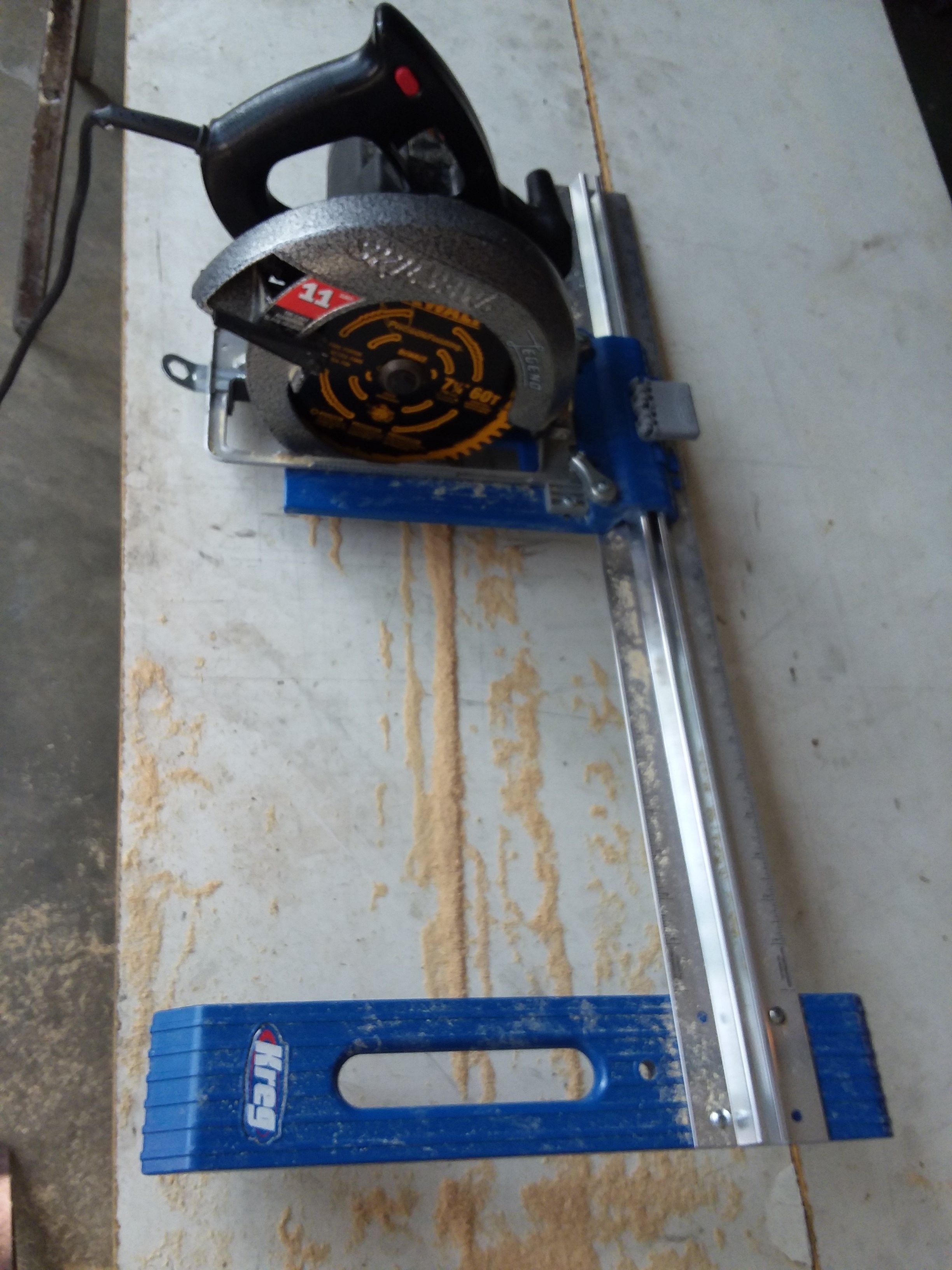

Picked up some Birch & Red oak, and got to use my rip saw attachment. Pretty cool gadget, that takes the place of a table saw. Slapped on a fine 60 tooth blade and cut some stuff up.
Had to use a jigsaw, drill, orbital sander, dremel with routing bits, to make these. Got everything fitted, and installed with custom brackets, then took it all apart, and stained everything Red Mahogany. Sticking with the classic color choice here.

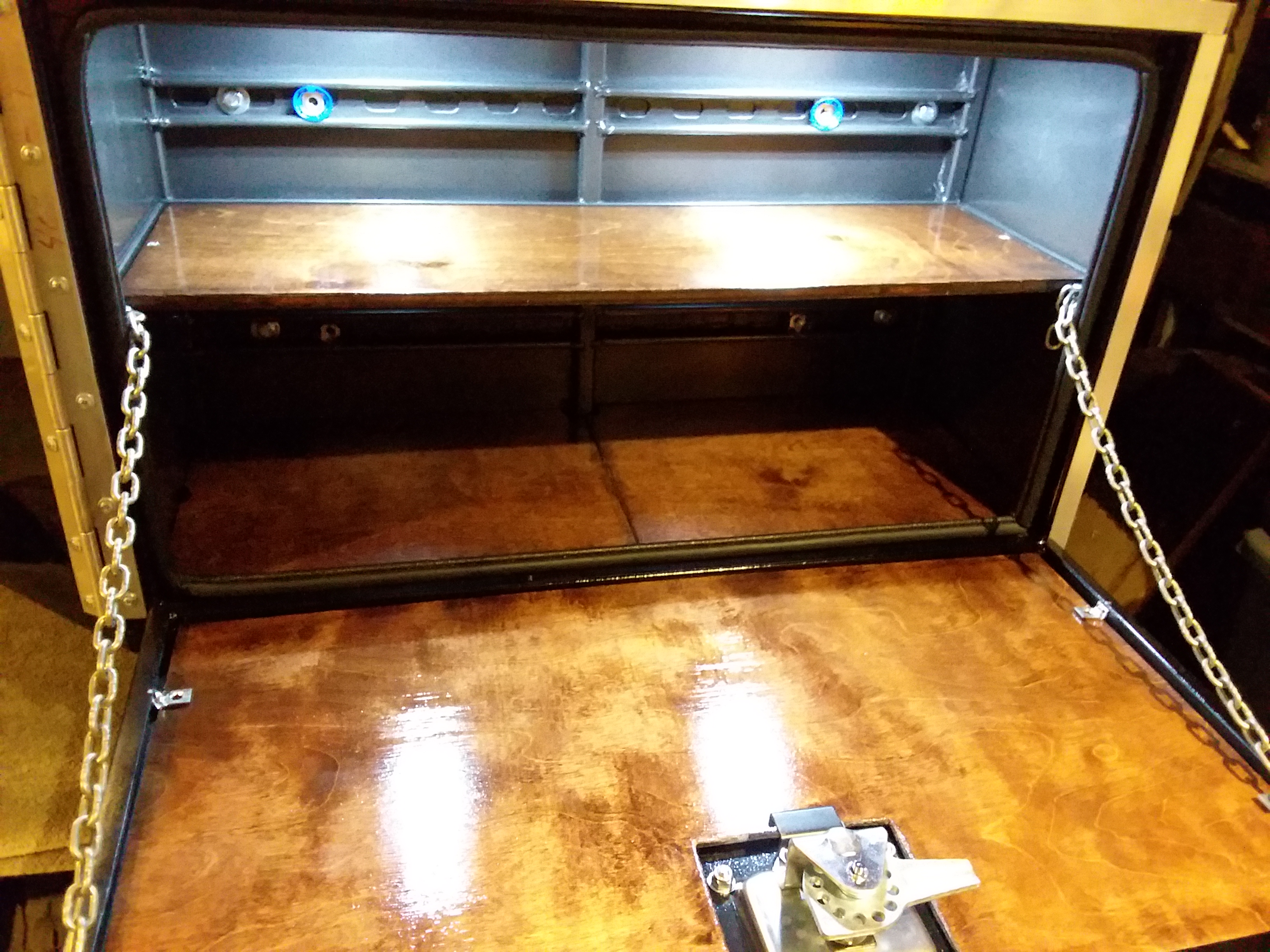

All wood is installed. Stainless hardware is all recessed, except the door skin brackets.

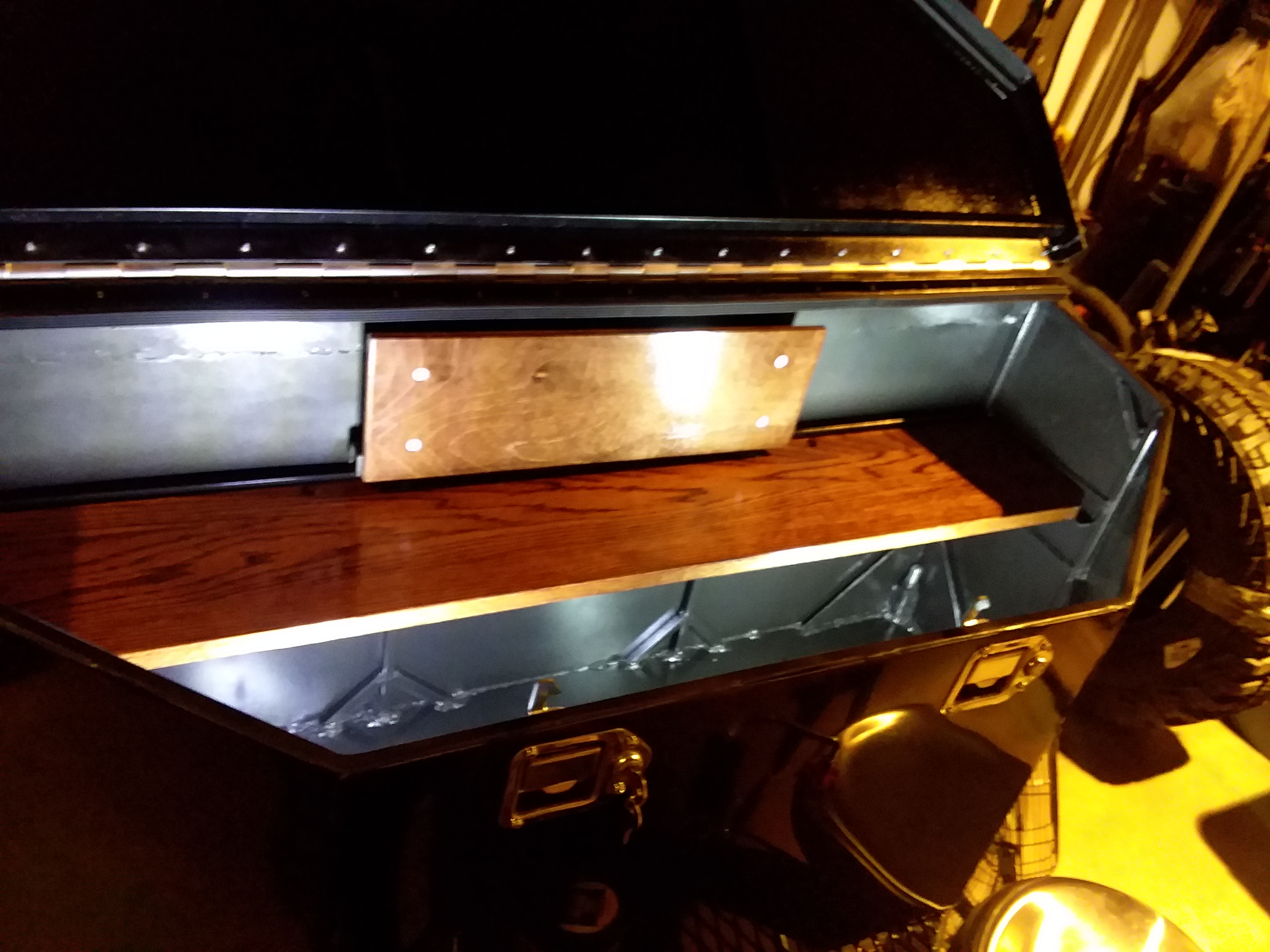

Tongue box
Pass side box
Dr side box

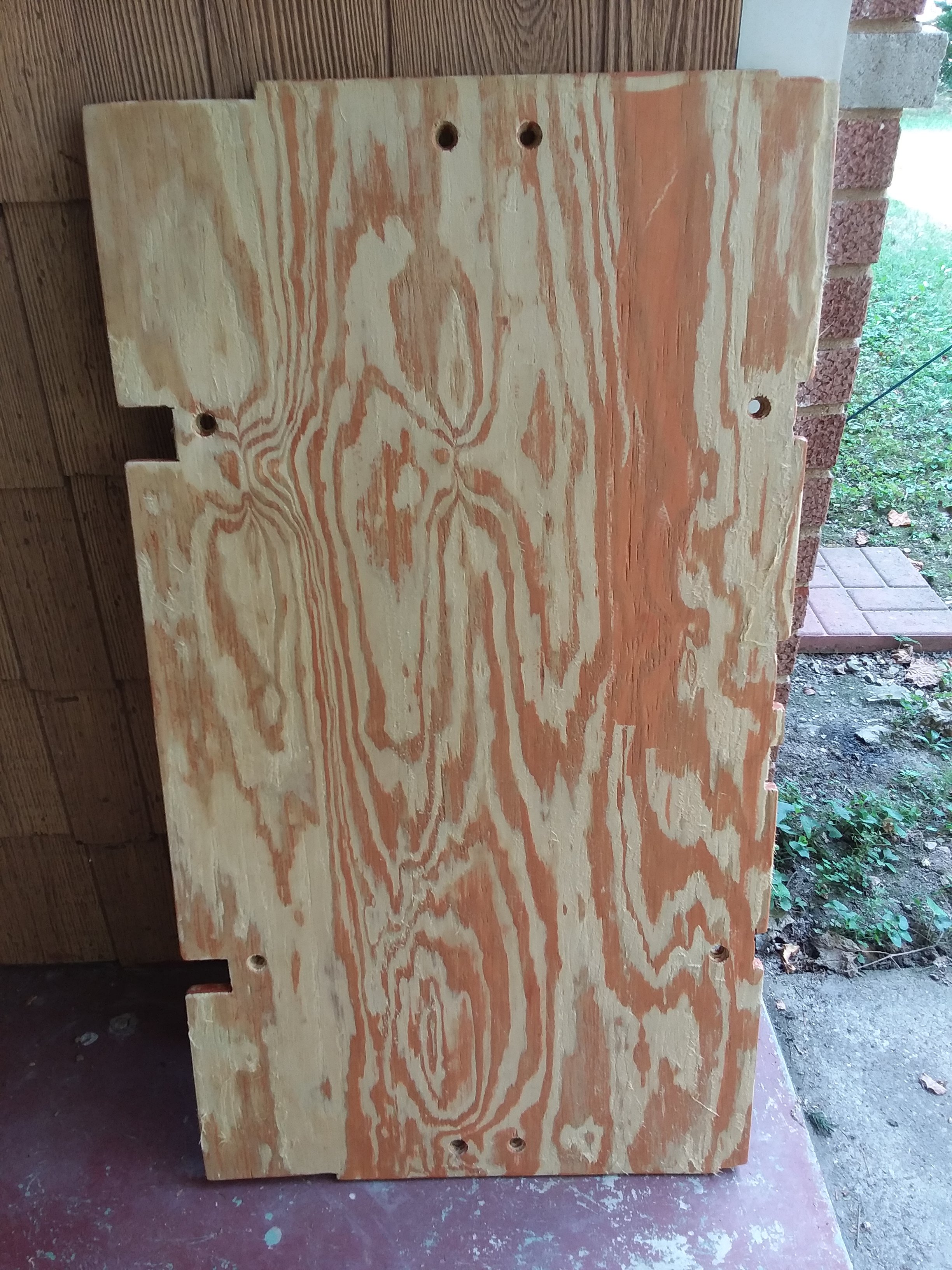

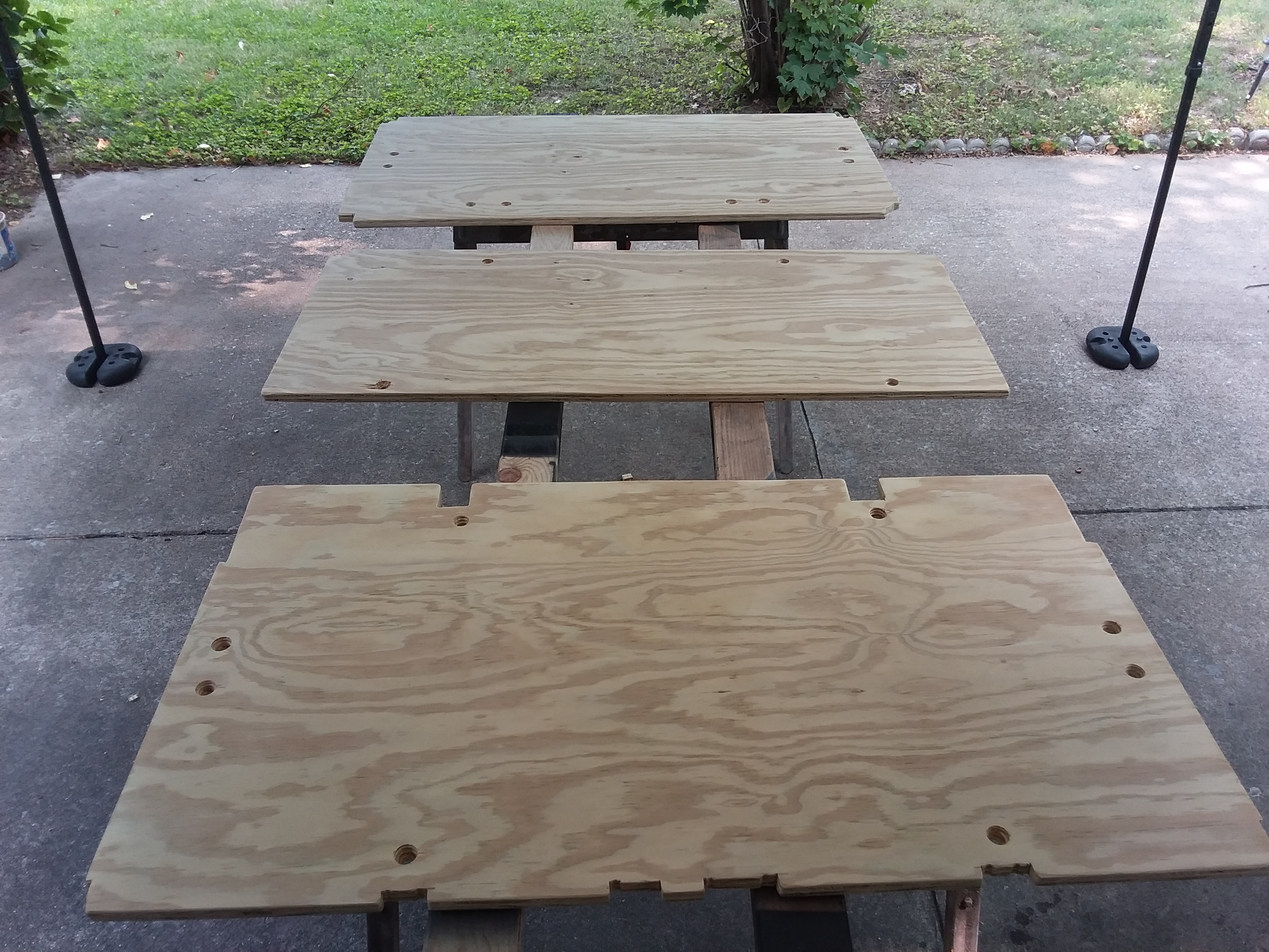

I went after the interior flooring. 3 months ago, I bought a full 4'x8'x3/4" pressure treated deck board. It takes this long (3-6 mo's) to dry out, sometimes more. This one was pretty wet/green when brought home, but the high temps sped up the dry time.
Knowing that the rear opening is smaller than the actual flooring is, it had to be made in a couple sections. I added extra floor brackets long ago, just for this. So with a bunch of in/outs of the wood......heh.... made myself laugh.....anyways, one pc at a time was marked and cut one edge at a time. To get the edges on top of the frame rails around the perimeter, it had to be notched for all the vertical box tubes.
Once all was made, and put in place, all the mounting holes was drilled from under, thru the bracket's 1/2" holes. Creeper worked perfectly for this, with 25" of clearance. Removed them, made the countersinks, and then sanded both sides. Back side just a simple knockdown, but the tops, was sanded smooth, and all marks/dirt/ink was obliterated.
That took about 6 hours yesterday, in the heat, with the vampire blood sucking insects, biting flies, ants wanting me for lunch, and these damn little sweat bees stinging the crap out of me. I look like I have chickenpox right now. Bug spray doesn't work, or they have become immune. Ugh!!
Today I started to put on the decking stain. Did one pc, and watched it dry to a nice freaking orange. :( Ok, 20 mins with the power washer removed it all. Can't touch this pc for a couple of days for dry time, and another quick sanding. Bummed...
So after searching thru a few piles of receipts and 1 hr later, I couldn't find the one I needed to return the natural cedar stain (puke orange). Day turned into a booger, and the biting bugs are still attacking. After coating my legs with clear anti-itch stuffs, off to the store I go. Couldn't find jack diddly to my liking at the big box store, and paint stores was closed on a Sunday. Hmmm....After stopping for a late lunch, I had a minute to think on this.
Ok, full belly, and feeling better, I decided to just do the flooring like the box shelving. I had enough stain left, just needed more Spar Urethane. Back to the big box store again. Set up the 2 dry sections that was ready to go, and got them stained both sides. Thats as far as I can go today, due to waiting on these to dry.
Floor section during power wash. Left some there to show the nasty color it dried too. Some of the grain just wont clean all the way, but not too worried about it. You can also see what the power washer does to it, and reason for another sanding needed.
All three after sanding
2 of them with the Mahogany stain on. Much better.
