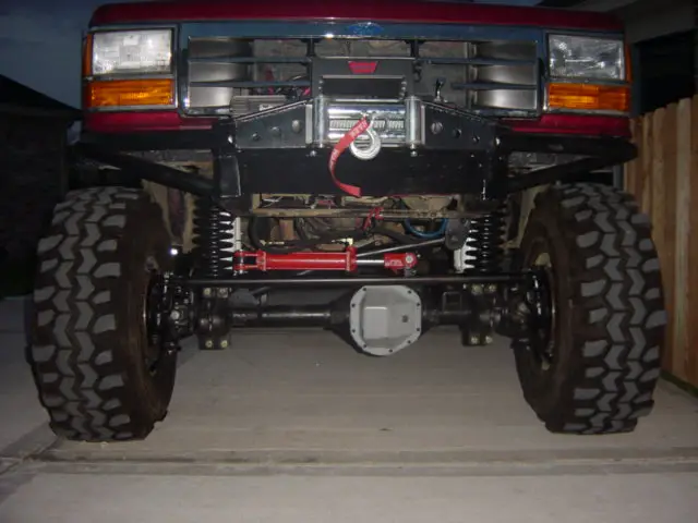

It's home. No real pics yet. I'll work on getting those tomorrow. It drives suprisingly well for full hydraulic steering, a little twitchy but I'll get used to it. Now for a teaser :D

That looks awesome Micheal! Congrats.
That is a very sweet bumper. What winch did you go with, you didn't have it at Tellico did you?
One more thing. Is the front diff normally that far toward the center or is that just because of the setup on the EBs?

That is how the Axles are on the EB. Michaels axle was not cut down at all, it is stock EB width.
