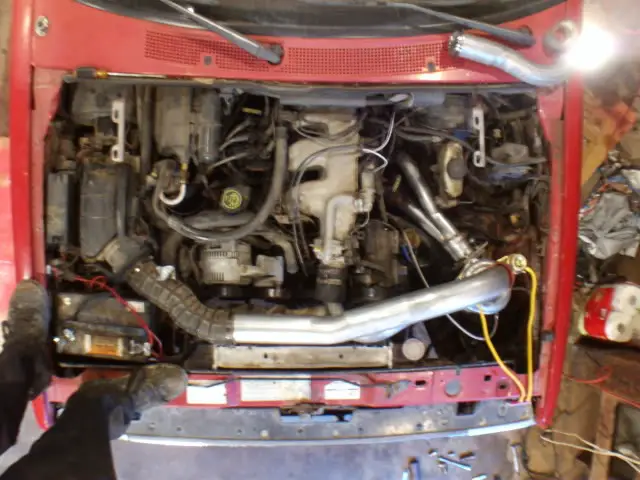

Alright, i turned cut off the exhaust just past the manifolds, and flipped the drivers side manifold up-side down a few days ago, and today made the piping (and a Y collector) into the flange for the turbo, and made up some pieces for the air to the MAF, throttle body etc. I haven't taken any pictures yet but i'll take my camera out there with me on wednesday (or next weekend) when i can do some more work, and take some pics.

Alright since this is turning into a build thread, here are the pics as promised.
from the front, and yes.. i'm going to have to "modify" the hood some.
from the side
here's the collector/turbo flange with the bung for the O2 sensor
from the passenger side
here's the crossover pipe (view from the bottom) i tried to keep it under the oil pan so that when i blow the engine it is easily removed for rebuilding (and modifying) the turbo piping and manifolds should be able to stay in one piece on the engine when it comes out.
and here's a view straight down from the top

well today i did some test driving of it, for the first time. i let it run up to about 10psi, but it didn't run good at all. as soon as the boost starts to hit and/or the rpm's are above about 2500, it starts to run rough and crappy and seems pretty gutless. so i'm not sure the reason here. anybody have any ideas on that? i read a thread on here where someone else boosted a 4.0ohv upto about 7 or 8 psi and it worked fine with everything else stock (and i think he was even open loop, i've even got the o2 sensor hooked up, although it's the stock warn out one)

dont know alot about turbos, but i bet the fuel map will be off.

there's a fuel map with MAF?
10psi with everything stock- im betting it was running very lean.
it was definitely running lean. it started sounding lean as soon as it hit about 2 psi (as soon as the turbo spooled) my question is how to make it run richer as the boost comes on. it seems that if i just did huge injectors, it would be running too rich all the time, except when the boost was on etc.
i think you will need a chip to tune it. and get the timing right.
where can i get a chip?
Could be the maf was pegged. The stock injectors probably didn't help.
would it be possible for 2psi of boost at 2500rpm to peg the MAF? i dont know for sure but it seemed unlikely i don't know. i'm going to try it open loop tomorrow.

and i think you could call jet chips (think thats the name) and ask them.
